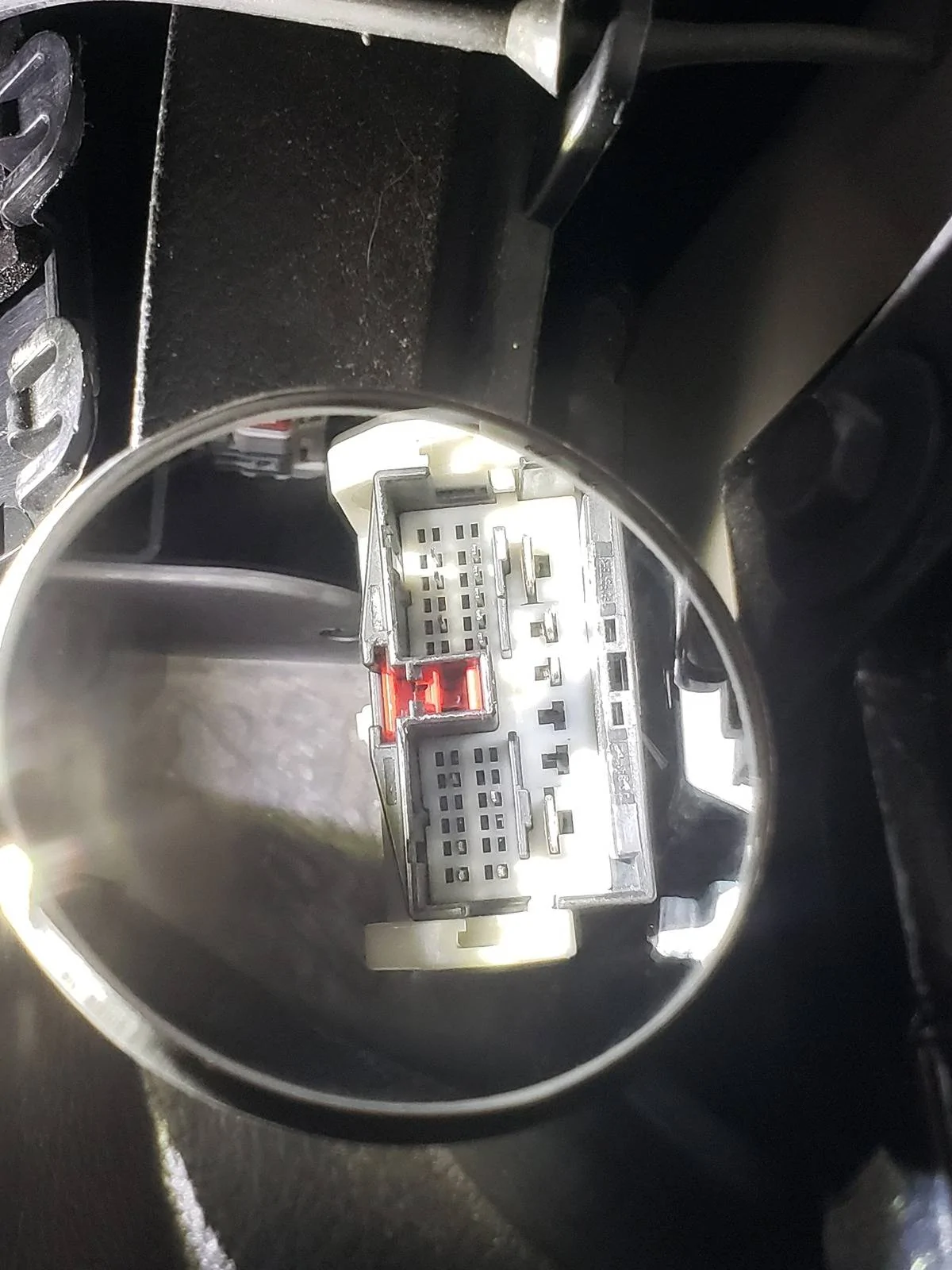

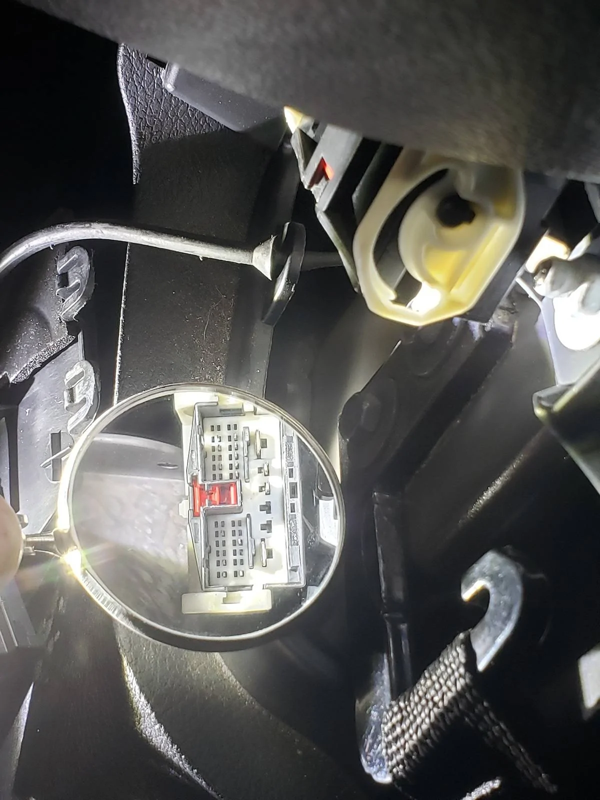

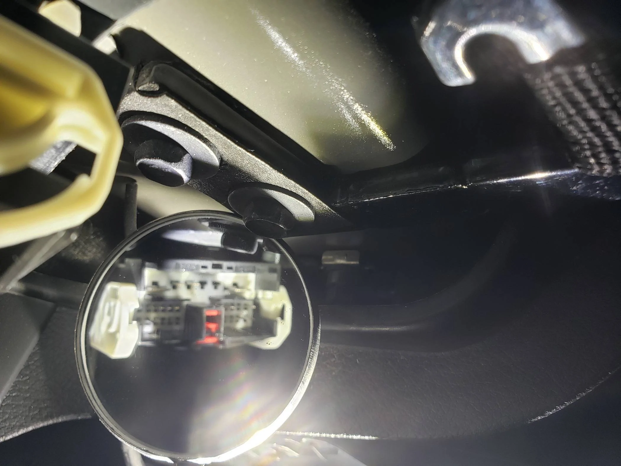

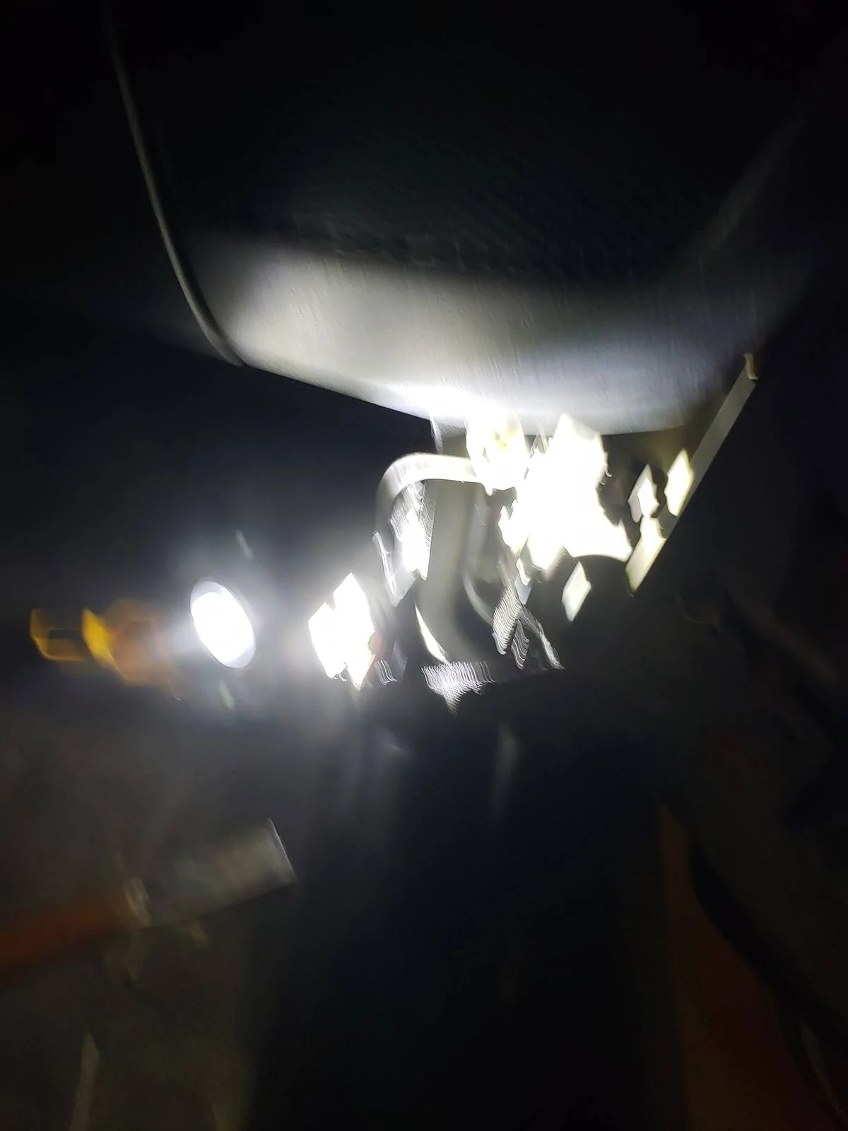

Why didn't they just use the JKU electronical door plugs?
These are crazy finicky... okay, actually dreadful to deal with.
Jeep Gladiator Door lock button not working 20240425_210511
Jeep Gladiator Door lock button not working 20240425_210506
Jeep Gladiator Door lock button not working 20240425_210354
Jeep Gladiator Door lock button not working 20240425_210517

Thanks for this! My lock stopped working and It didn't even cross my mind that I'd recently had my doors off. Unplug and replug the harness and it's fixed!
