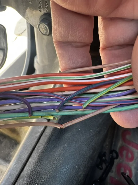

My door proximity and lock button on the handle quit working. Thanks to you all I checked the harness where it wraps around the door jam that’s covered in the cloth sleeving. I found two broken wires. Fixed them but my lock button on the handle doesn’t work still. Anyone know what wire controls that?
I’ve been putting off this fix for too long and this picture helped. Before I slid the sleeve off, I lightly pulled the green one in the picture and wouldn’t you know, it came right out. lol
so off with the door panel, pulled the sleeve up and I find two more friends disconnected or nearly disconnecting from themselves. So I spliced them back, and now everything works.
