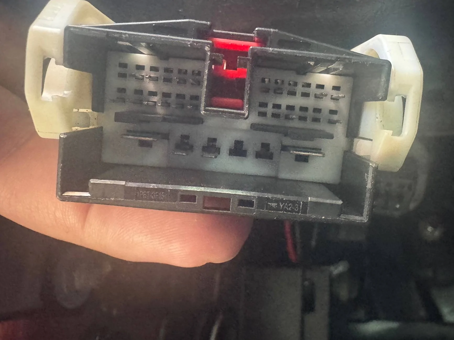

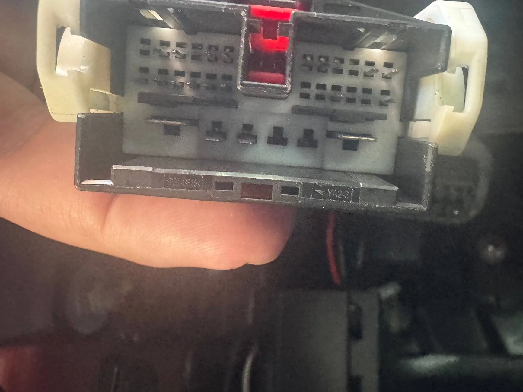

Recently all the controls on my drivers door stopped working. The power lock switch and mirror switch. The door still unlock if I use the passenger button and the window still functions fine. I checked fuses F28,F96 and F97 all fine. I also looked at the pins in the connector and nothing looked bent. My last resort was to expose the wires in the door harness and everything looked fine from what i could see. Anybody have any suggestions?

If you had the doors off, I would suspect the connector pins are bent. If you hadn't had the doors off , then I would suspect the harness that you have already looked at. Now that you pulled the connector apart to look for bent pins, you could now have bent pins. You really need to look close. Take a picture of both receptacles so that you can look even closer.

Ill have to do the picture method tm. i have the doors off a bunch in the warmer months.

Theres a picture of the connector. Nothing looks bent to me but maybe you guys see something i dont.
Jeep Gladiator Drivers side door Controls. IMG_1451
Jeep Gladiator Drivers side door Controls. IMG_1452

9 times out of 10 it's the bent door pins, but with the opening and closing of the door it can cause the door harness wires themselves to break over time. You can check continuity on either side of the door harness and see if you have a break somewhere
With all the controls not working, i'd look to the main power and ground wires on the harness first.
