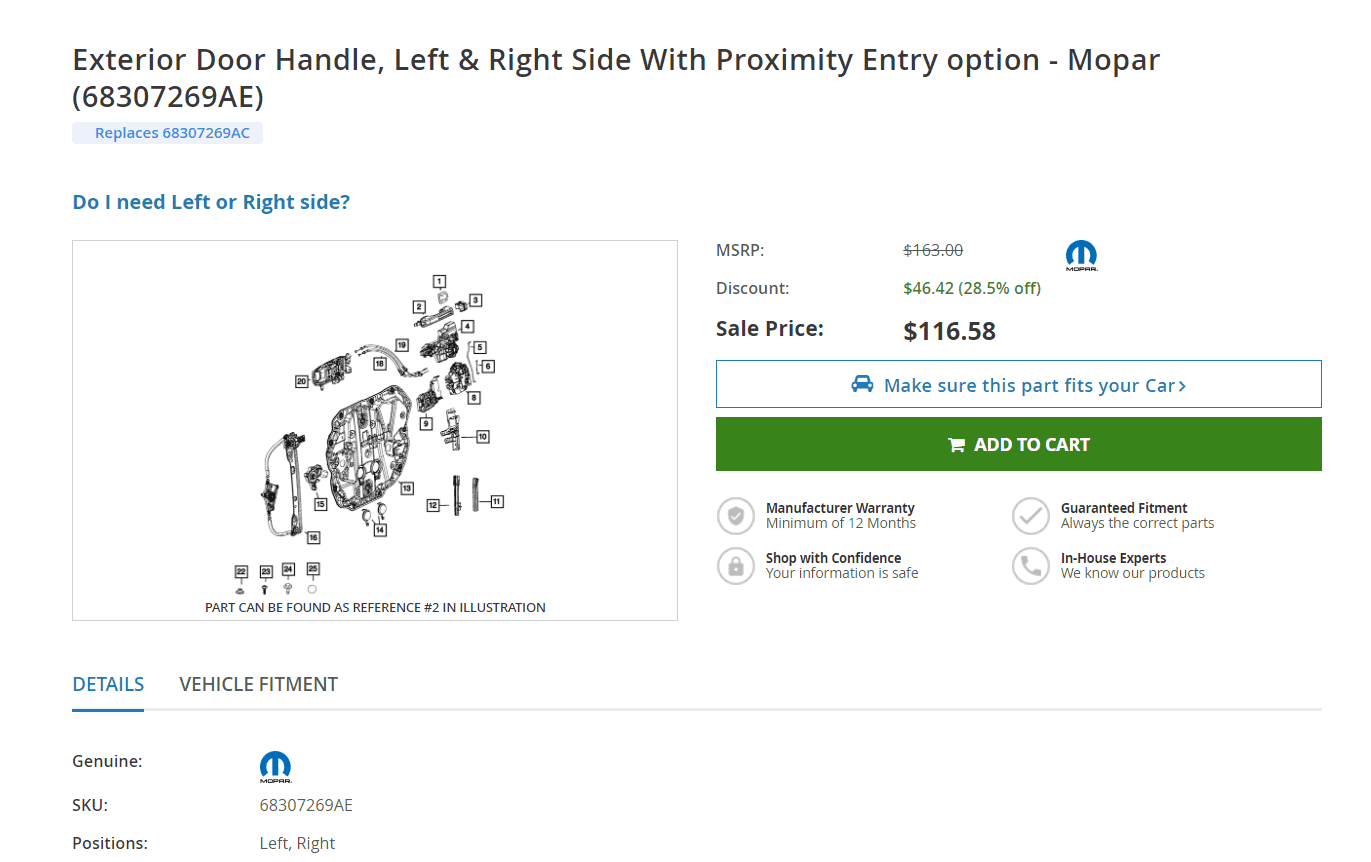

They're not the same. Does the door lock and unlock properly with the fob?

Sounds like two issues.
If a working handle was moved, then did not work, but you put it back and it worked again, the handle is ok. That suggests that handle is ok.
Have you flipped the magnets in the caps (I think that's right - there was an issue I seem to recall where there was a small problem with those)
Yeah, they are...........
Caps and handles the same -
Jeep Gladiator Drivers door handle proximity function not working 1689796006033
Jeep Gladiator Drivers door handle proximity function not working 1689795072451

I must have misread. I thought he said he swapped driver/passenger (front/rear) handles on the same side.
Then he'd have a definite issue - nothing to plug into.
I can't say if front and rear are the same - likely not, for sure not with passive/proximity handles, just that LF and RF are the same - been there, done that.
I suspect he's got the old magnet issue (man, I wish I had a memory) or pins out of whack or something. Makes no sense yet.
Many people have done troubleshooting by moving handles straight across, LF to RF and RF to LF and found the problem that way. If it follows the handle, it's the handle, for example.
But then - you're a clever guy and knew that already.
