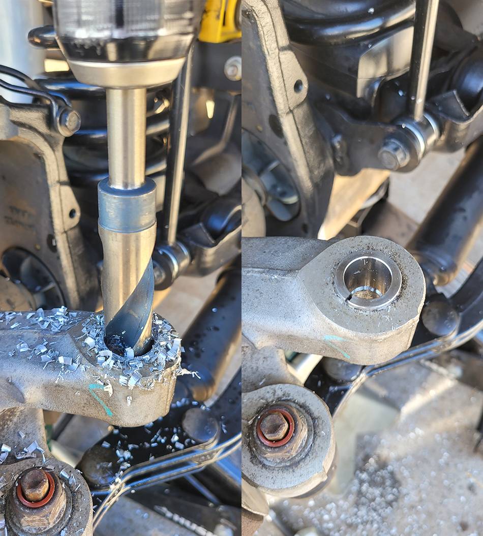

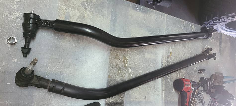

I ended up drilling the knuckle and adding the RC flipped DL and TB bracket yesterday and everything went smooth. Here is the RC flip DL (top) compared to stock DL (bottom), its basically the same thing just with the rod end on top and a zerk fitting:
Jeep Gladiator Drilling Knuckles drilled-knuckle4
I used the DEWALT black oxide, reduced shank, drill bit and I am not exaggerating, it took less than 5 minutes to drill that knuckle 😳

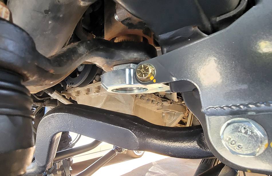

The RC TB clears the Synergy brace bearing pretty well. If it wouldn't have cleared, I was just going to remove it and leave the brace, but its all is good:

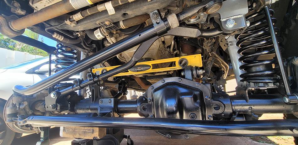

Here's a shot of the DL and TB parallel with a WAY better angle. Took it for a test drive and steering feels like I don't even have a 6.5" lift and 40's - pretty amazing for an affordable RC part.
I’m sure you didn’t, but don’t forget to add to your bump stops to prevent your drag link from hitting the frame.

The aluminum ones I hear aren't bad the steel ones on the Mojave are the ones a few people have broke bits on( really cause they try going to fast .)
I swapped in the Mojave knuckles on my rubicon to prevent them from breaking. The aluminum ones were featherweight in comparison.
I looked the price of the steel knuckles wasn't outrageous but ,I'm willing to chance it.
