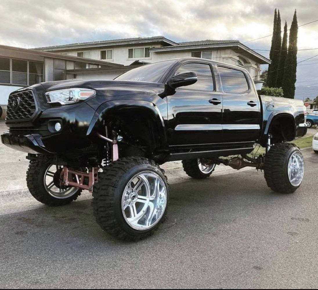

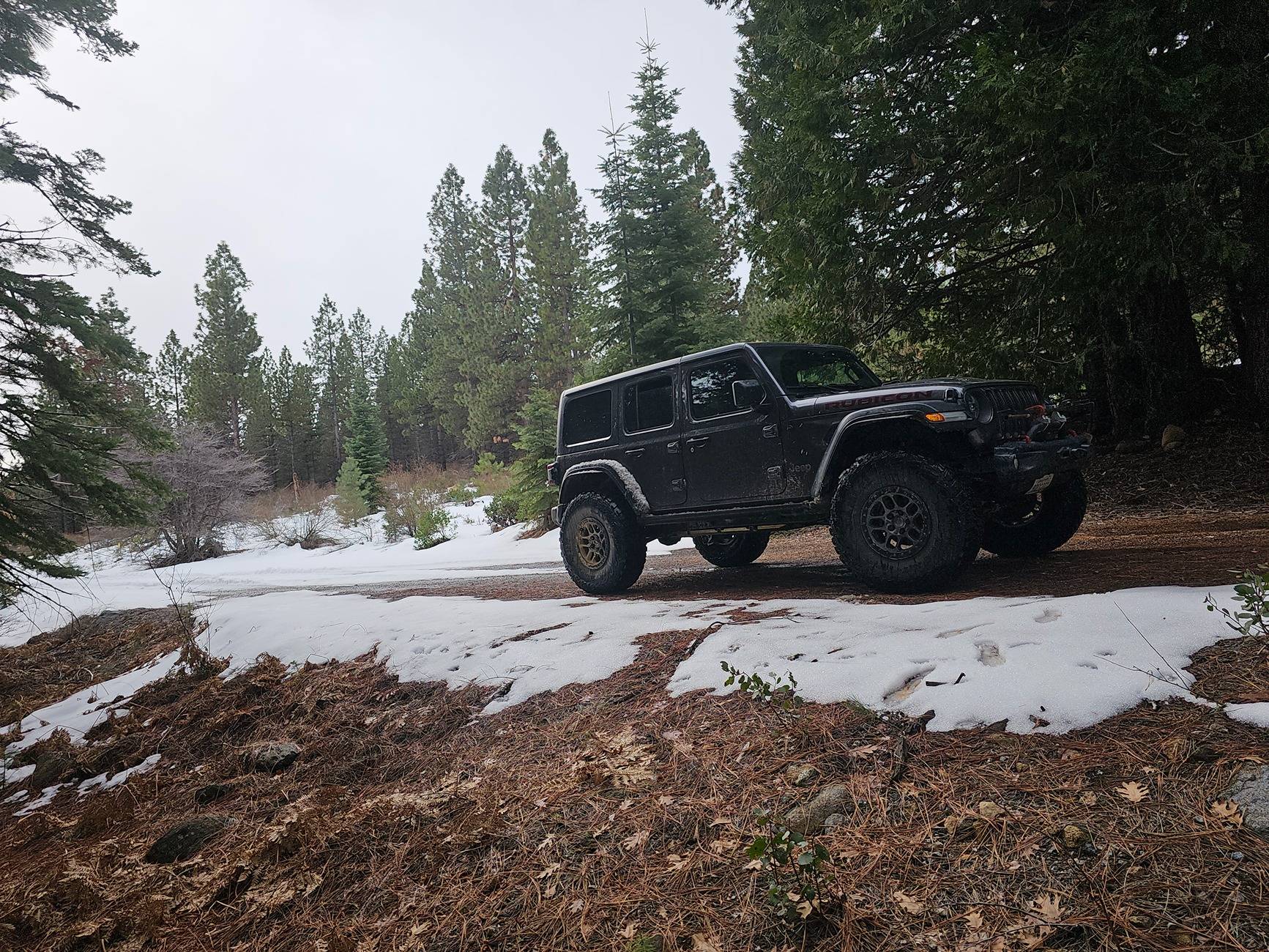

Some people like the massive lift, body above the tires look. I noticed that was really popular in Hawaii. All the lifted tacomas I saw over there had 3x the lift they needed to clear the 33s they were running. I prefer the just enough lift to clear the tires and still flex look. Function over form. Both the JLUR and the JT run 3.5" lift and 39s or 37s. I think the Hawaii tacoma looks dumb, probably rides like crap, and is pretty well useless.

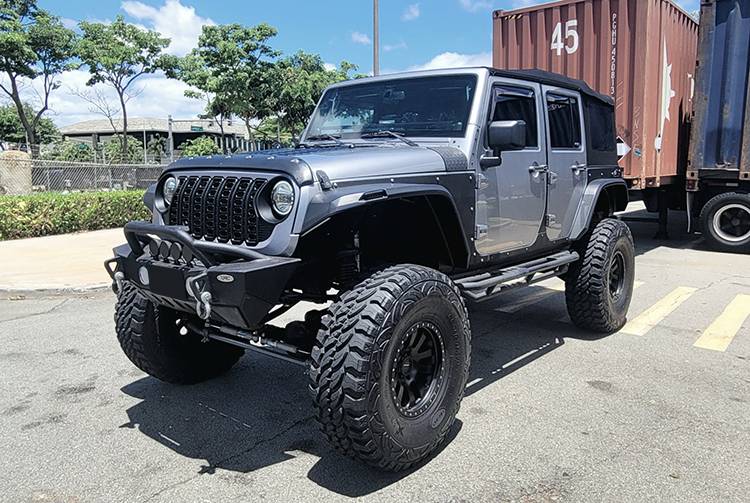

You are absolutely correct! But I never got into the super wide rims thing :LOL: I did ended up selling the 37s and added 40's that filled it up nicely...well sort of lol
