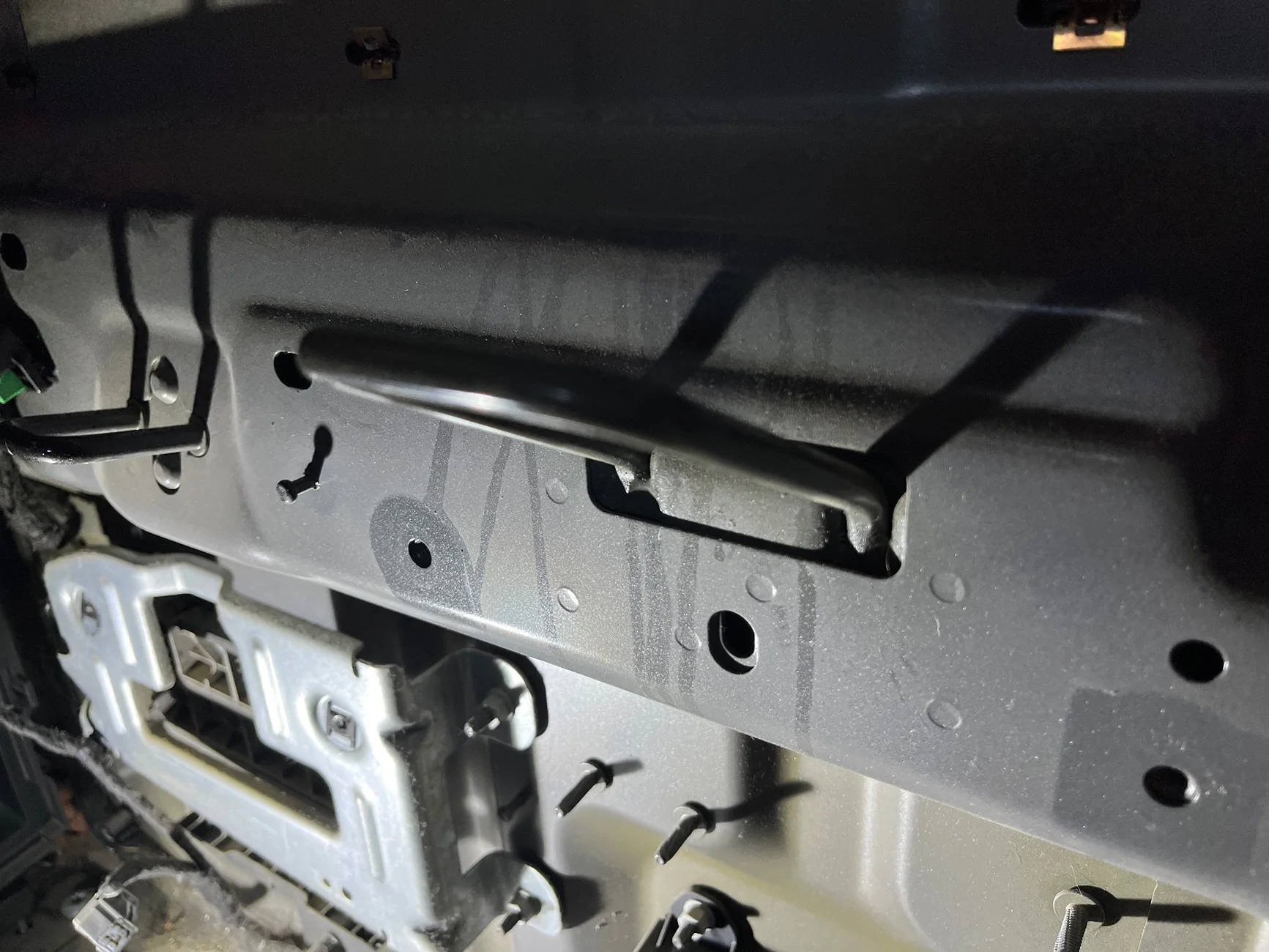

(21 JTR 3.6, 131k kms) I’m thinking I have a locker communication issue (locker sensors have been potted in 21, they work) that all indicators (off road pages, dash locker symbol) shows lockers engaged when they clearly aren’t.
Was reading on here, that a Mojave owner experienced a communication issue for his/her locker that was linked to the DTCM (drivetrain control module) and that repair showed corrosion at the DTCM connectors.
I’ve had the leaky rear window before and did the 7mm silicone vacuum hose fix, but… made me think corrosion at the DTCM could be a viable reason for my locker issue.
So, here we are with today’s task of taking off the rear panel and I’ve got it all pulled away and flapping except for the very top clips. I ended up cracking the panel in a couple places so that made me feel like a full fledged tech attempting this task.
How do I get the top row to let go without becoming the HULK and just tearing the thing out?!

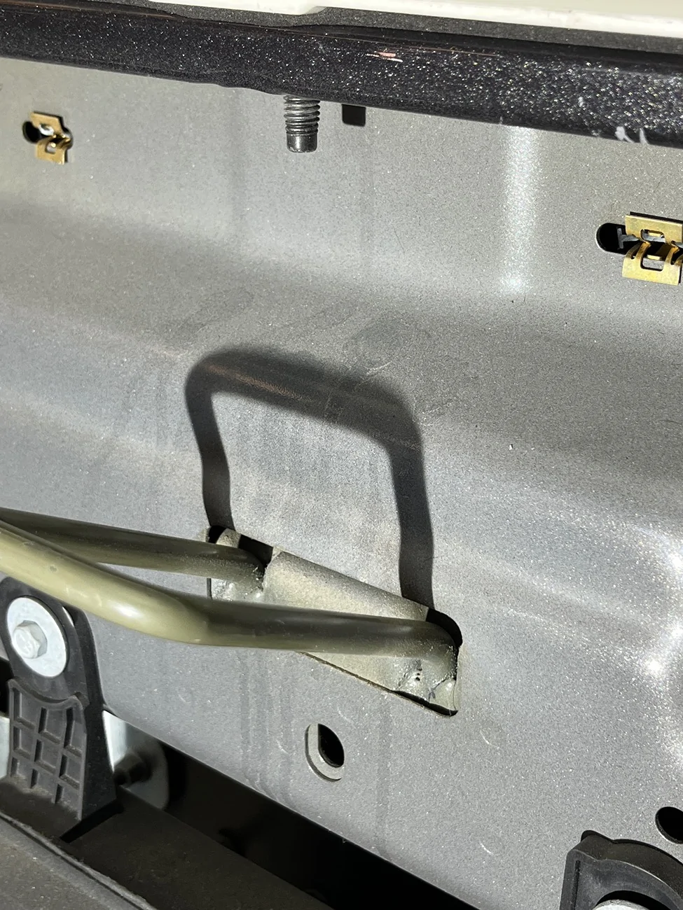

There are 4-5 risers or 'towers' from the rear panel to the mating holes in the rear bulkhead. I think I broke 3 of them off completely. I could not find a way other than hulking out and breaking some.
I assume the rear seats are completely out? If you can sneak an arm up under the panel with a trim panel fork tool, some extra prying pressure from behind might help

Yup, you’re right and the seats are out too. Got a hook tool to slide up along side of the pins and tugged straight out. Snapped them all and broke the panel in another place. Oh well, there’s upgrades for that panel that are ALUMINUM!

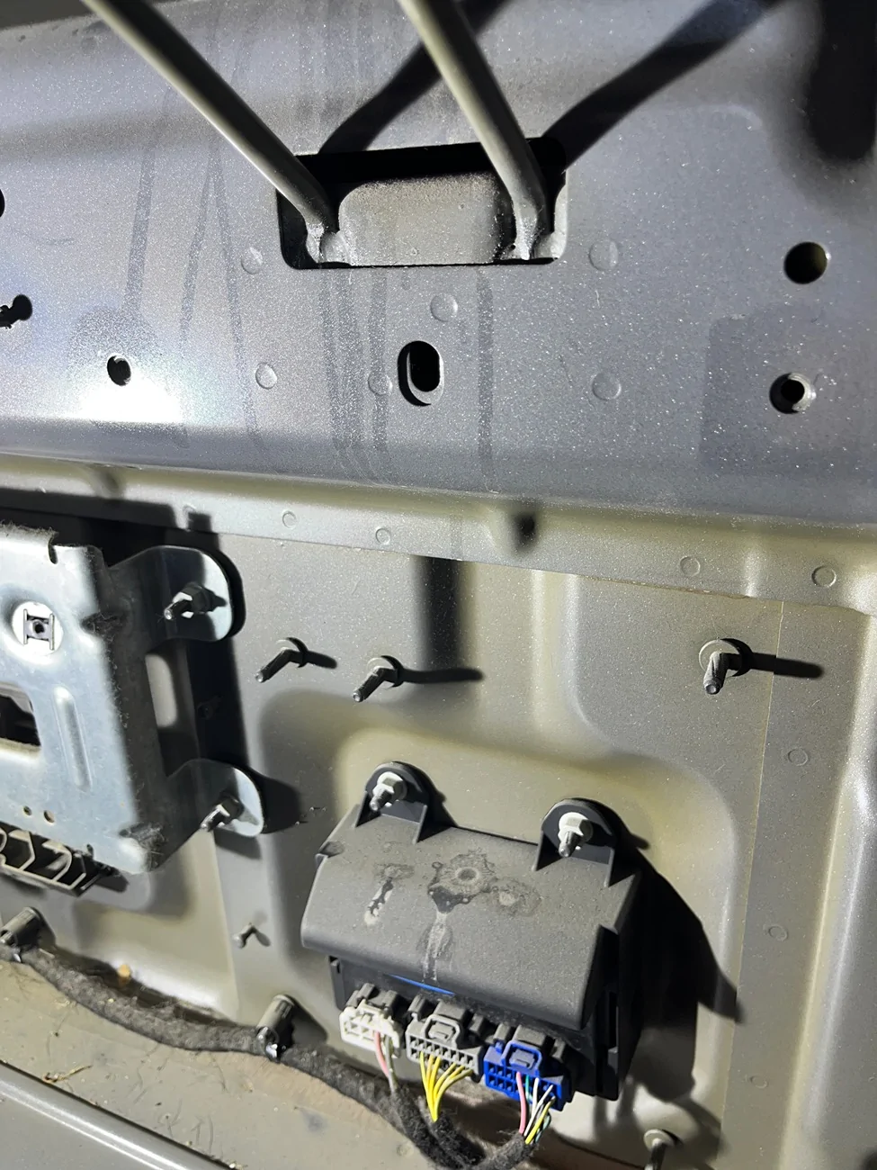

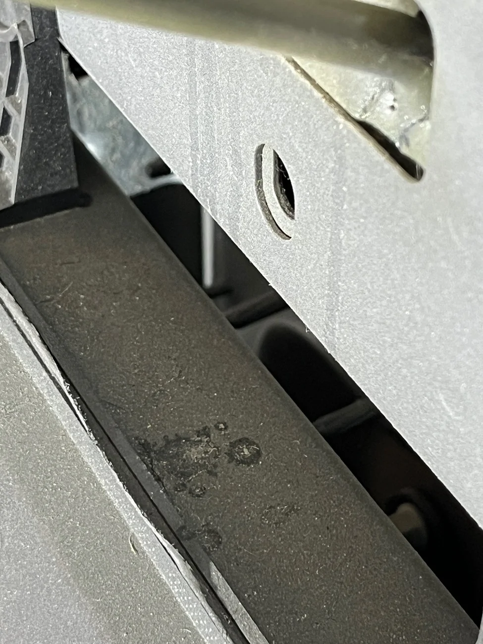

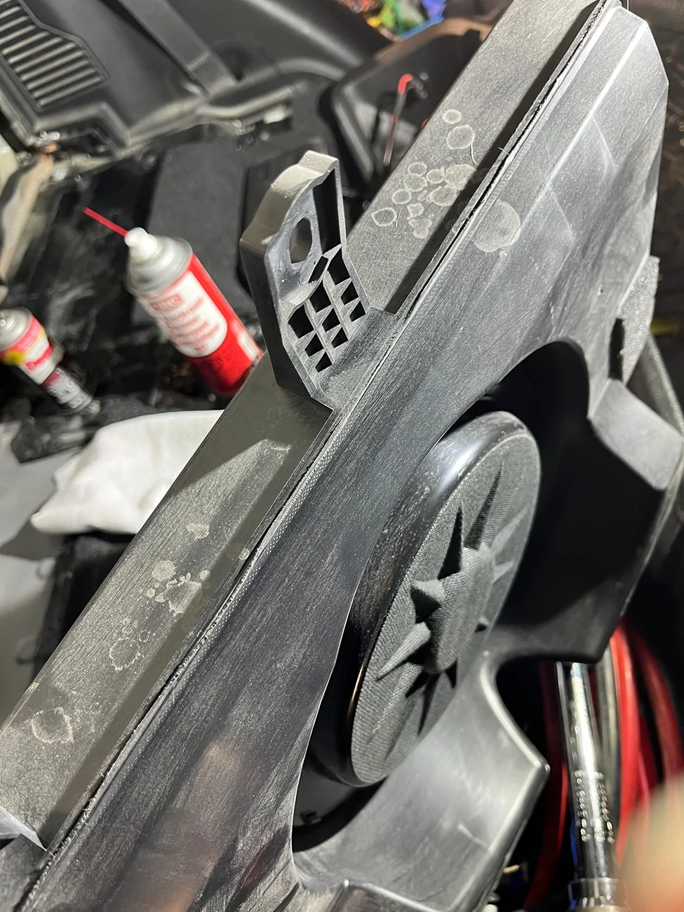

I’ll keep updating as I go here….

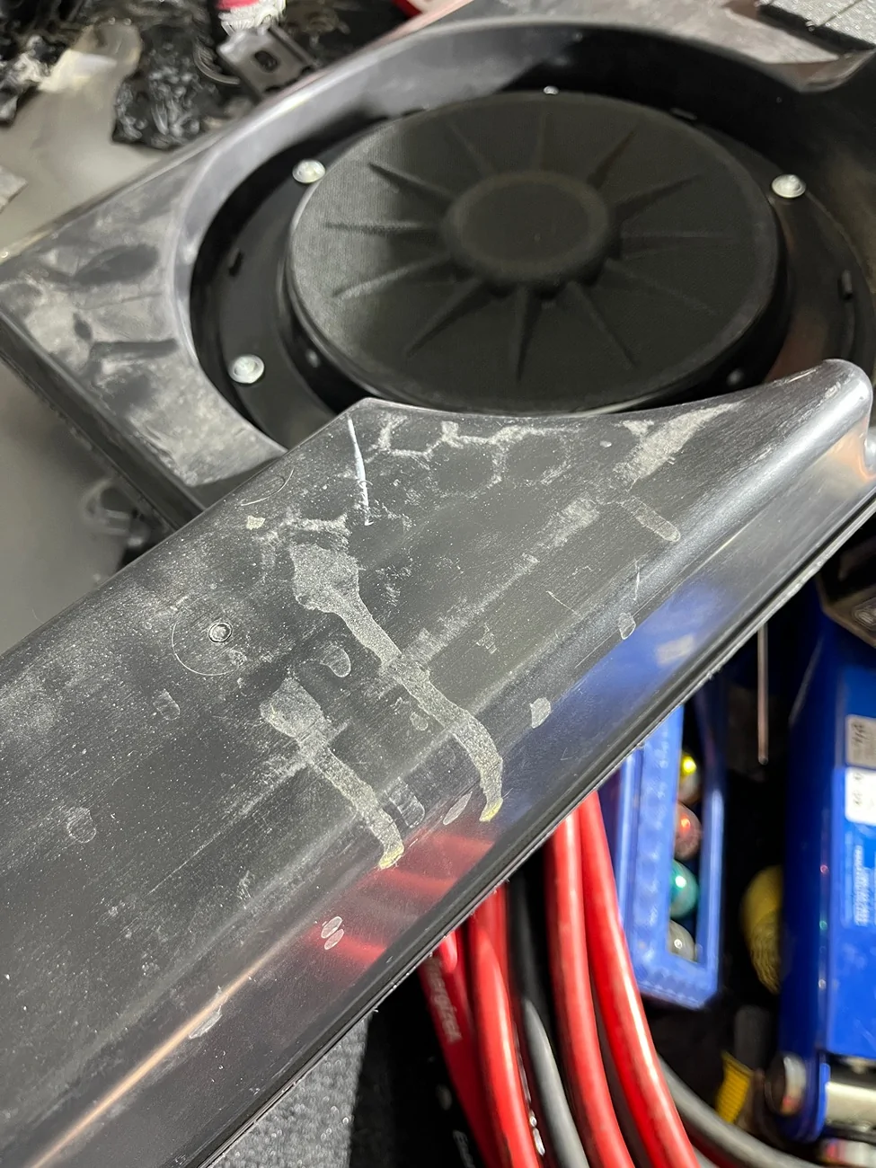

Water drips and flow down the wall is evident in the dust on the wall. Drips landed on the woofer and ran down behind the woofer. INTERESTING
Jeep Gladiator DTCM Access/Back Wall Panel Removal…help IMG_5257
Jeep Gladiator DTCM Access/Back Wall Panel Removal…help IMG_5256

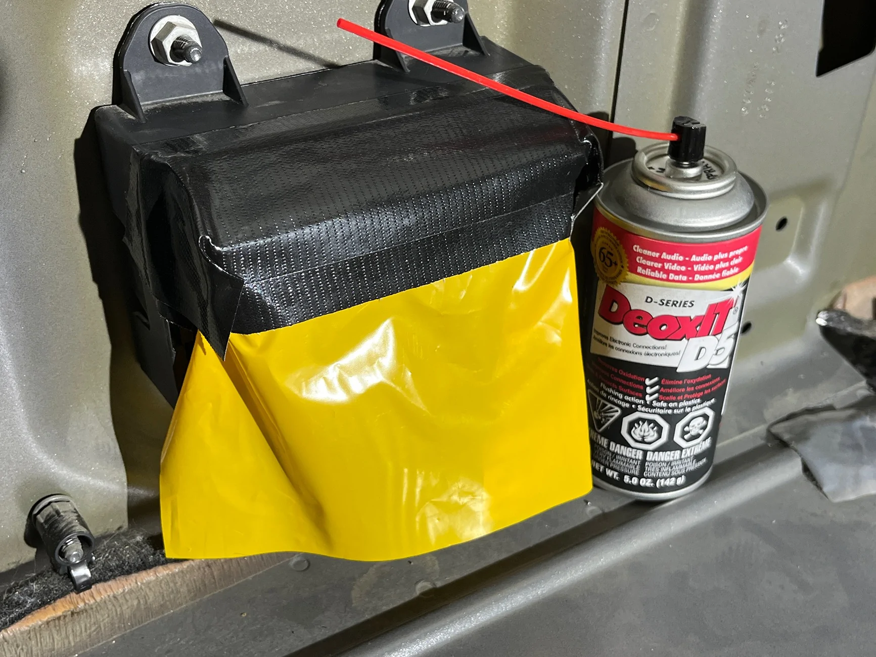

I didn’t see any pin corrosion but cleaned the pins, and sprayed them with it DeoxIT D5. Taped a poly shield on it in case there’s future drips.

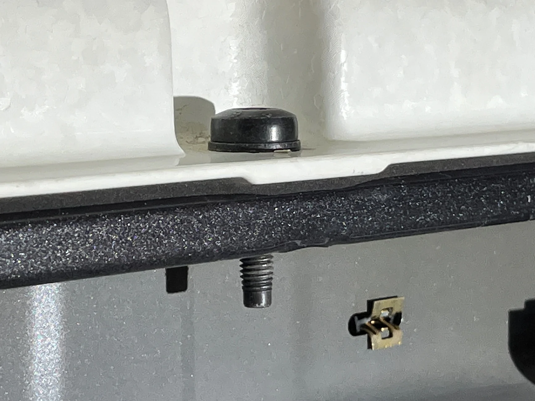

I’ve not had any window leak since installing the 7mm silicone vacuum line around the glass but… it’s very possible water was getting in from the cap seal. The cap screws were loose so they got a quarter turn tighter

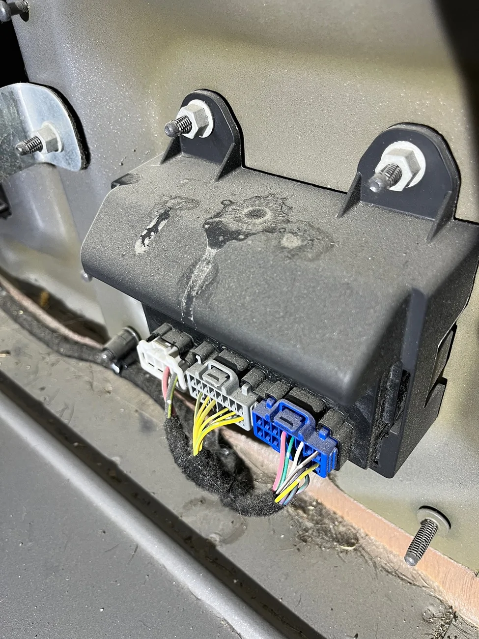

Asked Ai what both these modules are that are directly behind the sub woofer and to the side of the woofer. Ai is saying the module right behind is the alpine system module and the one to the side is the DTCM.
The drips don’t show making contact with the DTCM but as you see above in my other photos, the alpine module was getting dripped on.
I did take the connectors out of the DTCM and cleaned them off and gave them some DeoxIT. Now I put it together and hook up the diagnostic tool and reset it.
