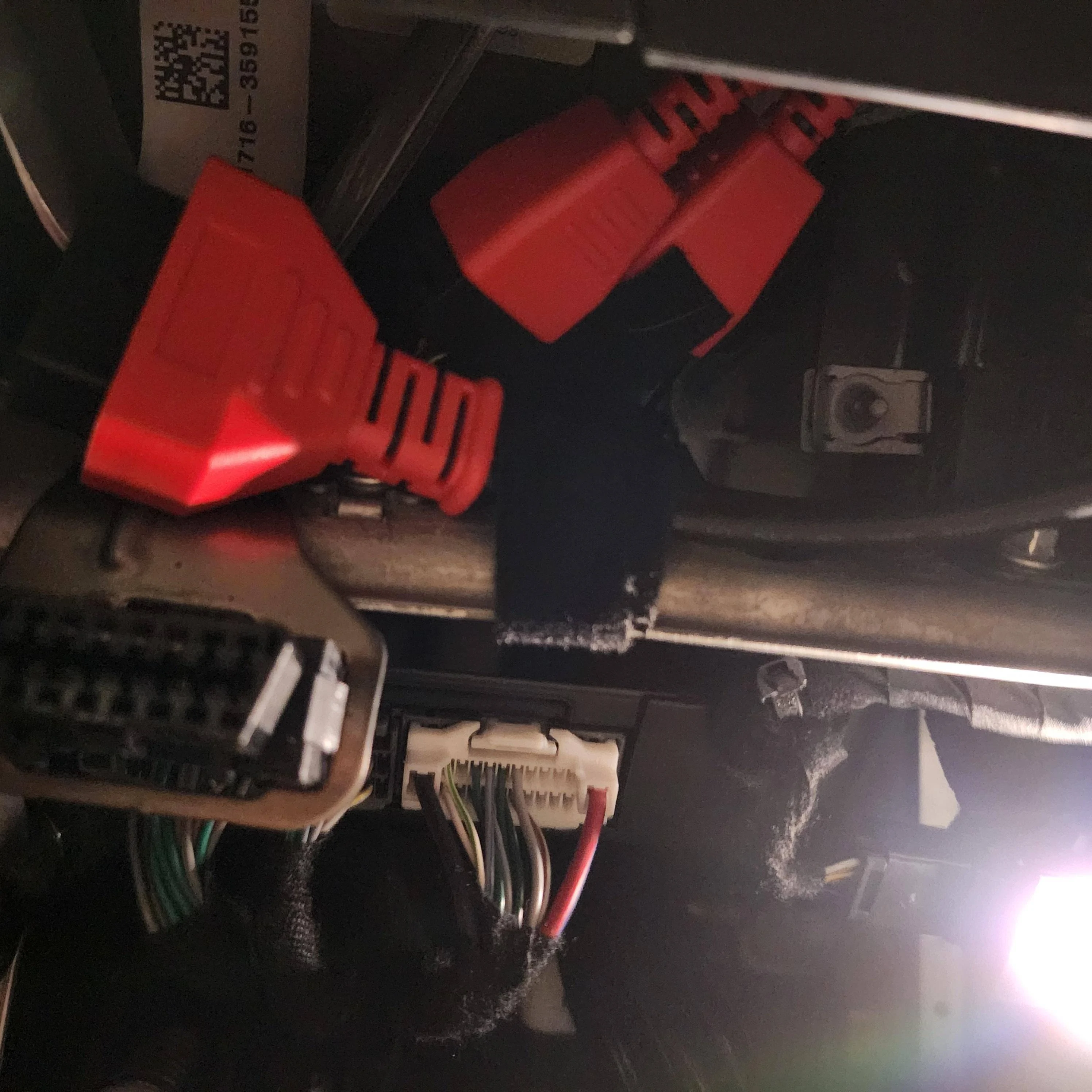

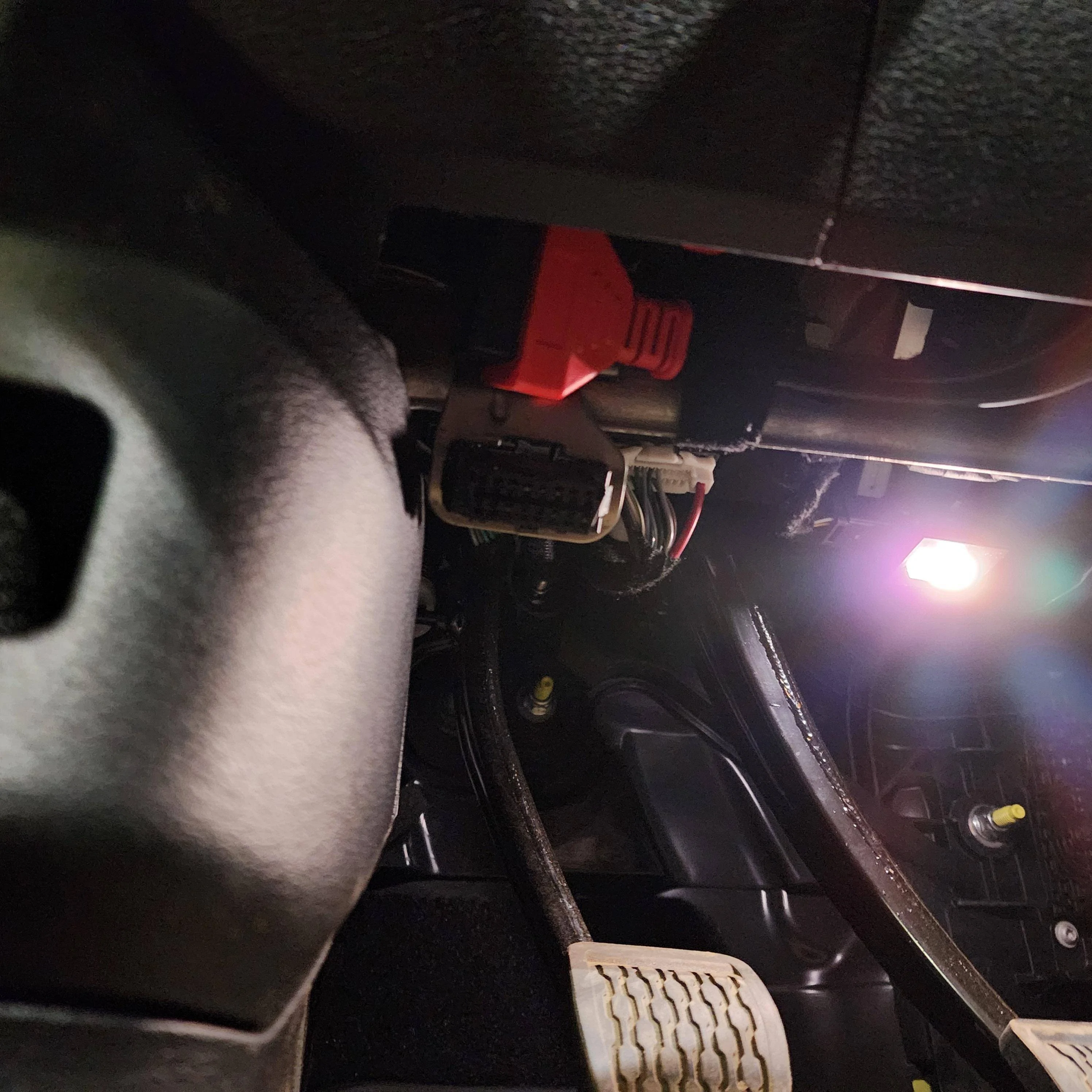

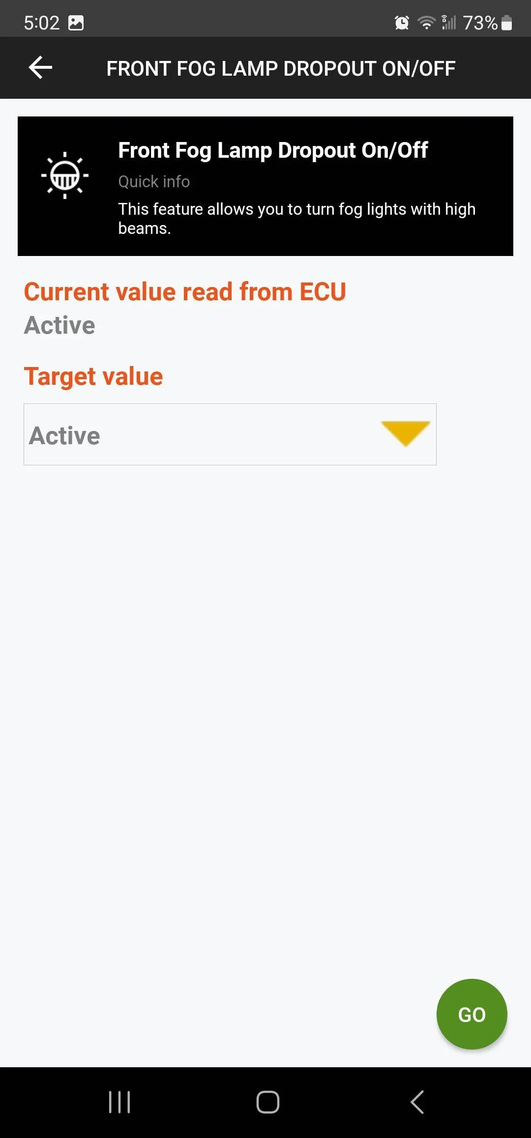

Jumped into Jscan!! Tweaked a bunch of stuff!
Hood alarm and "Bambi mode" were the top two. Seatbelt warning off (I drive on road with belt on, but casual offroad I dont ), I forget what else I did, lmfao. Super easy to do, very happy with it!

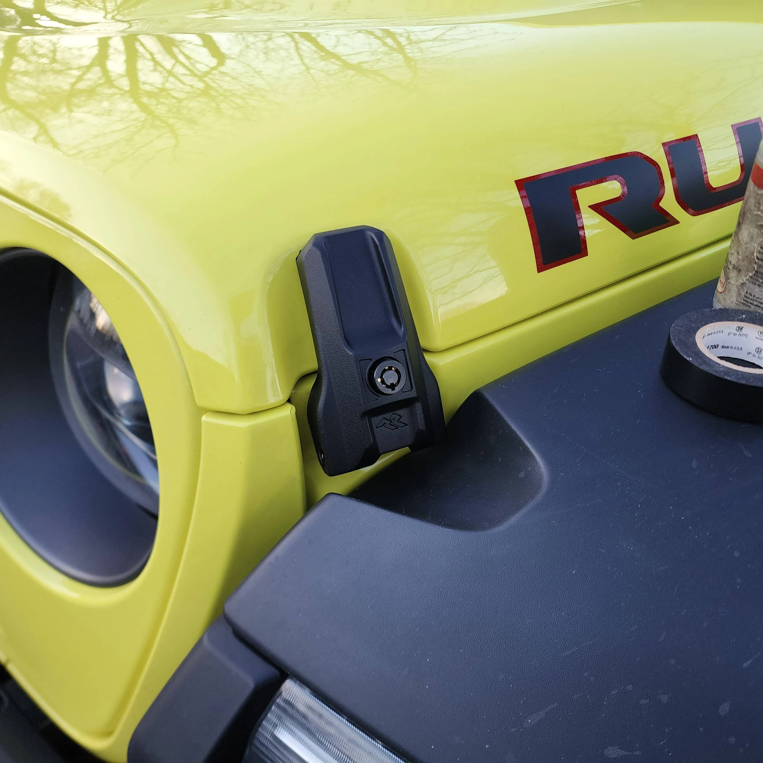

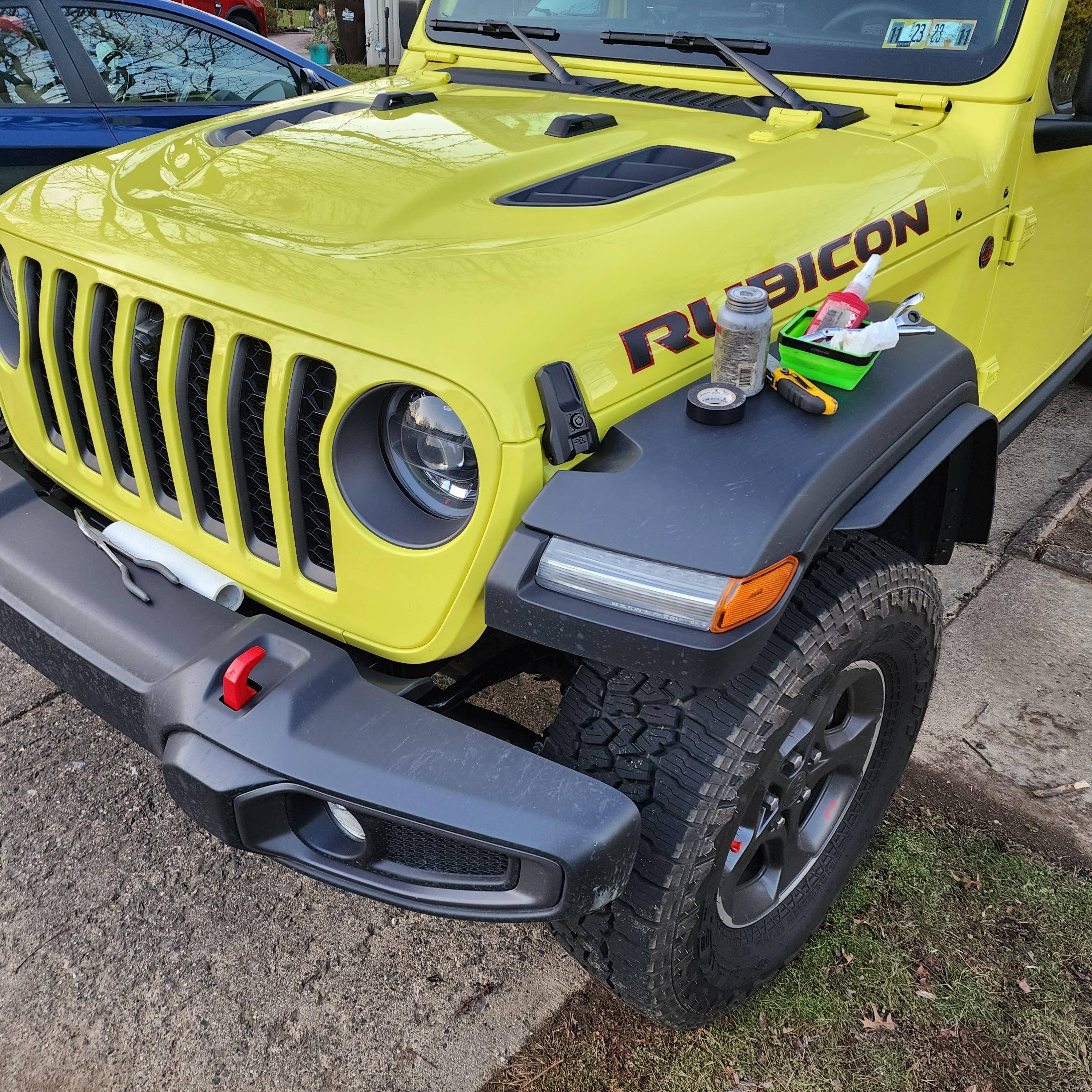

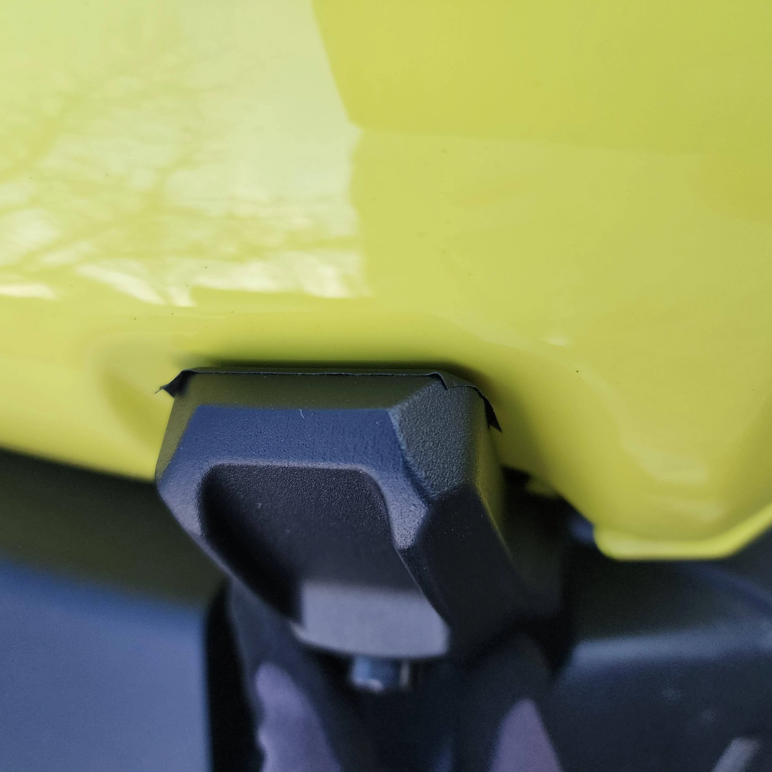

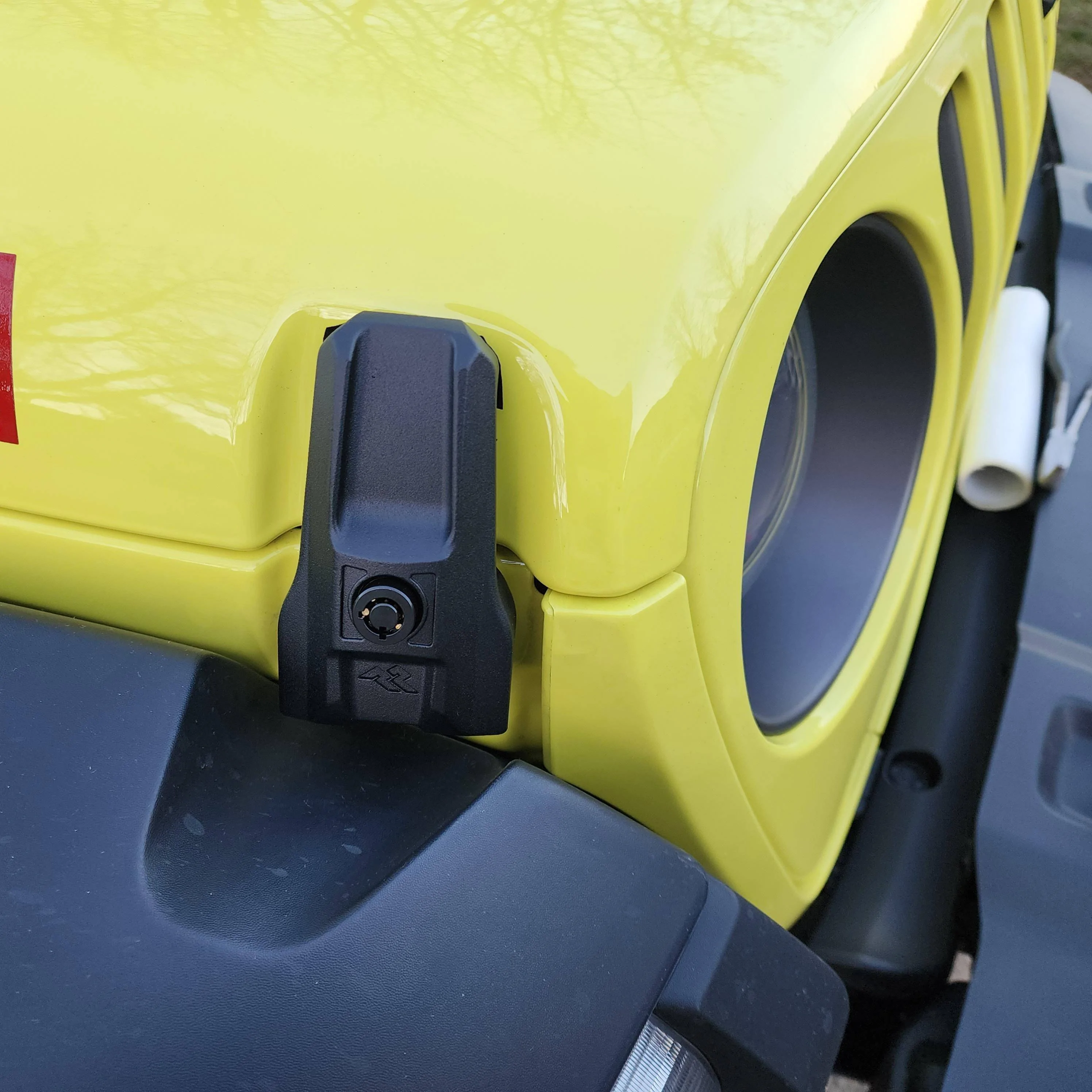

MOAR SECURITY!!!
Rugged Ridge locking hood latches!!!
Also, I jammed a lil electrical tape on the top ends, when you go to pivot the clamp down, it touches the hood. I'm going to put some clear PPF here soon enough.
Overall, pretty sweet.

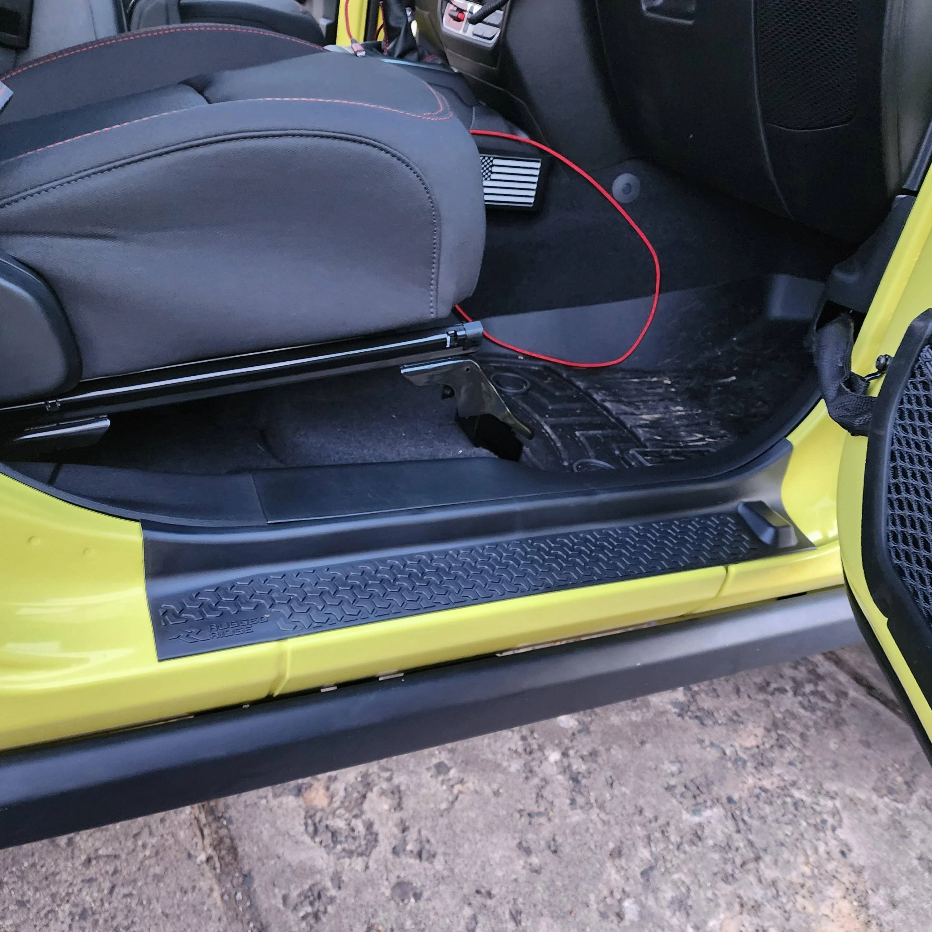

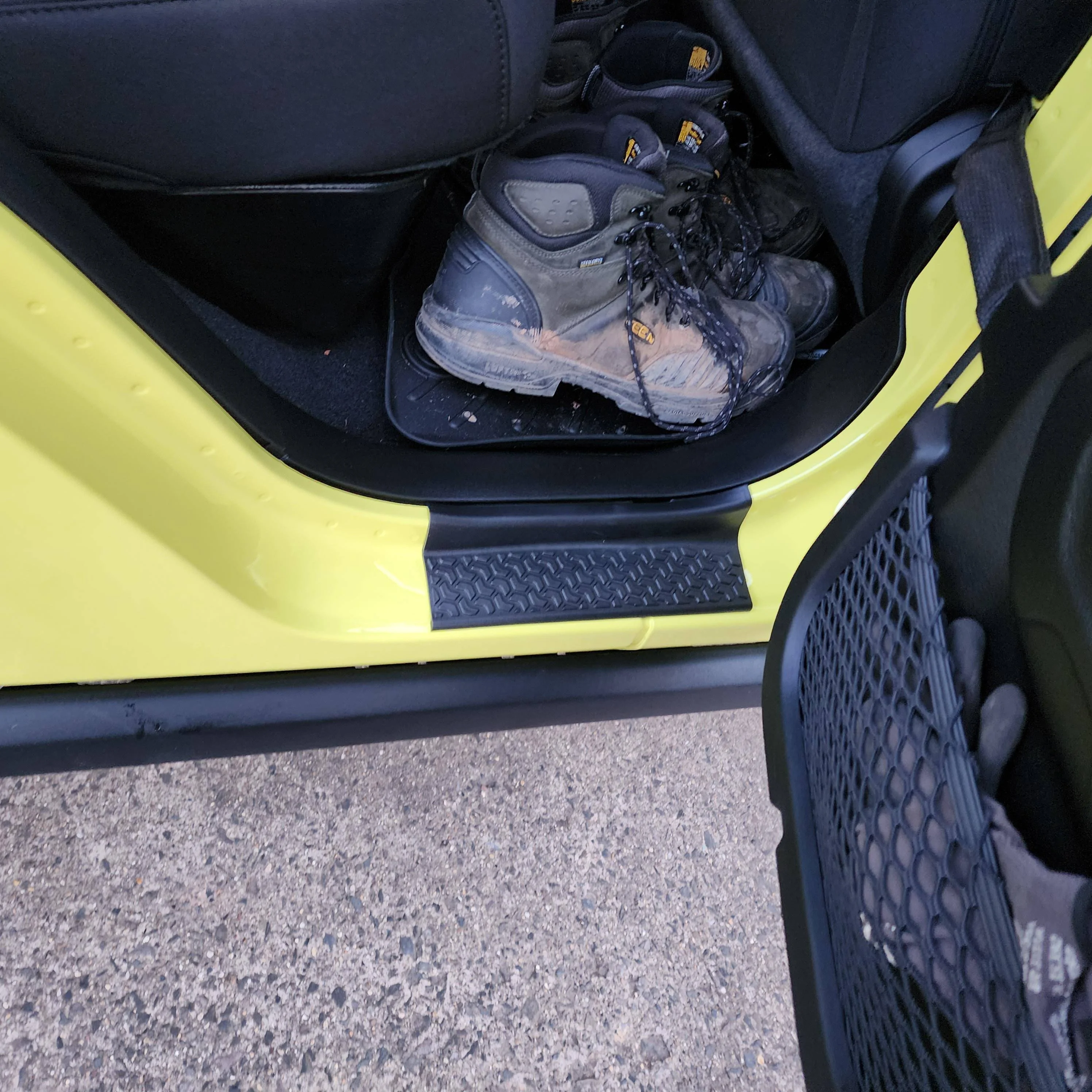

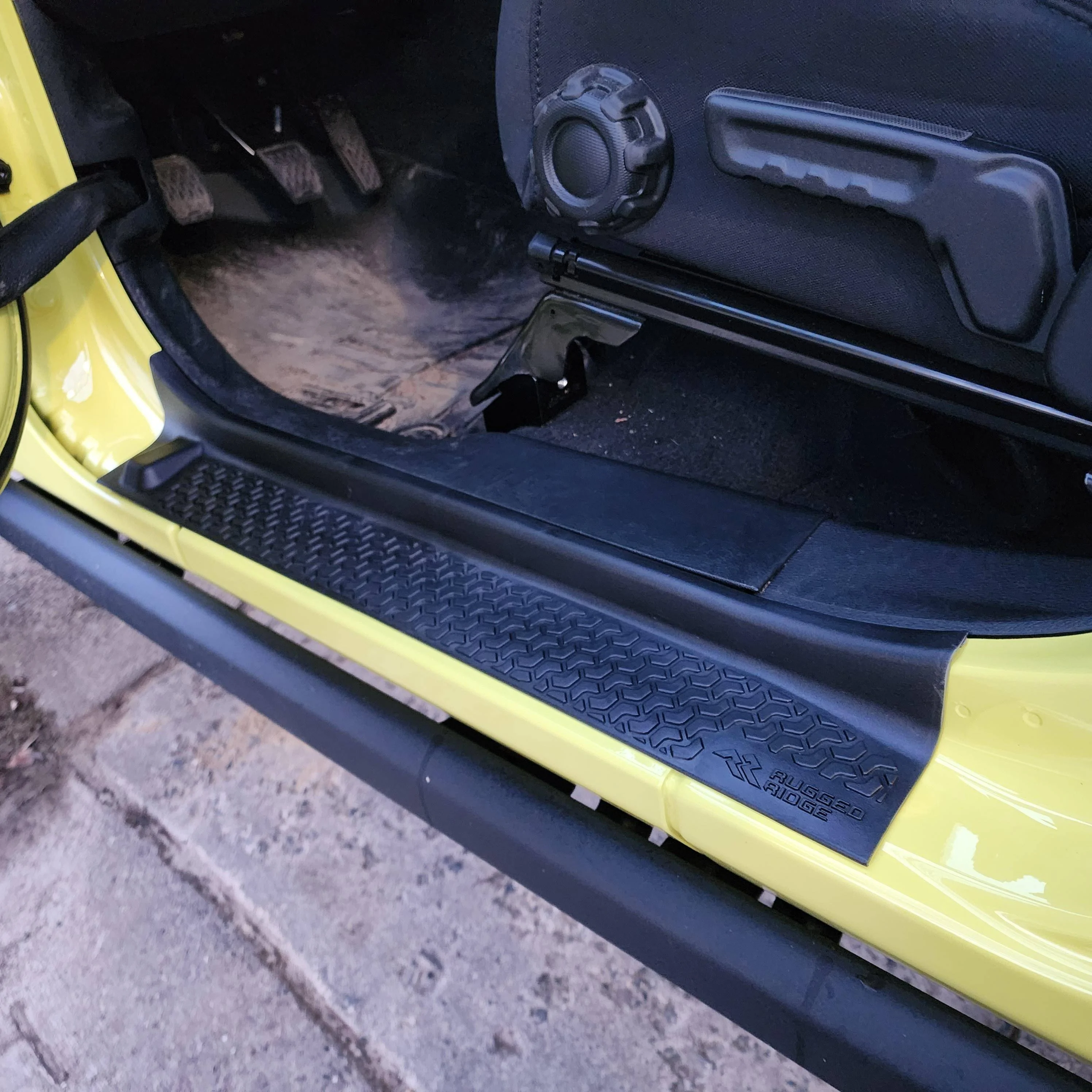

Rugged ridge door sill protectors. Fitment was OK, not perfect, but Im not angry about it either, lol
Simple install. Best coverage I could find in a protector set.

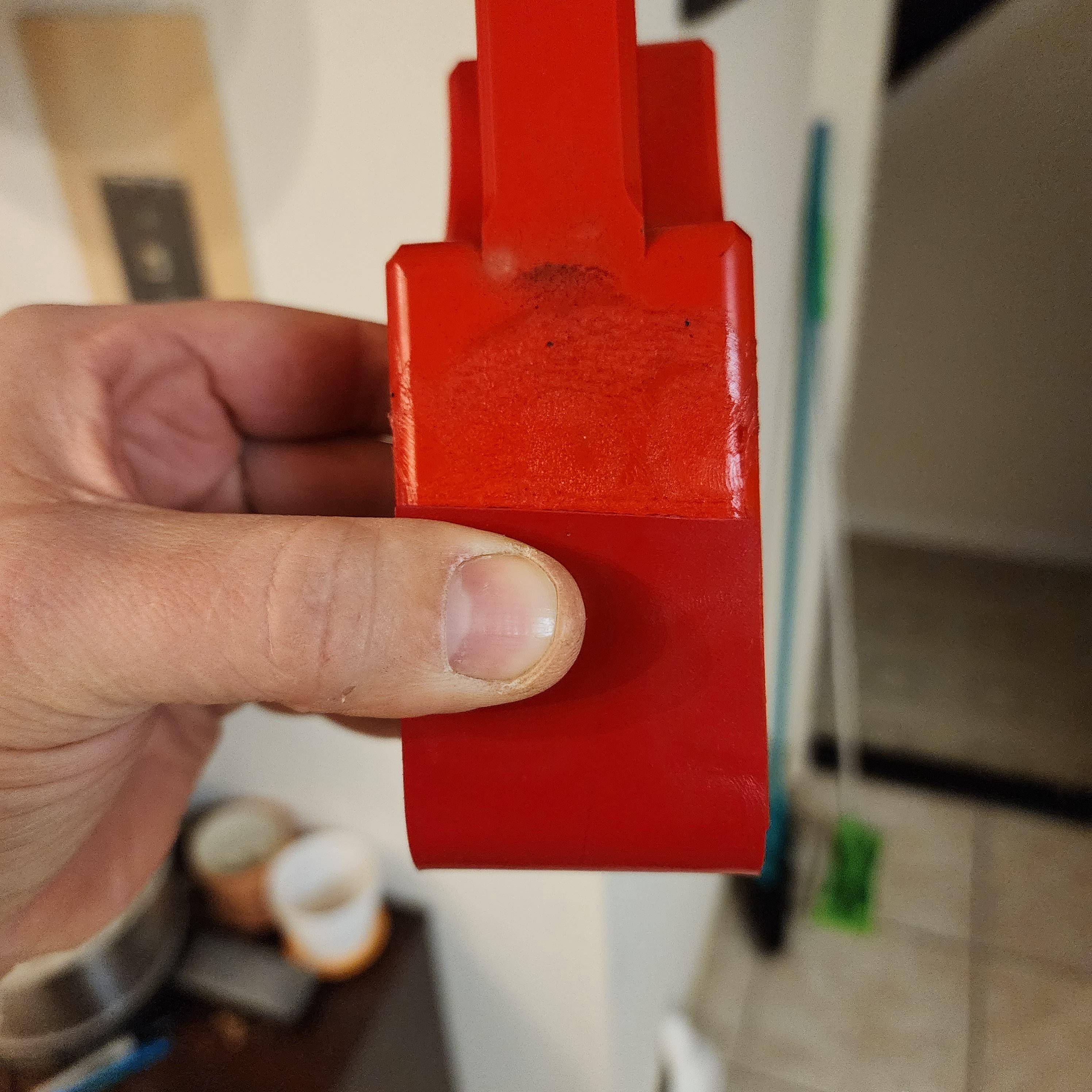

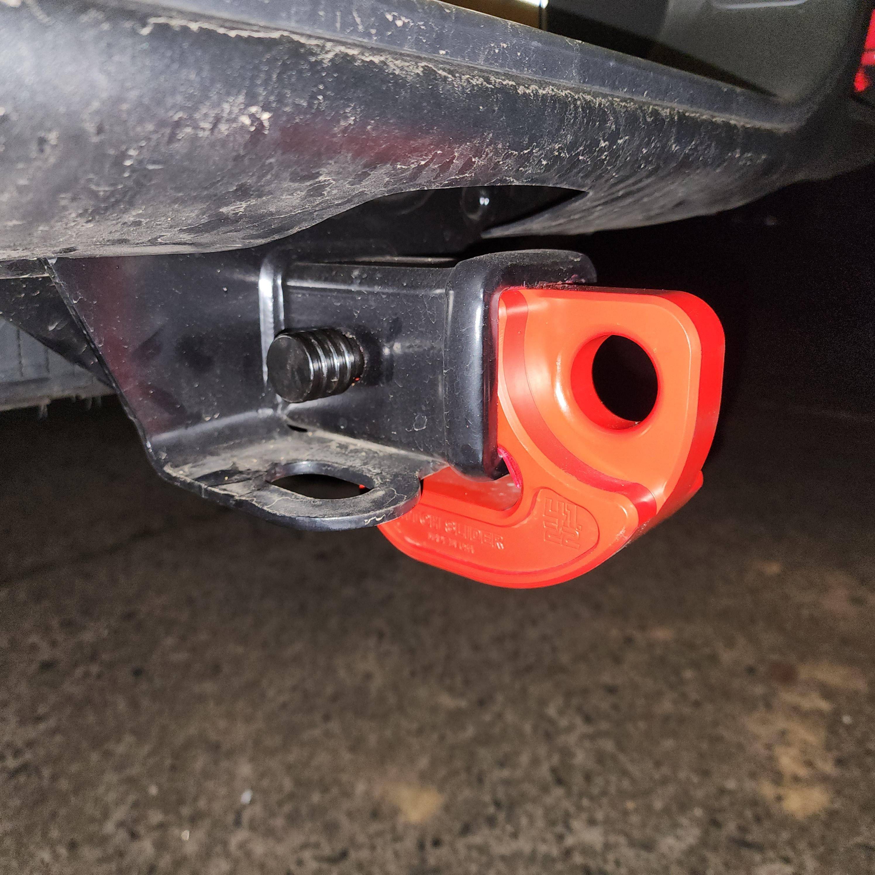

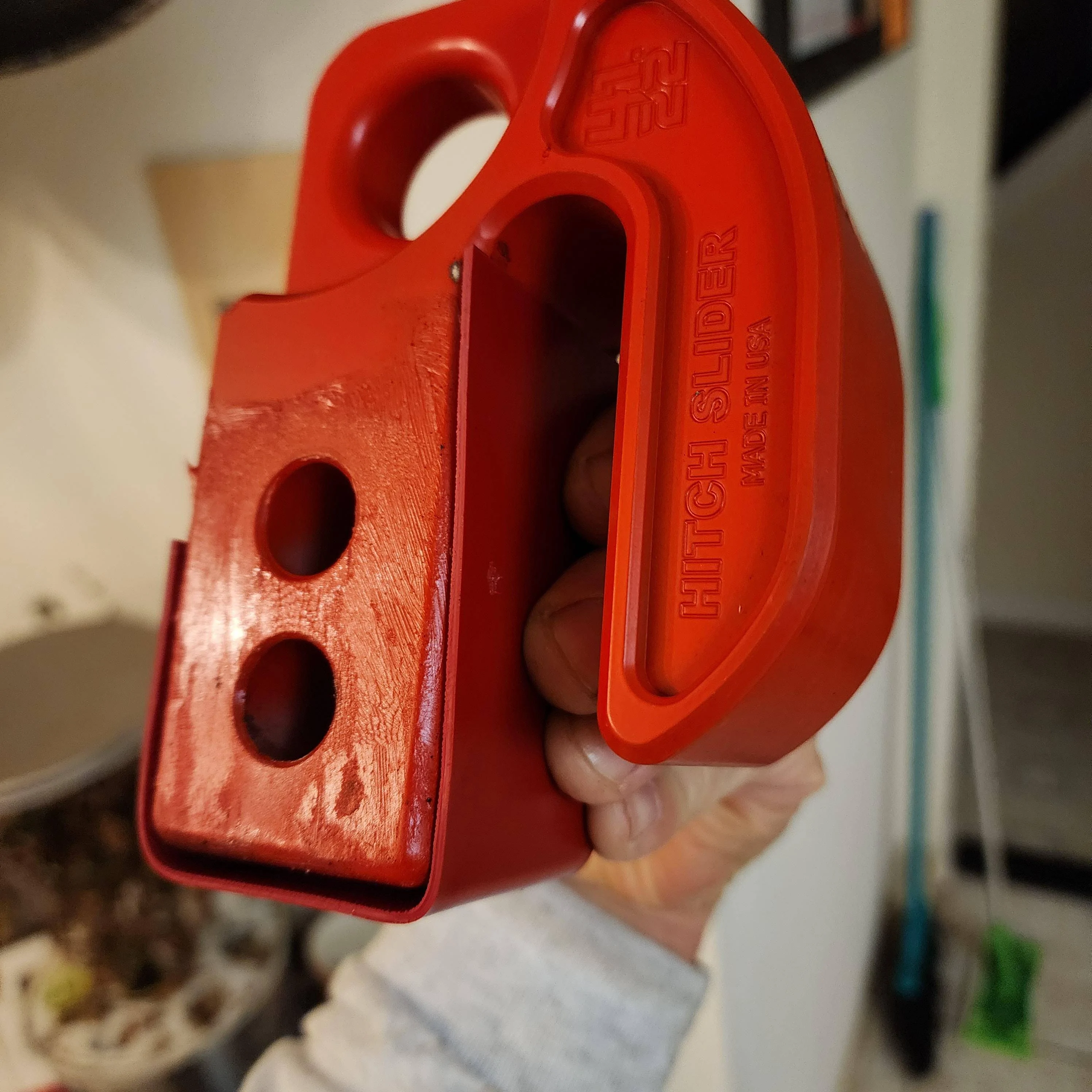

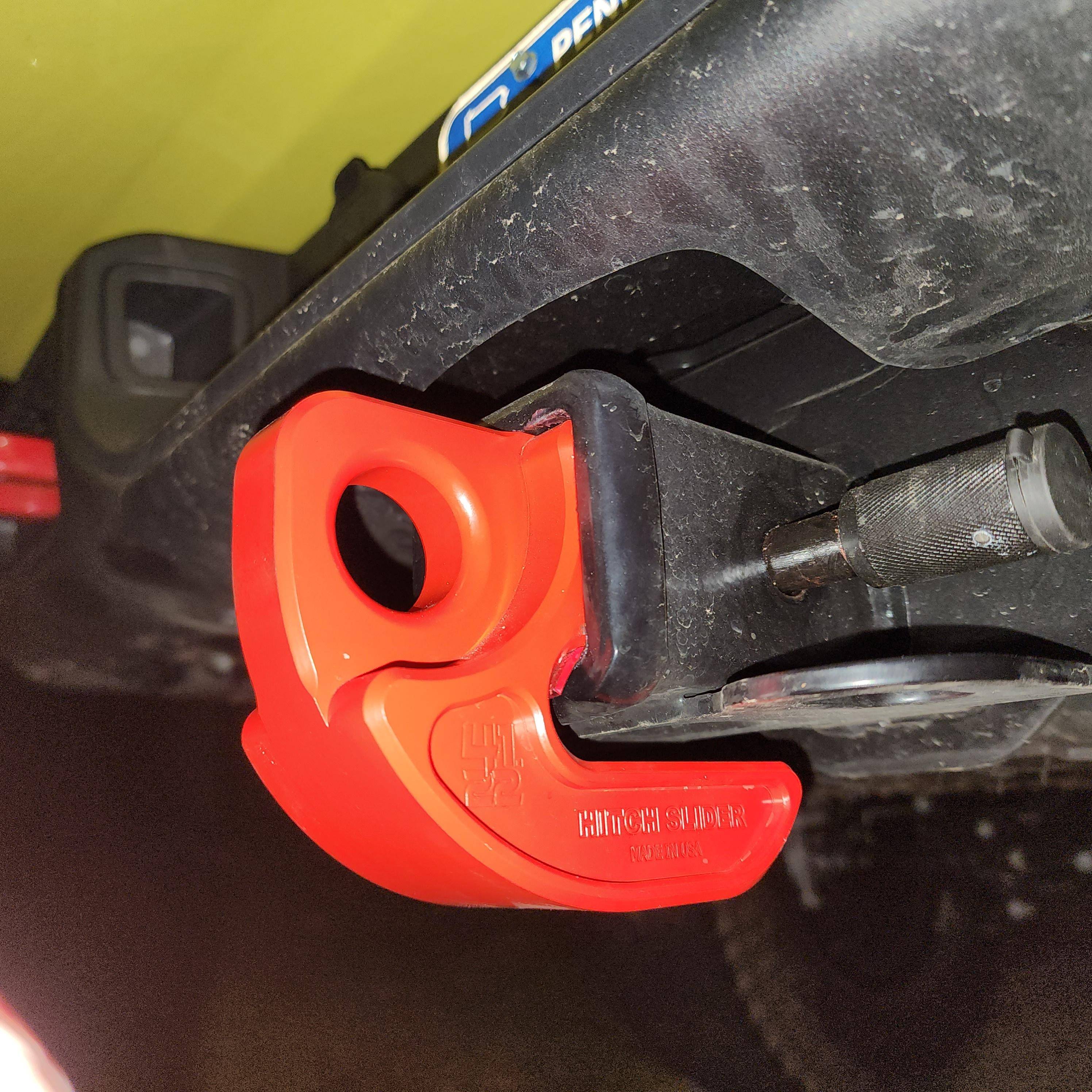

Well, after a member asked me about hitch skid clunk, it became a thing. I kept noticing it!! Ignorance was truly bliss.
SO I shimmed it out with some red kydex. Hopefully it stays put. Currently theres no motion in the hitch skid or the hitch locking pin. It may break in a smidge, may not.
Time will tell, lol

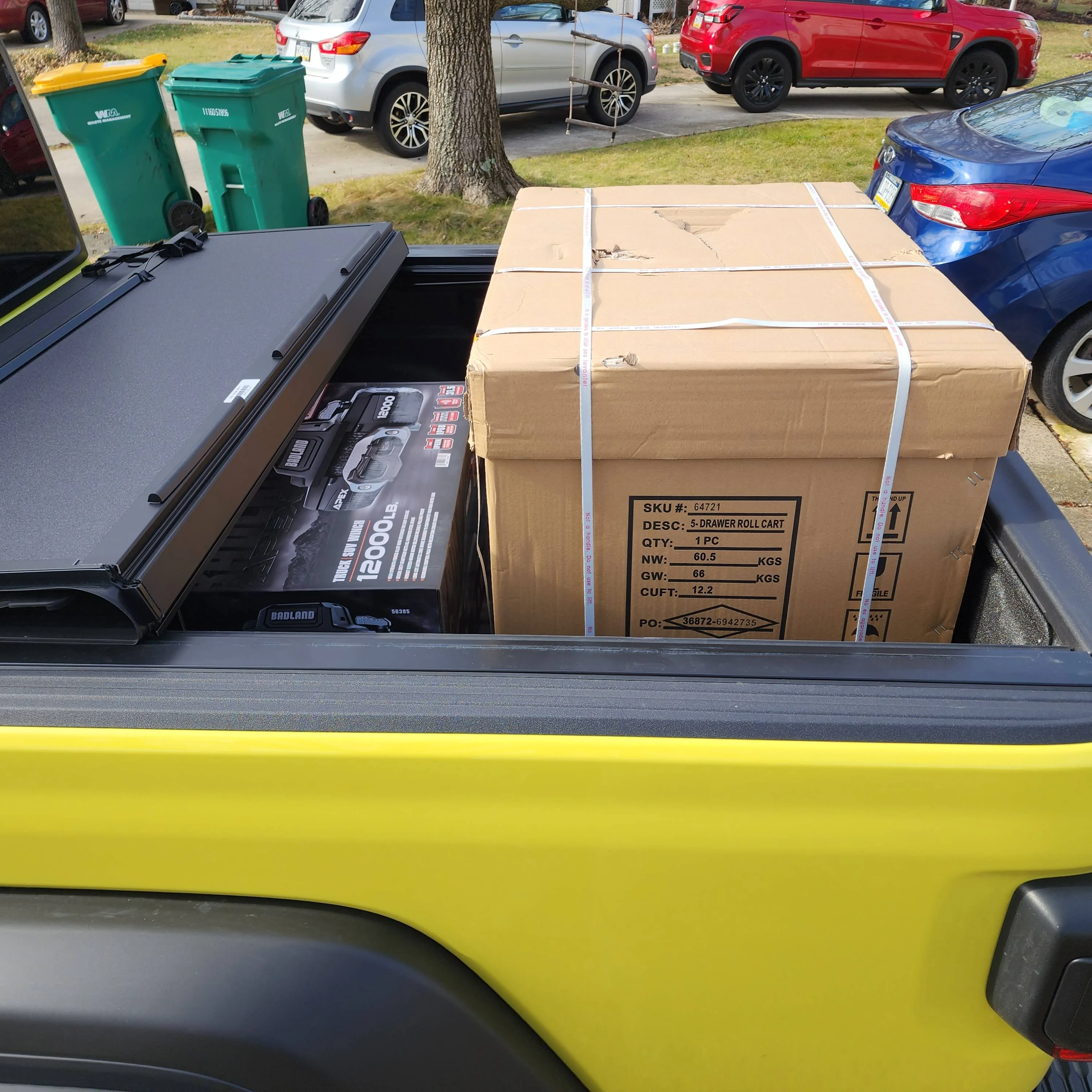

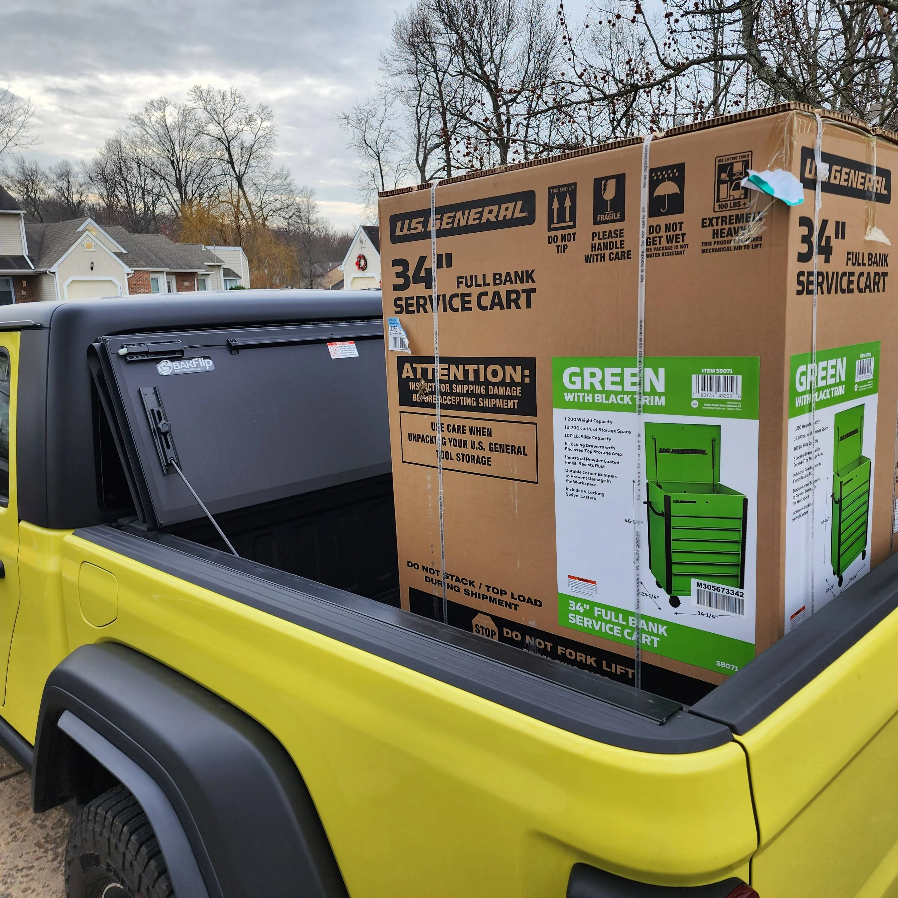

Used the Bakflip in two of its open positions! Truck felt great with the weight in the back.
Excited to have my tools in new storage, not excited to do it! Lol
Badlands Apex winch! Just need a bumper now, lol
