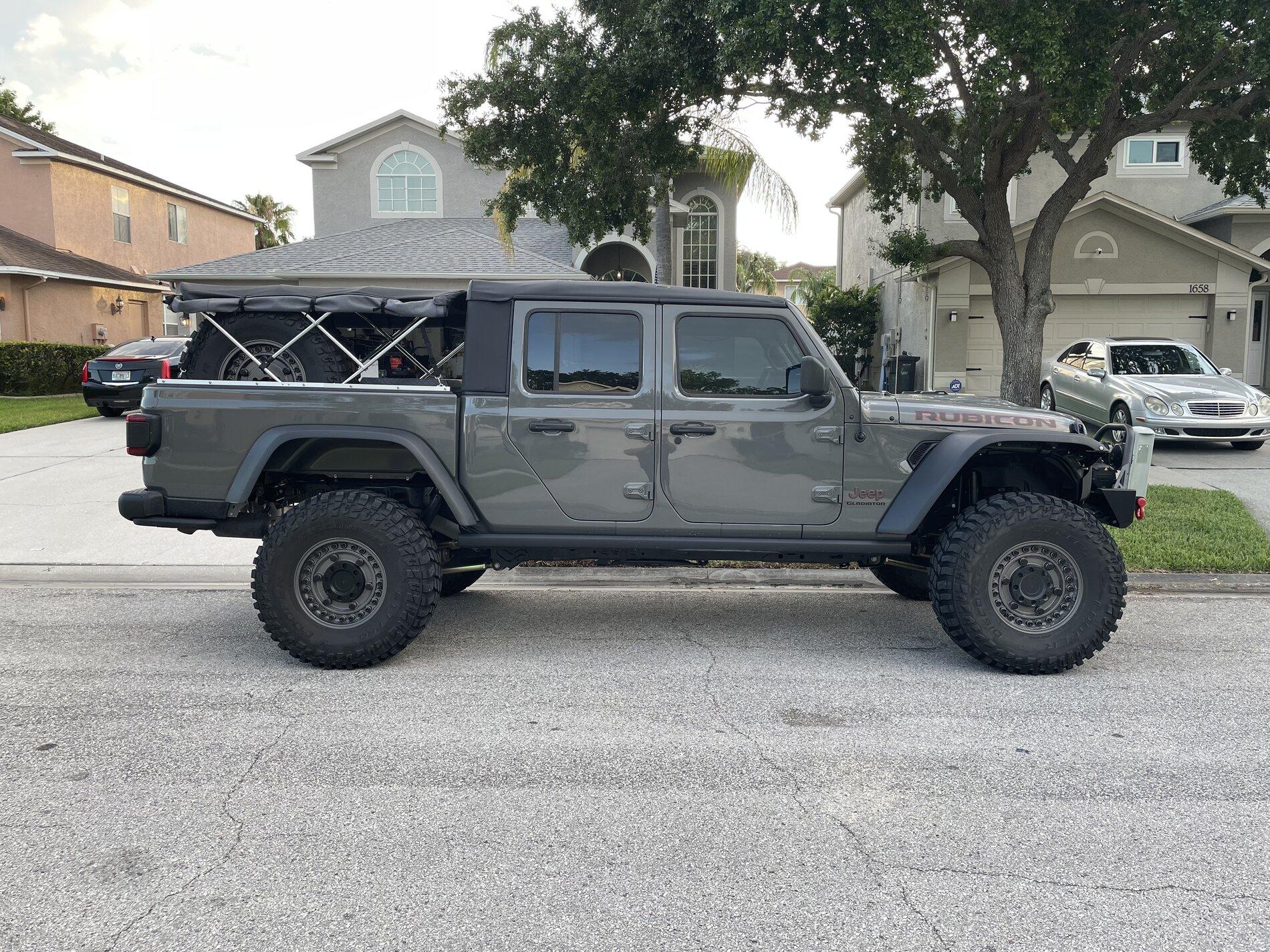

I’m running their 4 1/2” springs so I can swap to my beadlock wheels with 40’s for moab each year. I run 37” KO2’s daily on stock wheels with spacers. Helps with break over angle anyway and I still get over 22-23 mpg with the setup
if I didn’t wheel it I’d probably just run their 2 1/2” springs. Either way it’s a tad raked until you put some weight in the bed, which with camping, levels it out nicely.

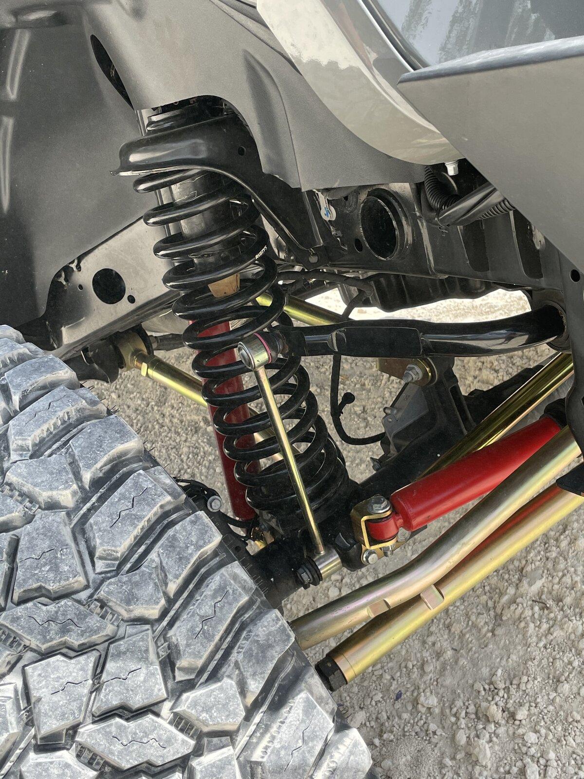

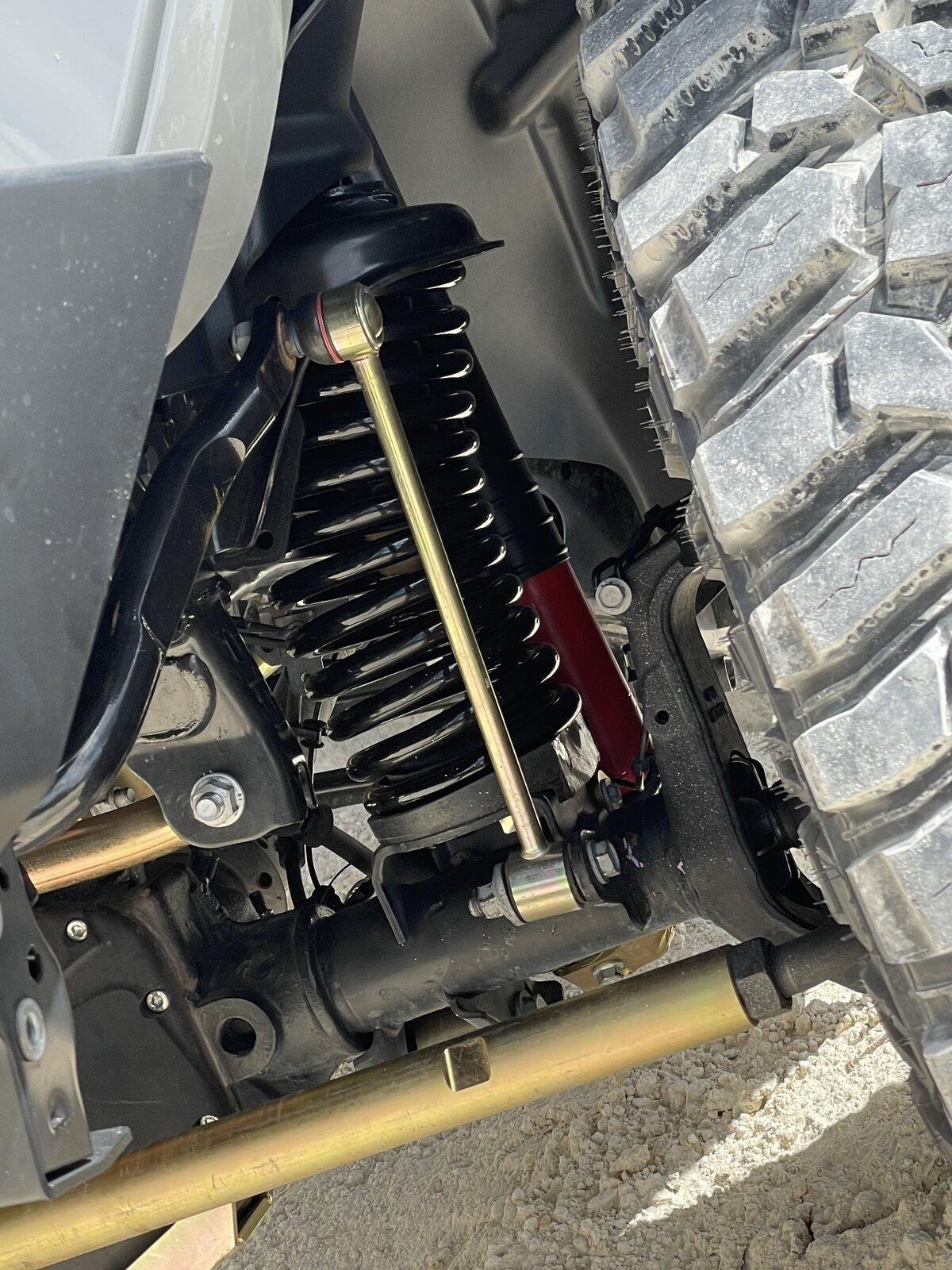

I ended up with the Rustys 4 inch springs and have been happy with them. My MC springs just sagged to much. Rustys has been very comfortable off-road and I even have more travel in the rear with their springs. They are made by eibach so it’s all quality stuff. I have 2 heavy trail rides and about 1000 miles on them so far. With that said, everything else is metal cloak etc…
which shocks did you pair the springs with? also curious with all rusty's springs how is the rake? did you measure to see if you actually got 4" out of them?
bigjmain
Josh
Feb 10, 2021
54
42
Tampa
Tech
Yes on my diesel it ended up being about 4.5 in the rear and 4.1 in the front. I had the rock sports on there from metal cloak but got the Rustys rx800. They ended up having longer travel and ride much better with these springs. Very happy with it but can’t comment on their controls arms or anything else. Springs/shocks only which are made by eibach so great brand and USA made.
