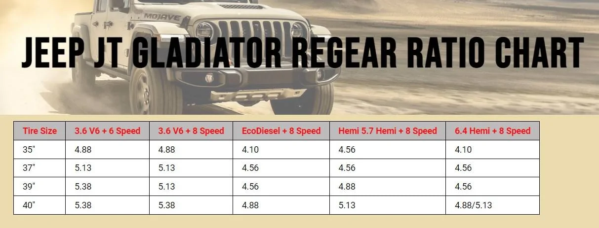

I vote for 4.10's!
I towed all over the west coast and south west on 37's and 3.73's for 30K miles felt it was almost perfect. 4.10's was too big of a jump for me on 37's.........so when I decided to go up to 38's, the 4.10s would be the perfect balance.
Last year we did a 5400 mile trip through serious mountain country loaded right at 12K + or - depending and still stand by my decision.

4.30's would have been a 16% change and way too much in my opinion despite me traveling loaded 5-12% grades all the time. I was looking for 6% to put my gear spacing perfect for towing and unloaded. the 38's and 4.10's got me as close as possible.
I drove on the 37's and 4.10's for about 5k miles unloaded and hated it, but my 38's were on a pallet at the shop just waiting..........

I agree, I put 37” on my last gladiator diesel, thought it was perfect … gearing was perfect. Power was great and MPG hovered around 22-27mpg, stock overland street tires was 27-31mpg.
I think the transmission is so versatile that going 4.56 would be nice and peppy and the double OD gears will just knock the RPMs down. But at what cost MPG wise.

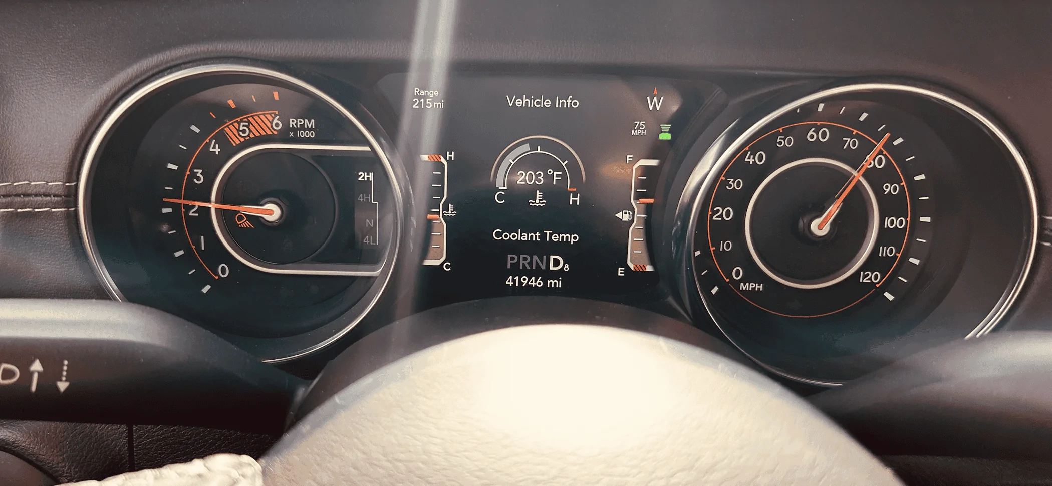

At 75 you’d probably be like 23-2400 RPM. I know with 3.73 at 75 I’m like 1600.
