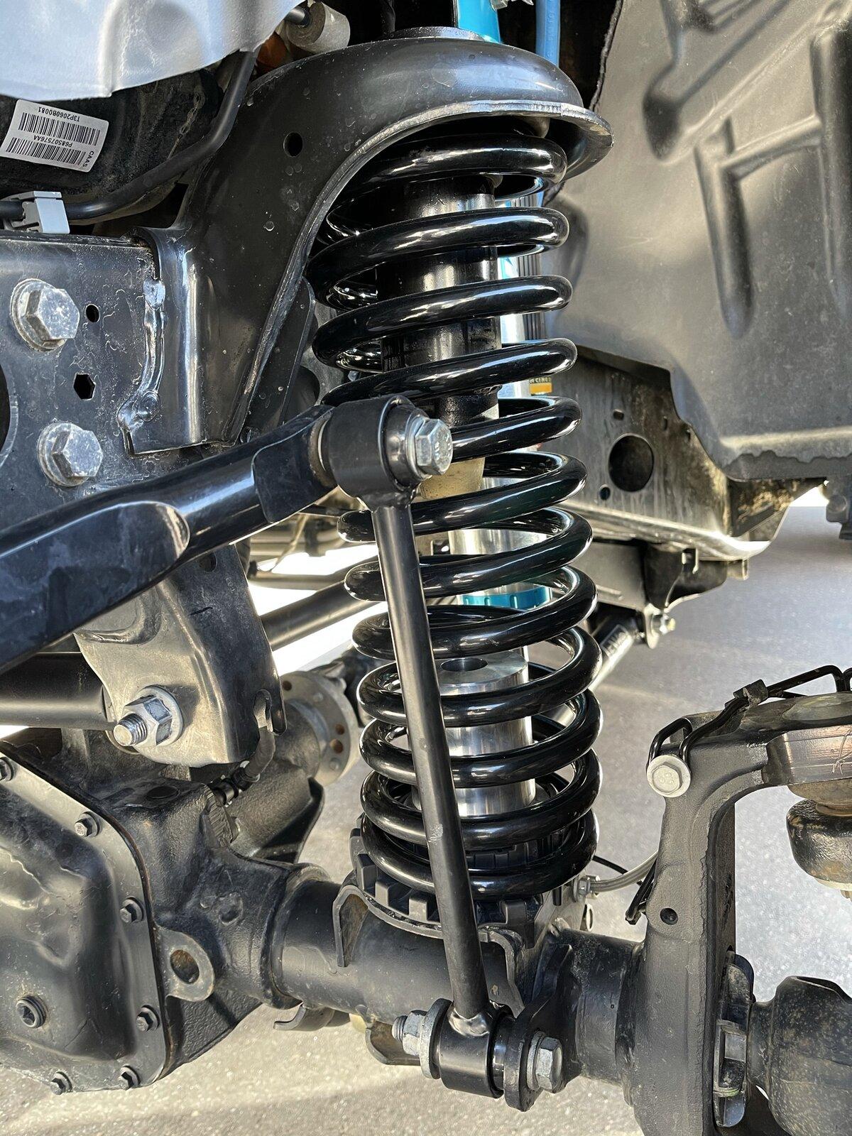

With the coils so compressed, almost touching, are you worried about fatigue?
To soon to tell but still holding height so far. Even my metal cloak springs compressed as much

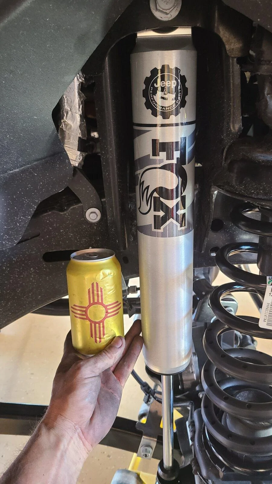

Jeep Gladiator Eco Diesel lift 20210626_115330
Jeep Gladiator Eco Diesel lift 20210626_154446~2

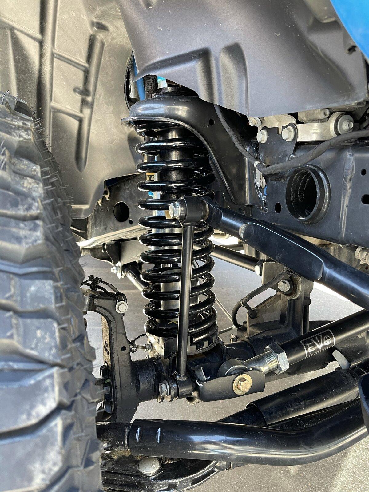

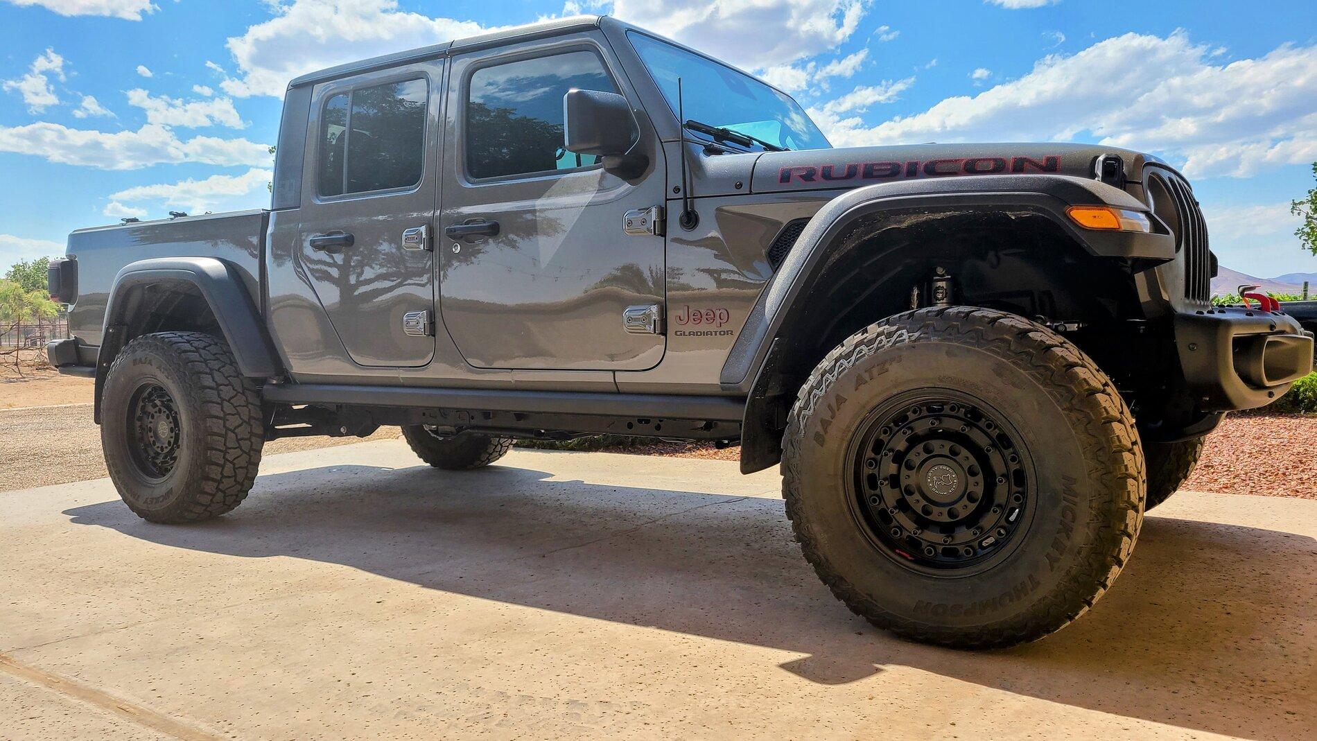

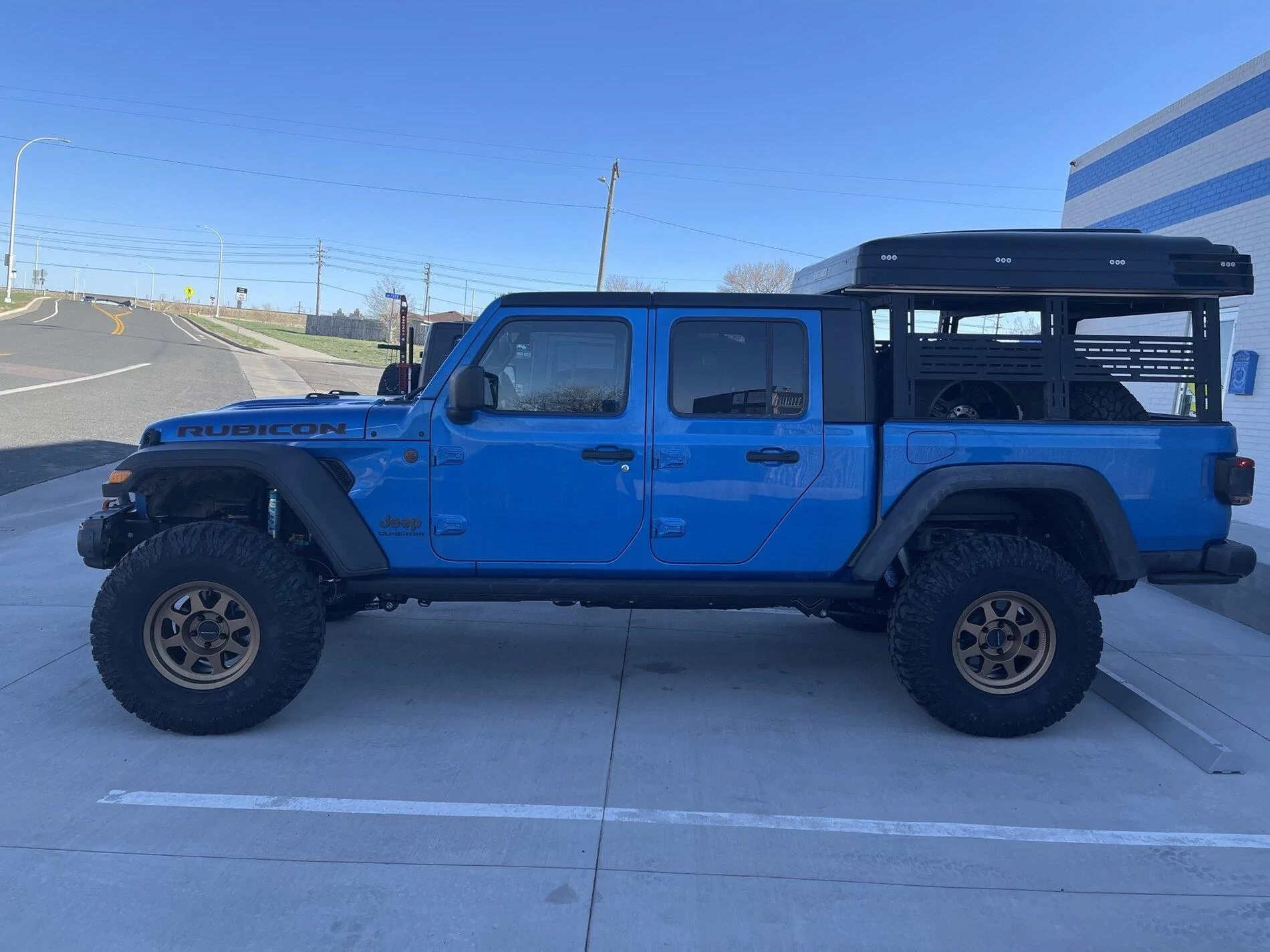

Evo MFG 4.5" diesel specific springs. Overall, it rides WAY better than stock. Less bouncing, better handling, smoother ride. Delightful on the highway. I'm thrilled with it.
Factory steel bumper and Warn 12k winch on the front. No spacers yet.
What size tires are you running?

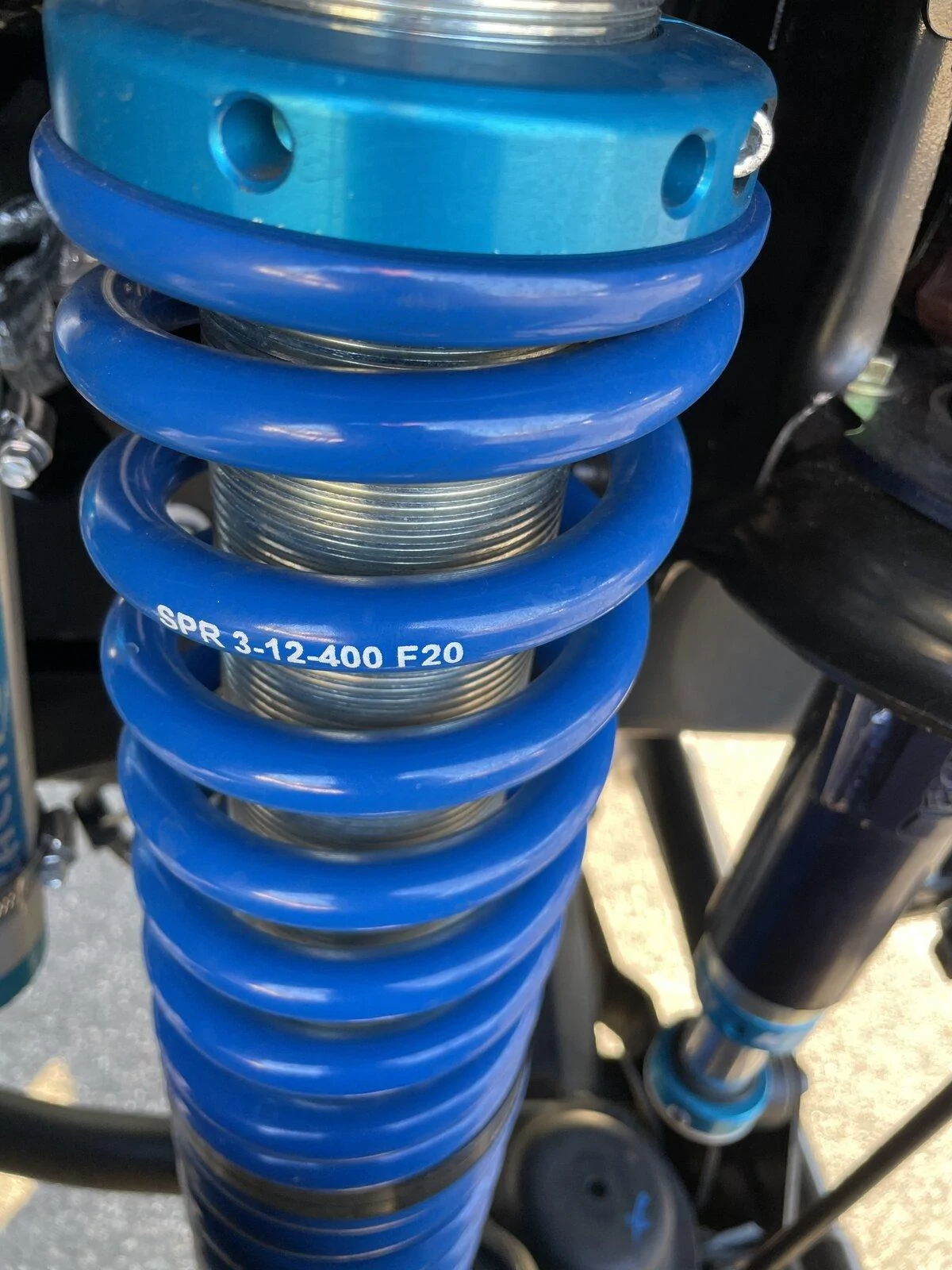

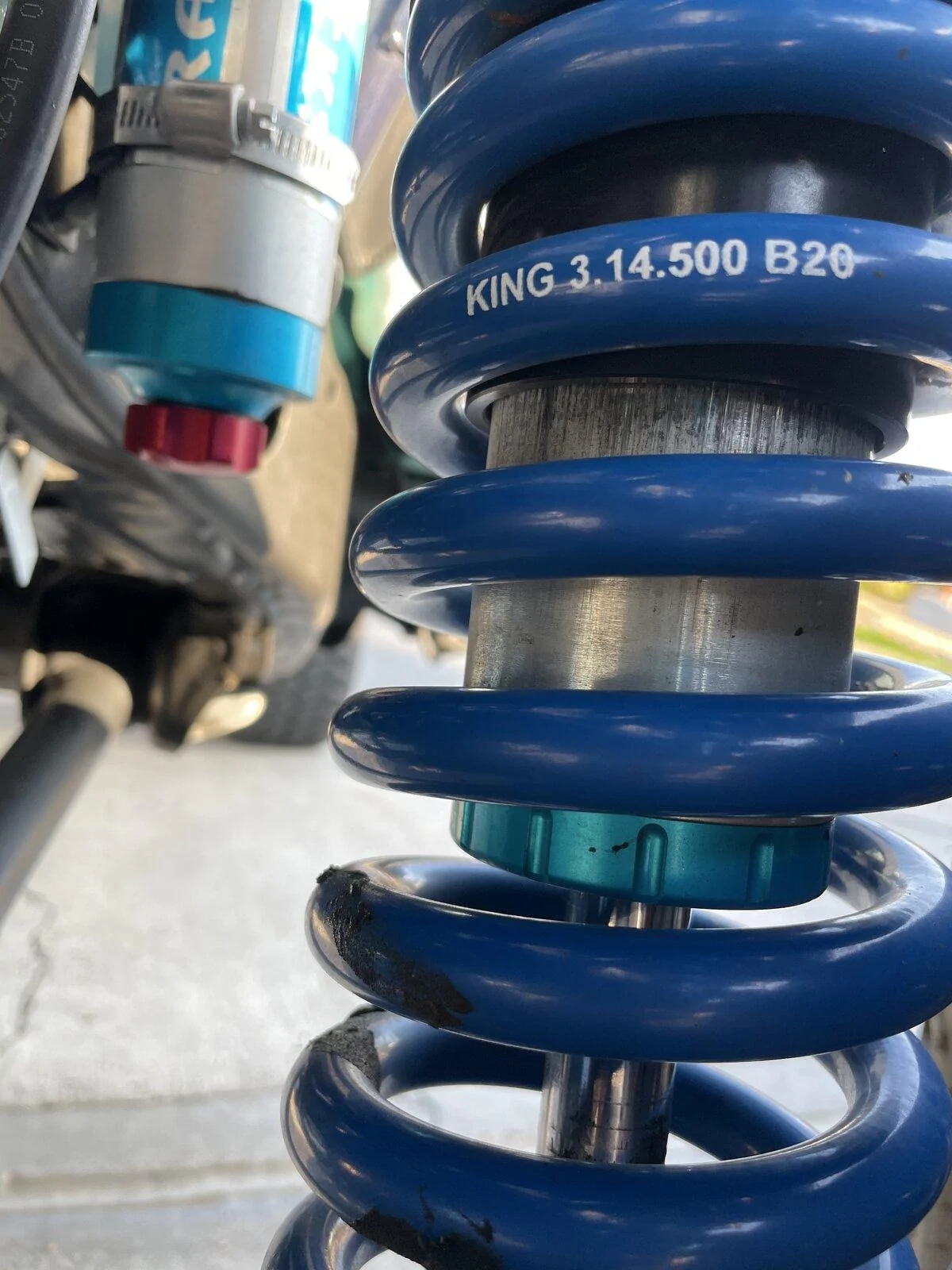

That’s a great question. So I had the 20 jt gas and had king coils and it was 400/350 as I was pretty heavy up front with grumper and such. This round I had king weigh each corner with everything on it and it ended up being 400 top over 500 bottom. Its just perfect.
For clarity, are you saying that these spring rates are between 350 and 500lb/in?
