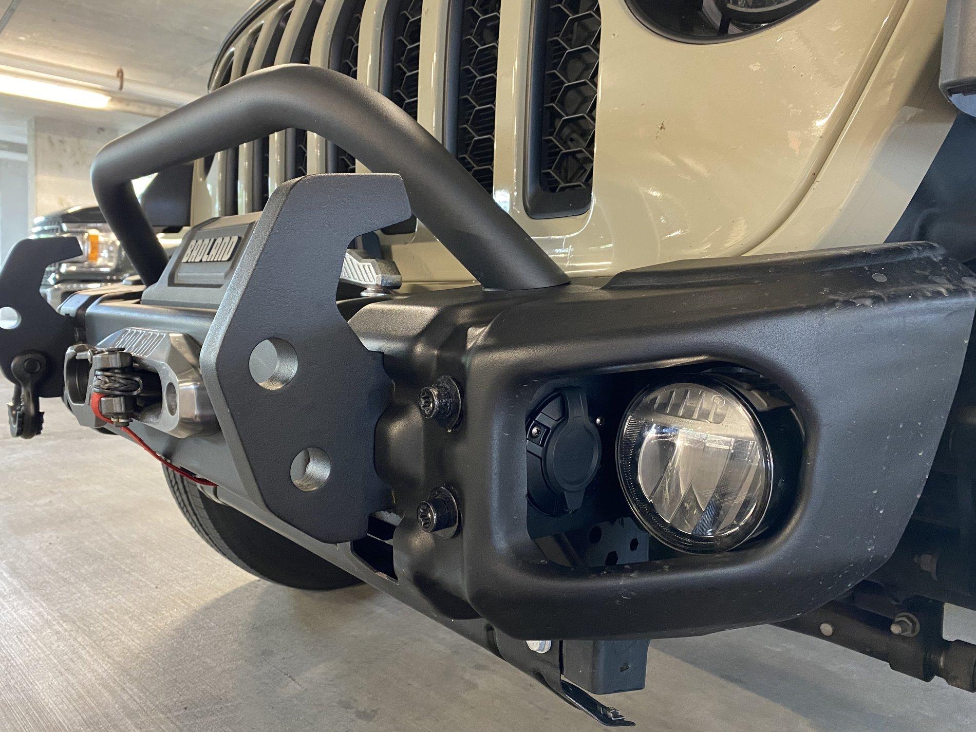

You running stock bumper?

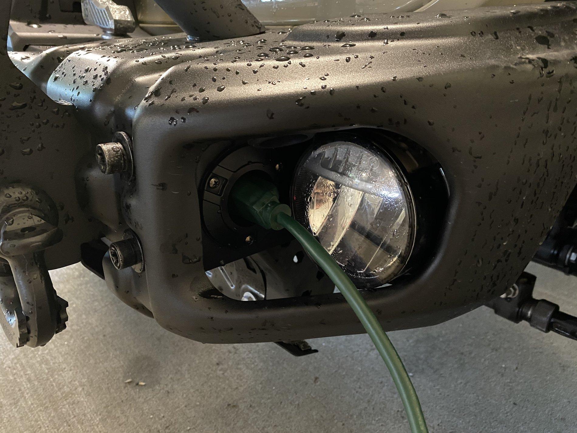

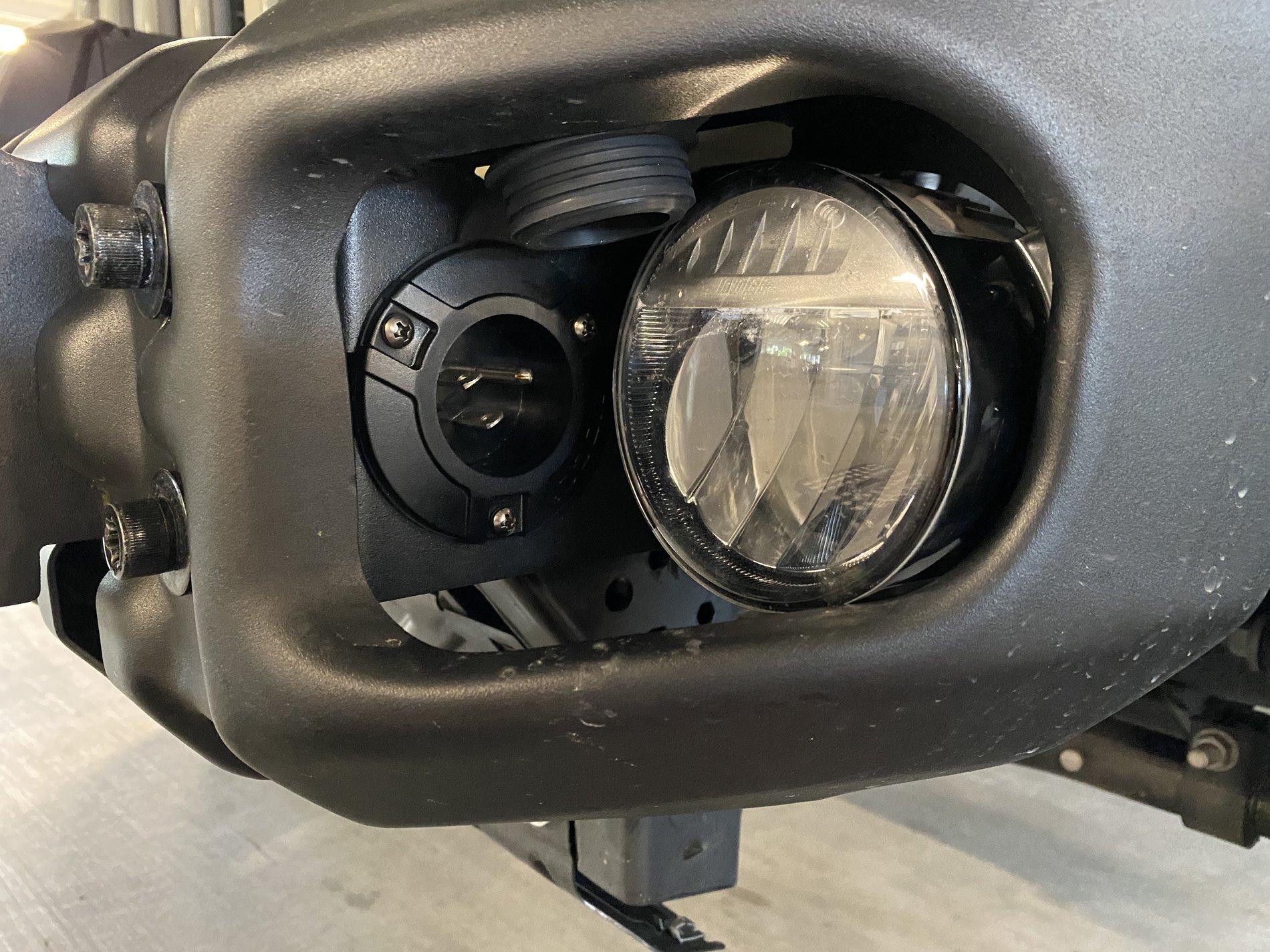

May not help your situation but here’s what I did...
Noco plug 6ft extension mounted into the side of my RR Arcus bumper. Connects to my trickle charger and can add a block heater at a later date.

Nice. I might do a plug in the bottom of grill. Or just lay behind bumper and body.
Or I may just leave it for the reality of me really needing it where I live in western Washington is slight.
Just curious what others have done.
