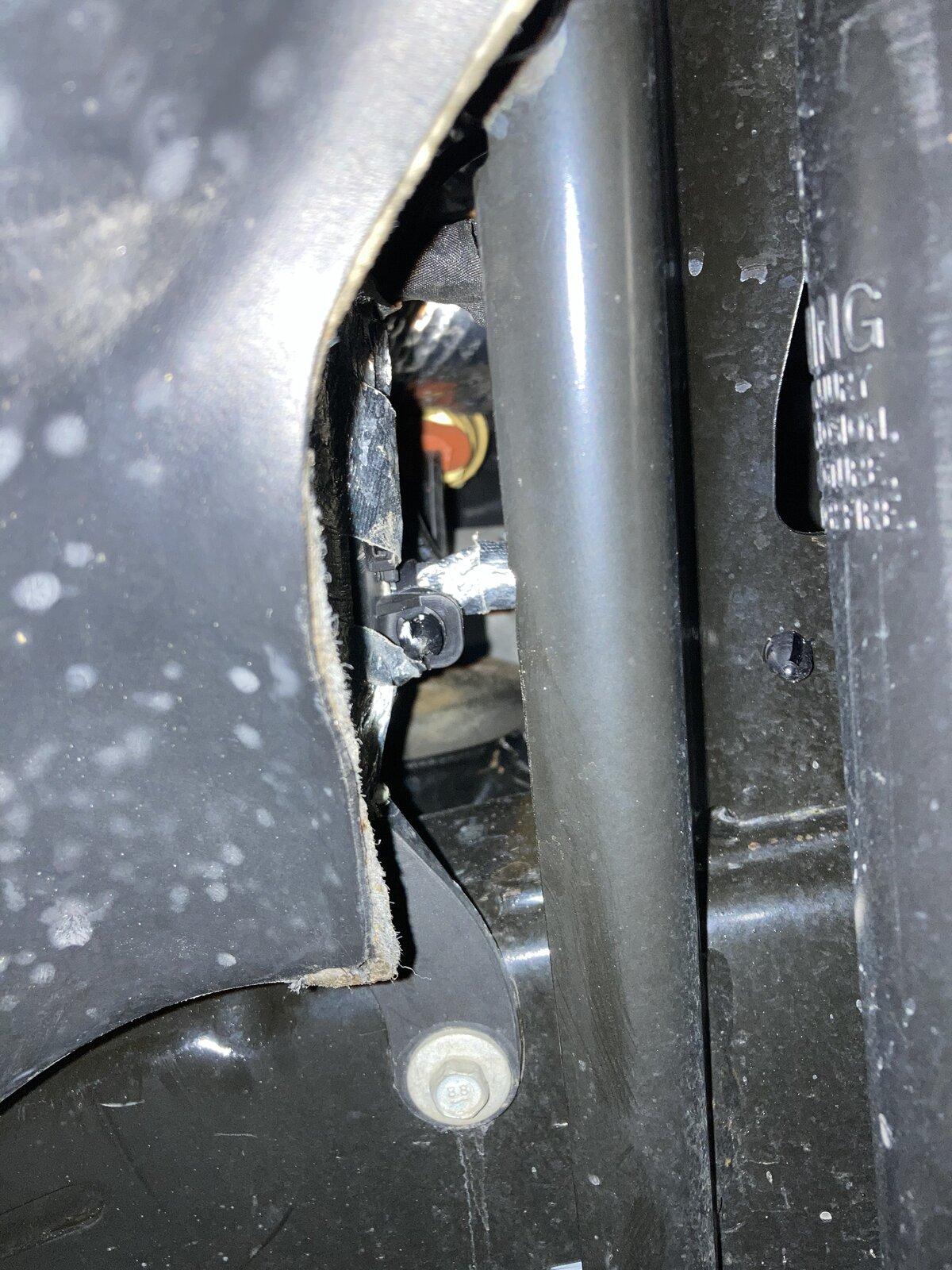

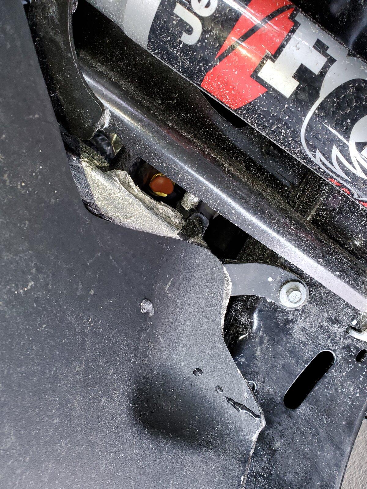

Thanks for the tip on this. With the cold weather in the upper midwest i grabbed the cord at napa. $21. Now to get it installed. For anyone looking it took a bit to find as you cant really see it. On the diesel here it is. Its location is an epic PIA. At least with the bulk of a jacket on i cant get my hand on it.

Good job getting a picture......I couldn't get a picture to show it.
Find a buddy with some long skinny arms. ? Im short and stubby and got it but I didn't have a big bulky coat on either.

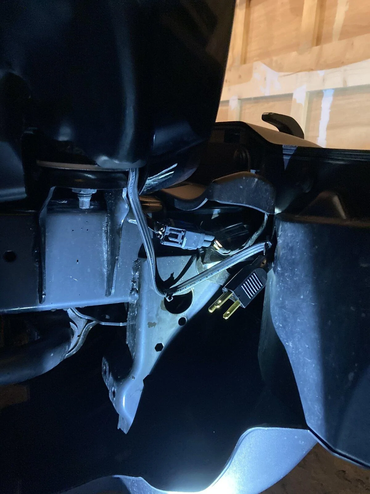

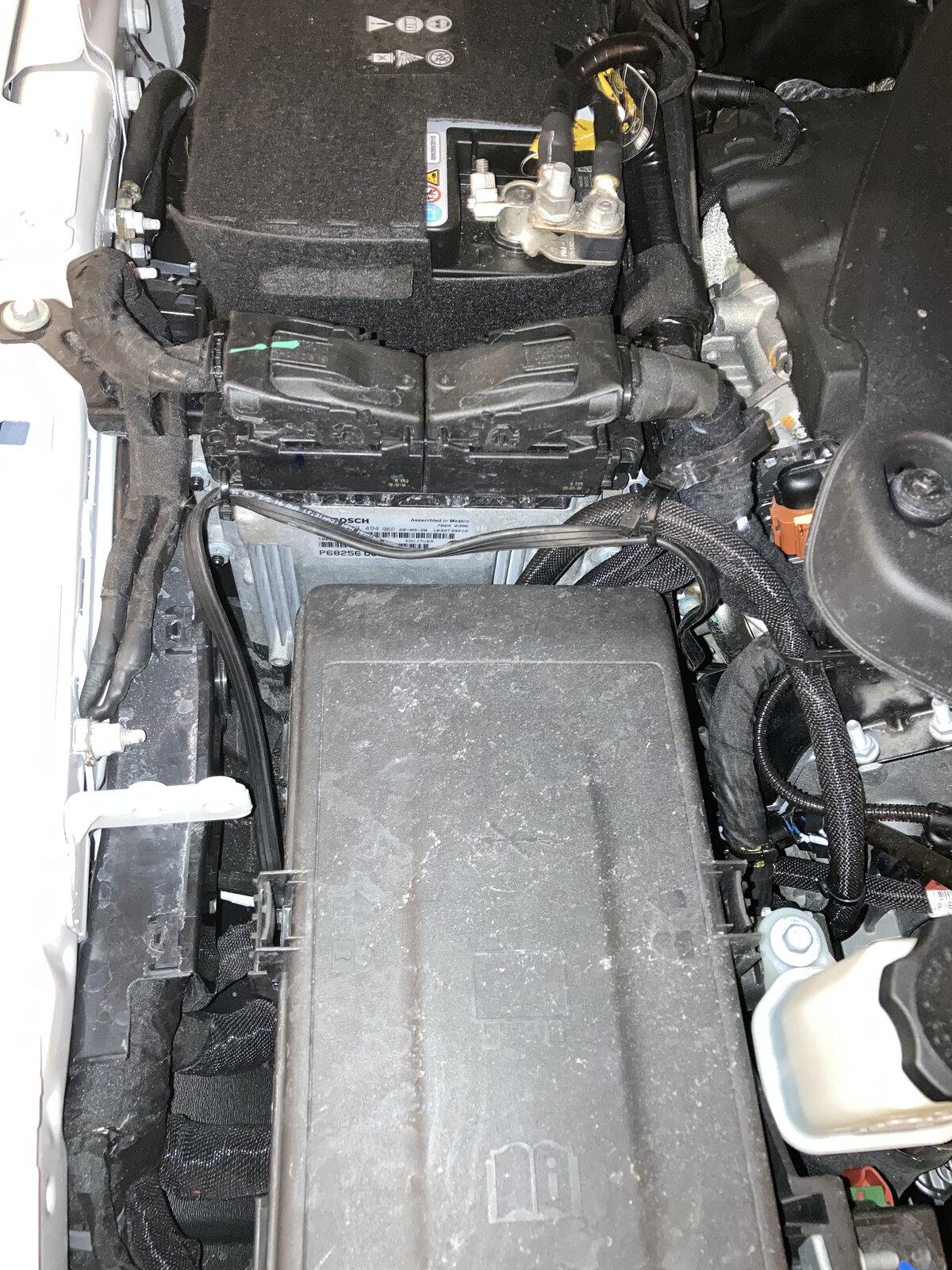

Cranked the wheels hard left and using the above pic allowed me to see it before rootin around in there.
Ran it up into the engine bay, tied off behind the fuse box and then back down behind the inner fender liner out under the passenger side head light. Tied it off to the frame and tucked it on the hook on the inside of the bumper as mentioned before.
Might purchase a cap for it so it doesn’t corrode but otherwise good to go. ?

So besides the fact that access to the plug in spot on the engine is next to impossible to quickly reach, I noticed that the OEM cord has heat shielding while the cheepo Napa one does not. Given that and being an experienced firefighter I've backed out installing the napa block heater cord.
