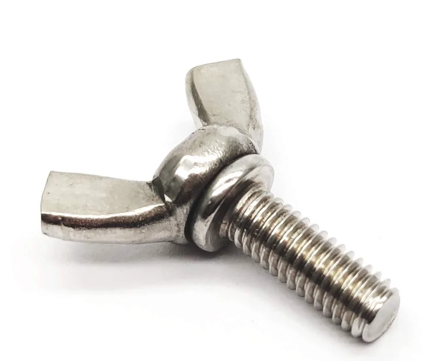

Would be super super cool if you could design one with a quick release feature, semi-permanent brackets install to the top of the windshield and the roll cage, and the main molle panel could be easily removed and placed back with thumb screws or something similar.
If you do it, I would love to beta test them for you :)
This isn't difficult. We initially considered making two small revolving doors and wing screws, but that would have two drawbacks:
1. Wing screws don't look as clean as Allen screws.
2. Powder at the hinge area is easily worn away.
I've noted your requirements. We'll contact you if we make a beta version later!

I have been thinking about this the past couple weeks.
My thoughts are the main molle panel could sit above/on top of the two brackets that attach to the roll bar/windshield. That way you can strengthen the brackets to support the weight of the panel.
PEM studs pressed into the brackets, studs facing up, and then low-profile thumb/wing nuts to secure the main molle panel against the the brackets.
To me, it would be acceptable to have to remove the freedom panels in order to remove the main molle panel.

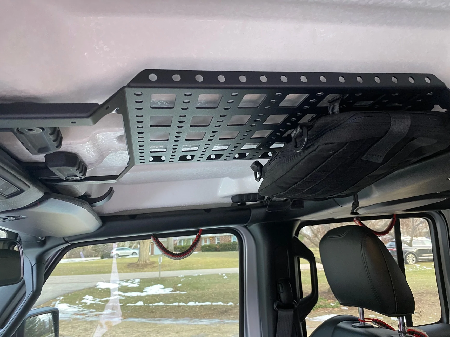

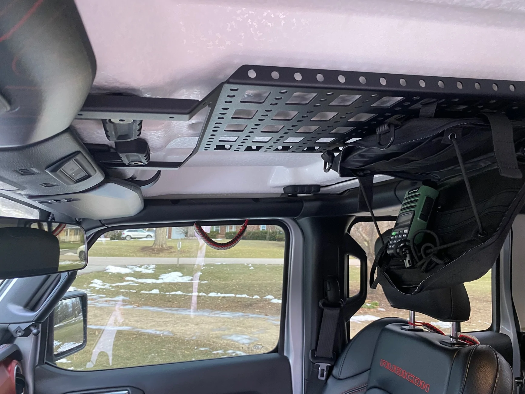

Installed mine. Worked with sunrider top.
I'm so glad to see it! Would you mind if I used these photos as a reference and to help more customers?

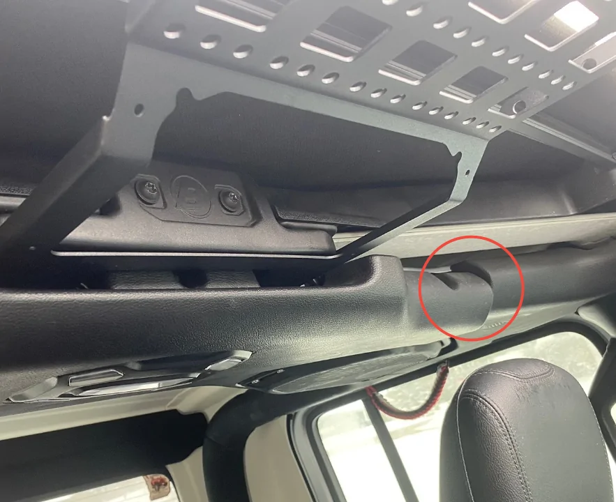

The trim panels here don't seem to be aligned. Was that how they were supposed to be, or did you leave it like that to accommodate the Molle installation?

Just being lazy. Left the sunrider on through 14 inches of snow. Installed molle and then pin panels back on.

Yes, the panels are back on.

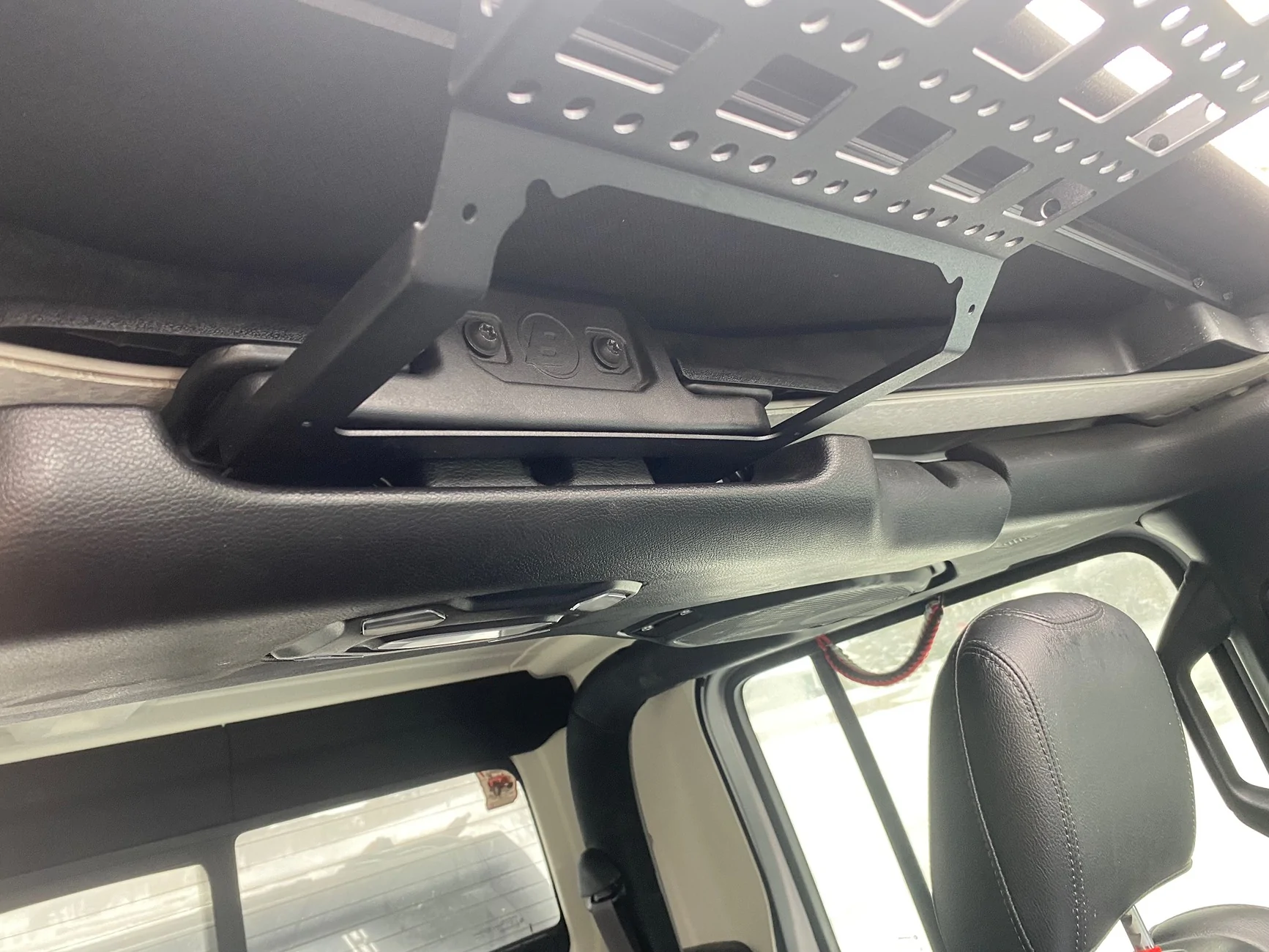

So just to clarify what I did, I left the trim loose to allow the panels to be adjusted after I ensured the sunrider bracket worked with the molle. In view of the earlier comments, I left the locking tabs loose until the panels we set and then tightened them. However, they were not set and I have a noisy gap, and now need to go in and readjust the panel locking tabs over the rear view mirror. I would suggest pushing down on panels from above to make sure they are set before tightening.

I've also thought of a solution. The current structure doesn't need any changes. We can provide some extra wing screws, matching the existing Allen screw specifications, without significantly increasing the cost.
If you want quick assembly and disassembly, use wing screws; if you want the cleanest finish, use Allen screws.

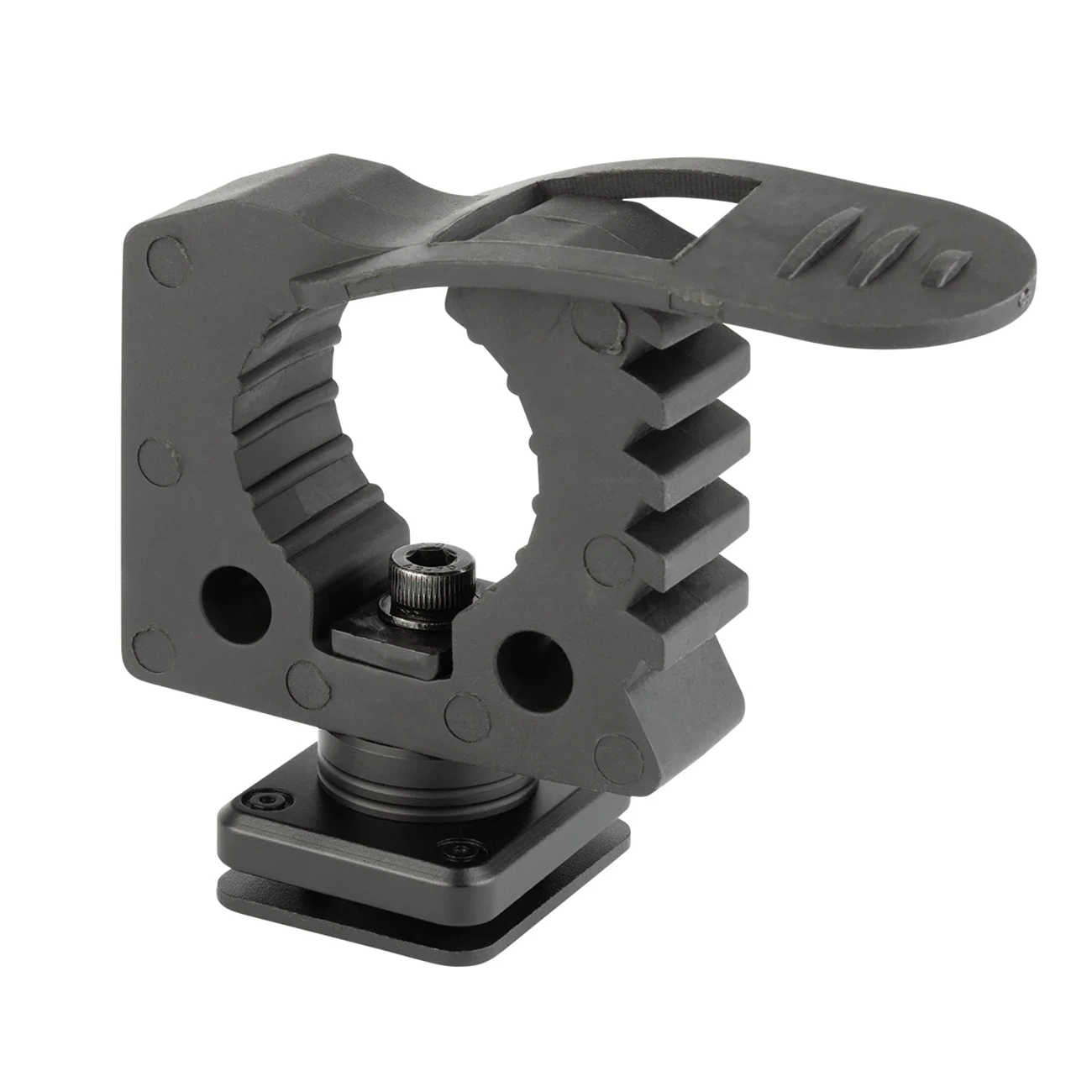

I have mine installed and am now discovering the size of the holes in the molle panel are not compatible with tool mounts from DV8 or Bulletpoint. The DV8 mounts are quick release and requires 1" x 1.5" holes, the Exceedfab product is 1" x 1-3/8". The Bulletpoint would work but they sandwich the panel between mounts and would require I remove the panel for installation. Now I'm stuck using less secure straps for retention.

Are you talking about these types of tool holders? Can't you just pick up bolts and nuts as needed for the smaller round holes? I am wondering if the Putco mount plates would work, but they are not cheap.

Those are exactly what I bought, 2 pair. But I have figured out that by removing the small molle panel end panels for quick access to the freedom top latches, I can then have access overhead to attach the phillips screws into the tool mount and be good. I will post images.
