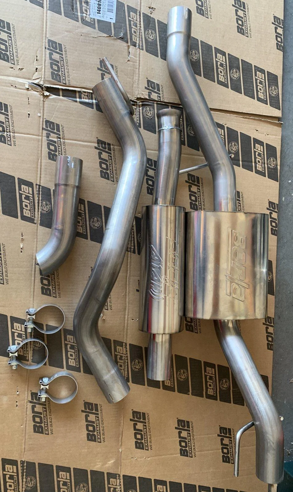

Jeep Gladiator Exhaust upgrade E8C9733B-4E06-4FE3-8DDD-C1A412A04A83_1_201_a
I had the S type on my 2015 GMC Sierra and really liked it, but wondered what the Atak would have sounded like. So, for the Gladiator I went with the Atak and love it. I think Borla makes a quality product.
