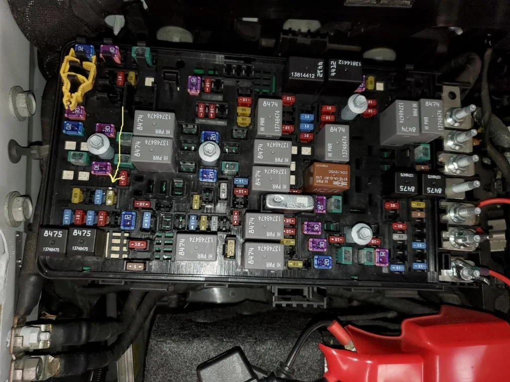

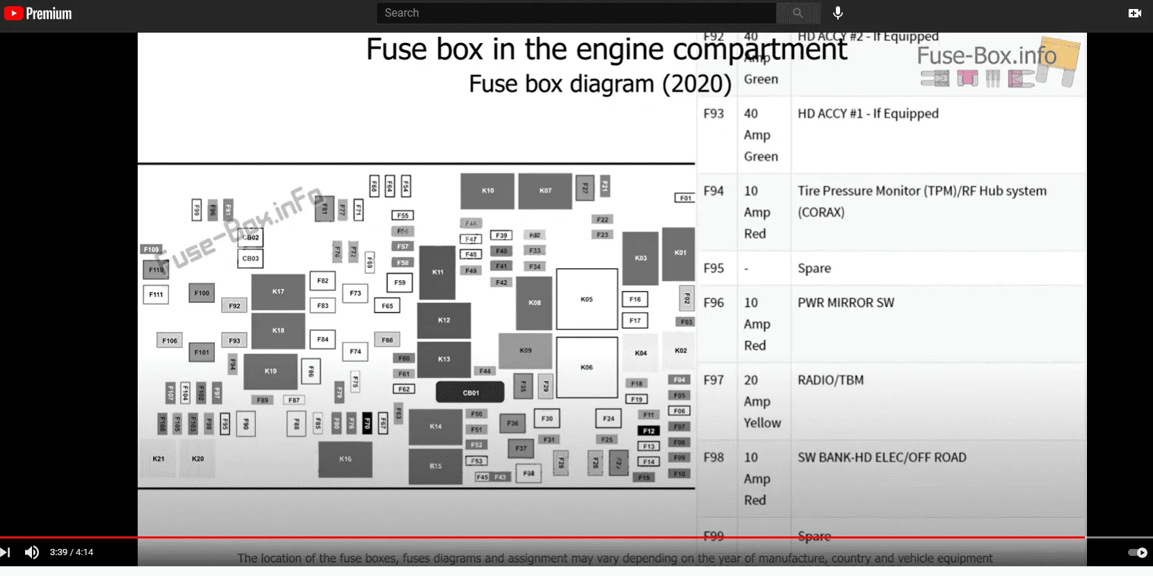

Yes, if fuse F97 in the PDC is not pushed down properly/wiggles loose, is blown.... you will see the "center radio" as you call it black.... black just like you see when you press the radio OFF button.
See the pic below that poinst to F97. F97 is a good one to say mark with a spot of say white out
as it / F97 is a fuse that you will find you dealing with more, then say some other's.
Pulling F97 causes UConnect / your radio to reboot, this reboot will often remedy an issue that may arise..
Sure you can wait for UConnect to eventually / in a day or so reboot on it's own, but again, the F97 causes the reboot immediately.
---While vehicle is running, pull F97 for say 10 seconds and then plug F97 back in... that's it.... UConnect/Radio reboots. ----
