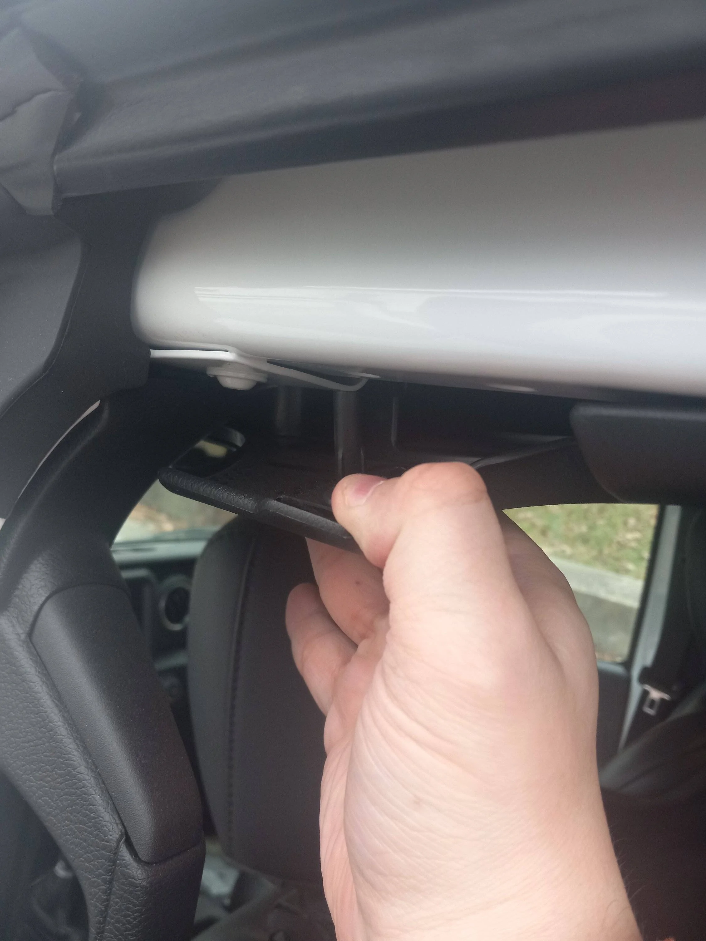

Update: I just tried it again today, and still get a rattle around volume 27 out of 36 w/ the Alpine amp. But that's hearing damage level and I never run it that high. That peg you mention above may be the culprit. Maybe try wedging something in here or there and see what changes.

@RickF I am having the vibration issue with the soundbar, I can eliminate the vibration by pressing on the passenger side speaker grill.
Do you have any pictures or a thread you can share showing what you did? Also, I think I am getting some vibration from the dome light.
