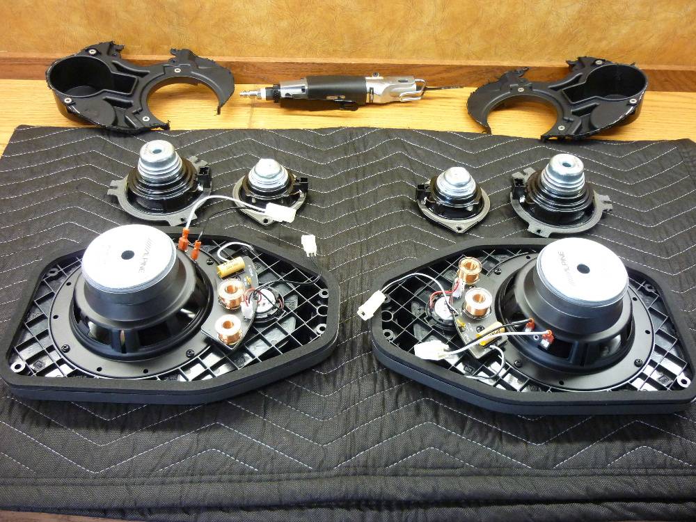

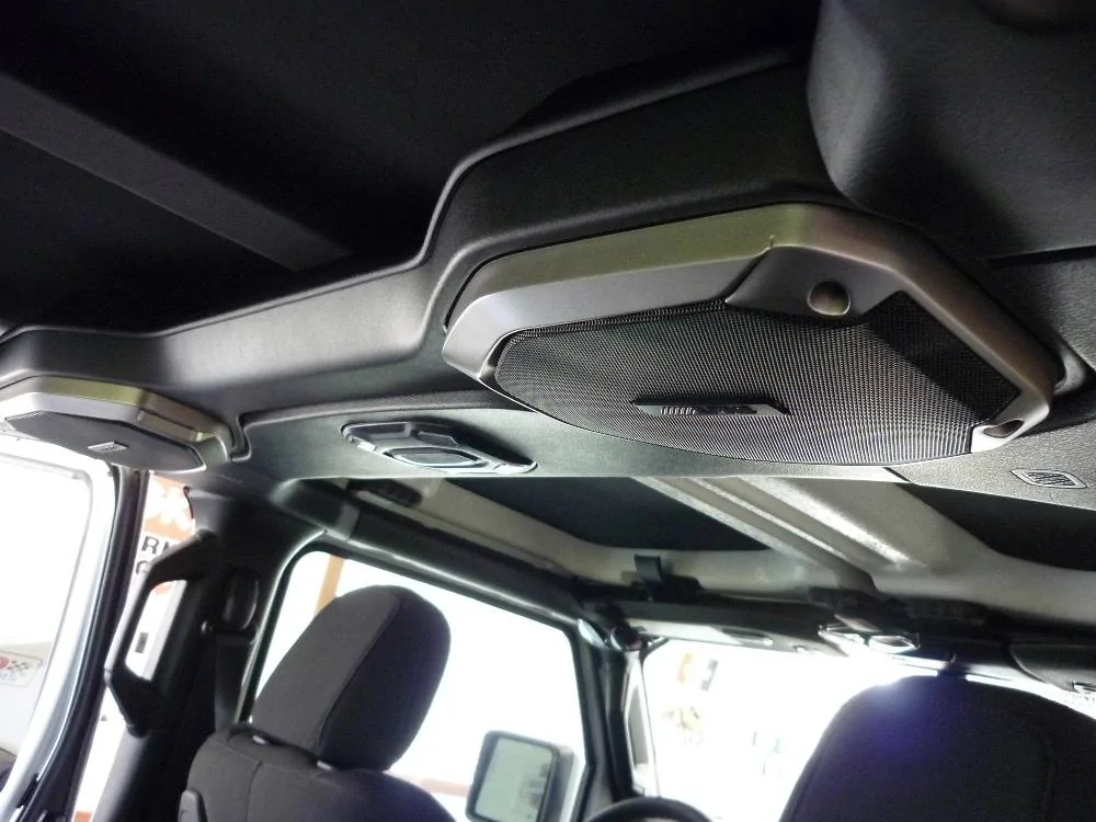

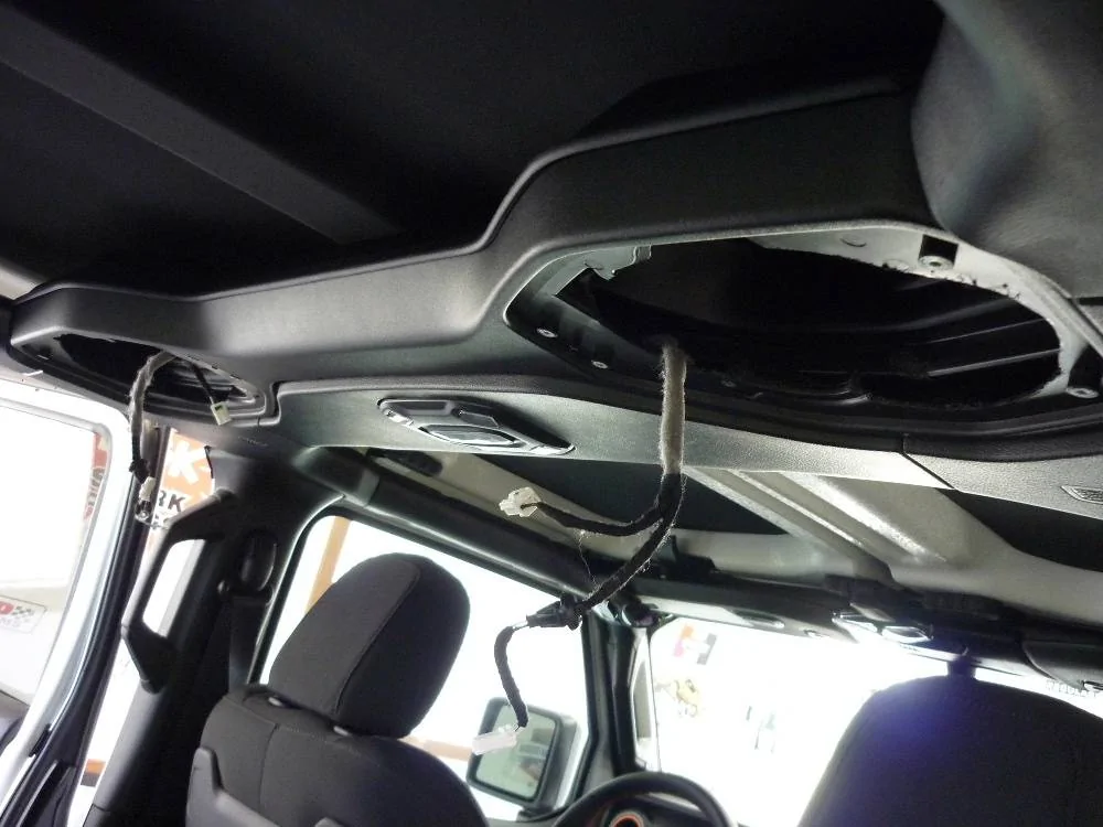

This is from my previous post 8/22: Today's mod was the Alpine SPV-65-JLT soundbar speaker upgrade. After removing the factory speakers from the soundbar (premium sound system) one can really see the difference in the overall quality of the upgrades. Yes, a bit intimidating at first because once you commit to the install, there is no turning back due to the cuts. I just used a body saw and sliced it out. After about 100 hours of break in time the sound should be where I want it.
Updated comments after living with this mod for an eight-month timeframe: I don't think I would go with these particular speakers. I was hoping for better low-end punch which I never really got even after break-in. They are a bit louder however but with almost too much treble (tinny) from the dome tweeters. I tried all adjustments I could and stuffed the cavities full of poly foam. I would try a 6x9 or just leave the factory Alpines if I had to do it all over again. But as stated, once the cuts are made, there is no turning back.
