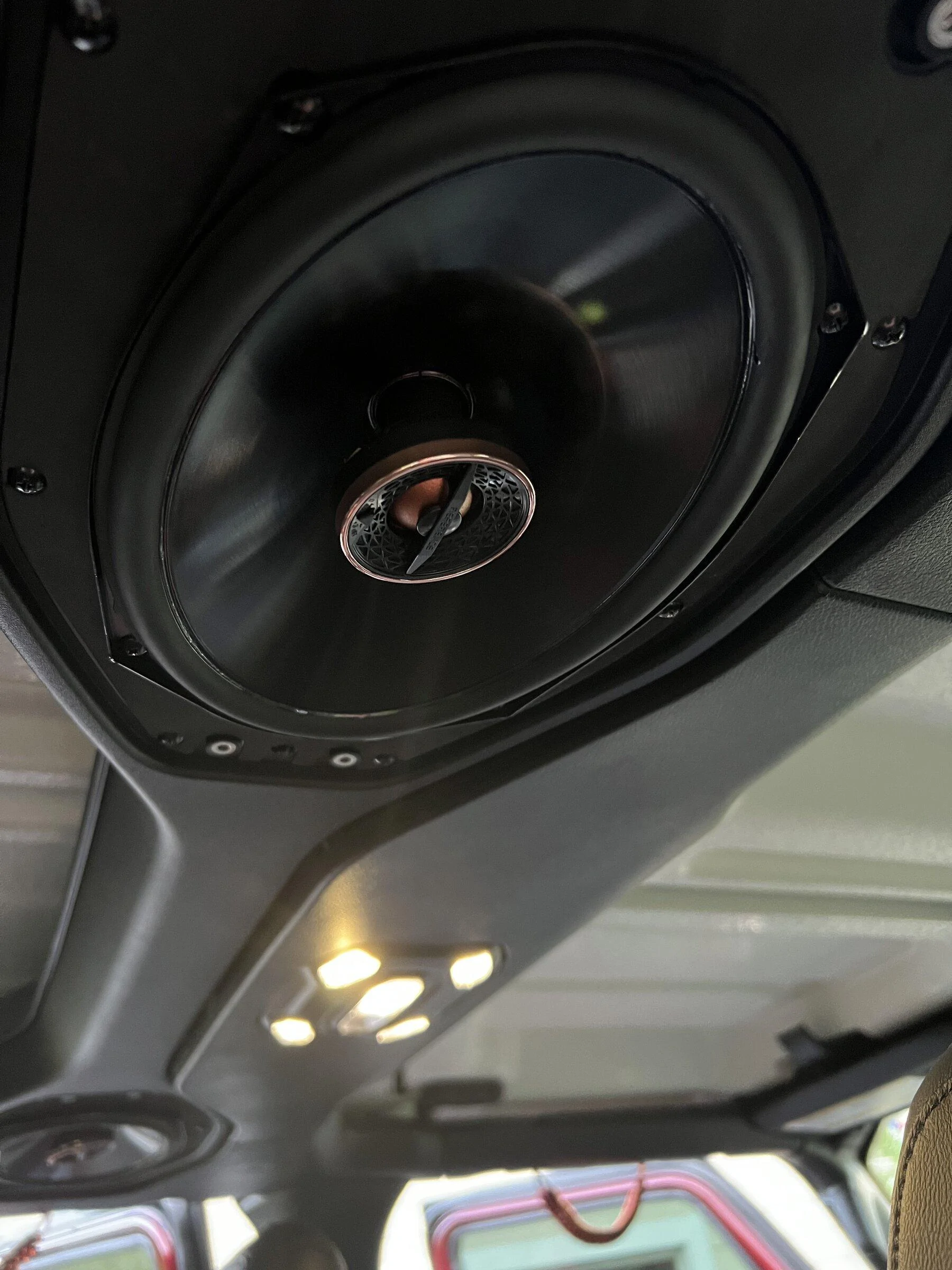

just finished. Not components. The mb quart adapters come with a short wiring piece that connects to the smaller stock speaker wiring and to new speaker. Easy is understatement.
again, this isnt for everyone as it involves cutting the inside of the soundbar, but it works for me.
Now that you have had these for some time, are you still satisfied with the sound? Do you have the Alpine premium sound with two speaker leads on each side? I am thinking of going the 6x9 route in an attempt to try to gain back what I lost.
I cut my soundbar and added the Alpine SPV-65-JLT upgrades as I detailed in a previous thread. I thought that it would "break-in" nicely after some time but after living with it for a couple of months now, I am not convinced this was the way to go. The tweeter high end is definitely improved but the added bass from 6-1/2 drivers is more of a boomy mid-bass. Pulling down the EQ to compensate takes the deep bass from the system (and sub) and too much is lost in the process. To my ear, it was better with the smaller 4-inch stock drivers because their response was minimal, and I could use the EQ and sub to my advantage.
I am not interested in dual subs or a bigger amp but would like to tweak the factory system a bit more to get that low bass. Now that my soundbar is cut, maybe 6x9's will do the trick?
Yes, its the premium sound with dual leads, the adapter just picked up from one.
i am completely happy with it. Now i am not an audiophile that is going to pick every part of the system apart. I use XM all the time, and listen to everything from Grateful Dead, to county, to Ozzy, to old school rap.
at higher volume the stock speakers couldnt handle all of the above, yet to have an issue with clarity turned up loud.
hope that helps, audio is so personal preferance. But with front roof off, windows down etc, this has worked for me

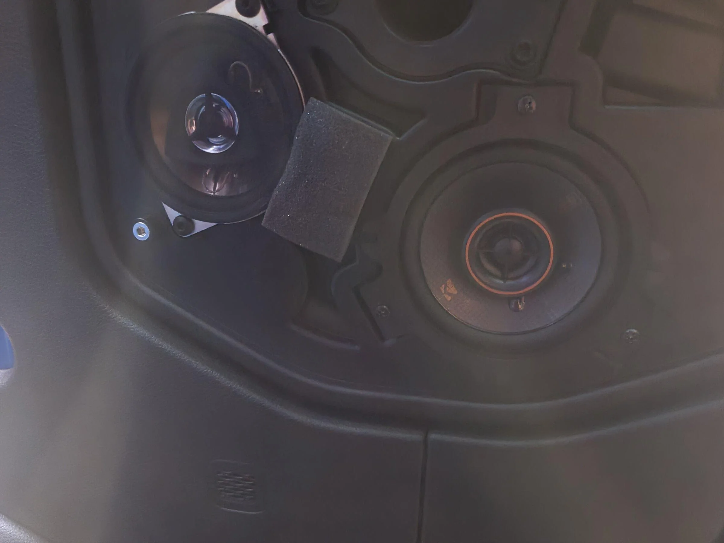

I just replaced the existing 4" & 3.5" speakers with Kicker 77KICK25AB (3.5") and 47KSC404 (4"). I was pretty happy with the factory Alpines other than they just weren't loud enough with the top off. These do the trick and add quite a bit of high end as well. I am currently waiting on a pair of the Terra Acoustic dash replacements which, according to their latest email, should be available soon. I may do 6.5's in the kick panel but that will depend on what everything sounds like once I get my sub installed. Pic quality is pretty bad...but that's what the replacements look like.
Just want to take a moment to express my gratitude and thank you for sharing this. Sure enough, I ordered the same exact speakers and did this install, absolutely PERFECT!!! Thank you so much!!
