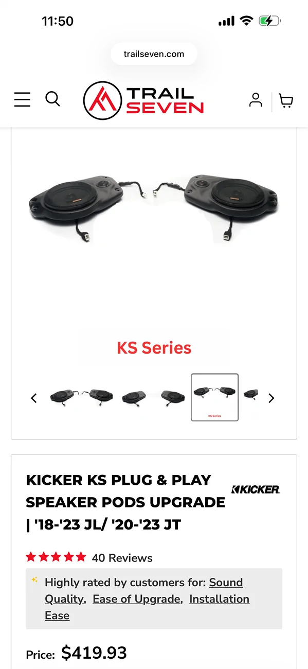

Has anyone replaced their soundbar speakers with these? If so what’s your thoughts. I have the factory premium Alpine.
Jeep Gladiator Kicker speaker upgrade in the roll bar IMG_5785

I have. Makes a much richer sound stage and a modest volume increase. Not sure what you're looking for...I also replaced the dash tweeters with their KS. Good all around upgrade if a bit pricey
I have them in my 22 Rubicon along with better dash speakers but I haven't changed the kick panel speakers. With the top and doors on the improvement is very noticable but it didn't make much difference for me when they are off. Having said that, I'm 58 with bad hearing so it might be better for you. I believe the only thing that will help for me is more power and I haven't bothered with a better amp.

I have did complete system upgrades on 3 gladiators and 100% if change out all the speakers (knee,dash,soundbar) and amplify all the volume levels and sound quality is a great improvement over even the alpine.
On my sound bar and the new lower dash knee pods I did add sound deadening material and poly fill as well as tesa tape to all harnesses inside the sound bar to prevent noise.

I did the complete KS package from Trail Seven. Initially I opted for the 6.5 speakers in the knee panels but honestly the sound was worse than the factory Alpine speakers that came in the truck. Come to find out, the factory sub doesn't have enough power to support the 6.5" speakers and the upgraded overhead speakers and dash speakers. I replaced the 6.5" speakers with the KS 4" speakers and the sound dramatically improved but even then, I wasn't overly impressed. It's better than the factory alpine setup but not by much. Not sure which route to go because most options that sound better require a different amp but you lose the factory subwoofer. Since I use my underseat tray for storage, my options are more limited until someone can come up with a new subwoofer that fits into the same space as the factory. MB Quart was on my list but I'm not ready to give up my storage tray yet.

For clarity, I think you'll see some improvement. Volume is not likely going to increase, if it does it won't be much. You'll need an amplifier to get the volume up. I'm an old school audio nerd who swore i was not going to mess with the stereo in my gladiator. That lasted about a year, now the only factory audio item from my alpine factory system left is the dash screen. 😁. YMMV of course.
You can't expect the crappy OEM amp to magically output MORE power, definitely not 30w per channel more power. Get rid of the crappy oem stuff and do it right. Expecting aftermarket speakers that require 10x the rms wattage to perform AT ALL on 3 watts is absurd. Remove the OEM sub, and mount an amp on the back wall. Those 6.5" knee and soundbar speakers will outperform the stock sub when amped and tuned properly.
You wouldn't buy a civic, then expect it to tow a boat and still get 35mpg.

A more efficient aftermarket speaker can play a little louder. I’m not sure if the sensitivity difference between the two, but it’s definitely possible.
