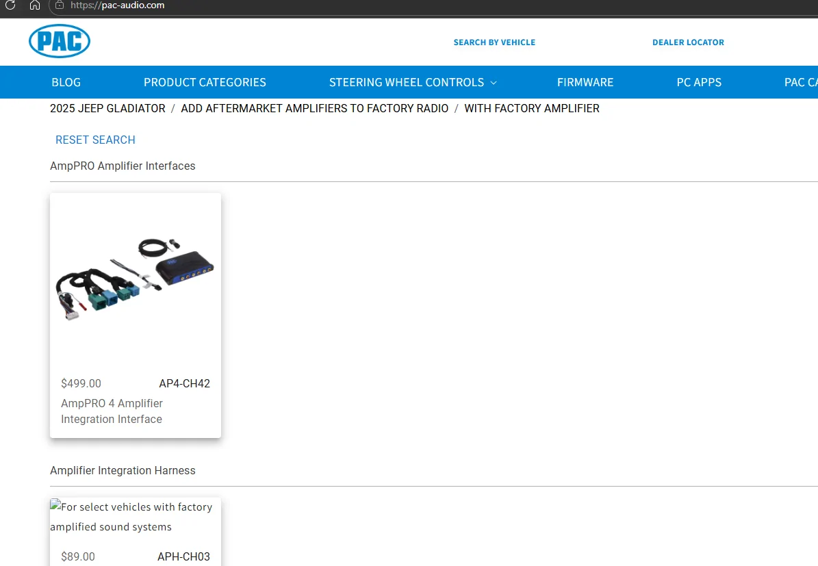

Yes, I went through the same thing when i did my 25 gladiator and about to do the same with the wifes 26 wrangler with alpine factory system.
Half of the online sites said use this, don't use that etc.. So referred to PAC themselves.
Thanks for the heads up. I will see if I can swap these out right away.
