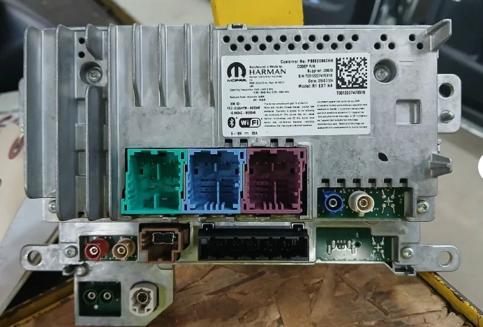

You will need the APH-CH03 in conjunction with the AP4-CH42-R2.
The 41 radio harness is for the 2023 and down and will not plug into the uconnect 5. Just trying to save you a delay at the installer.
Uconnect 5 radio and associated PAC module 42 below.
Shows that one doesn't fit? I have the premium alpine with sub?
