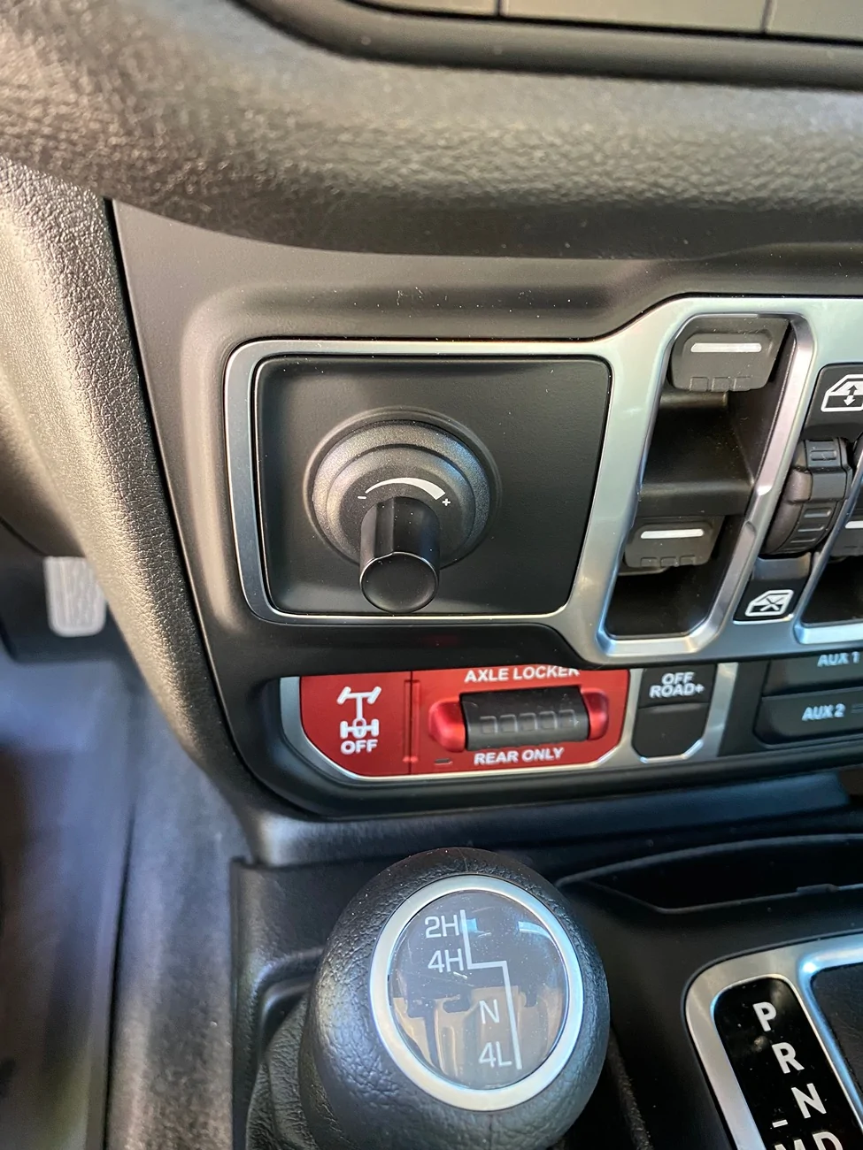

That shiii looks clean man! Love the bass knob location, would do the same possibly in mine. Since you used components AND 3.5s in the dash, how was tuning the front/rear since the 3.5s are rated a bit lower than the 6.5/6.75s on wattage and ohms (either 2 or 8ohm front and 4ohm rear being amped on the same amp)?

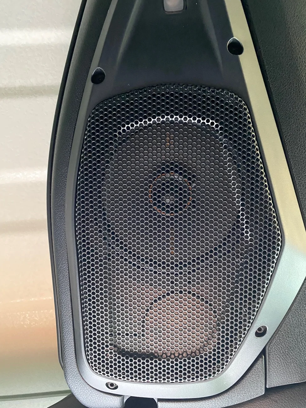

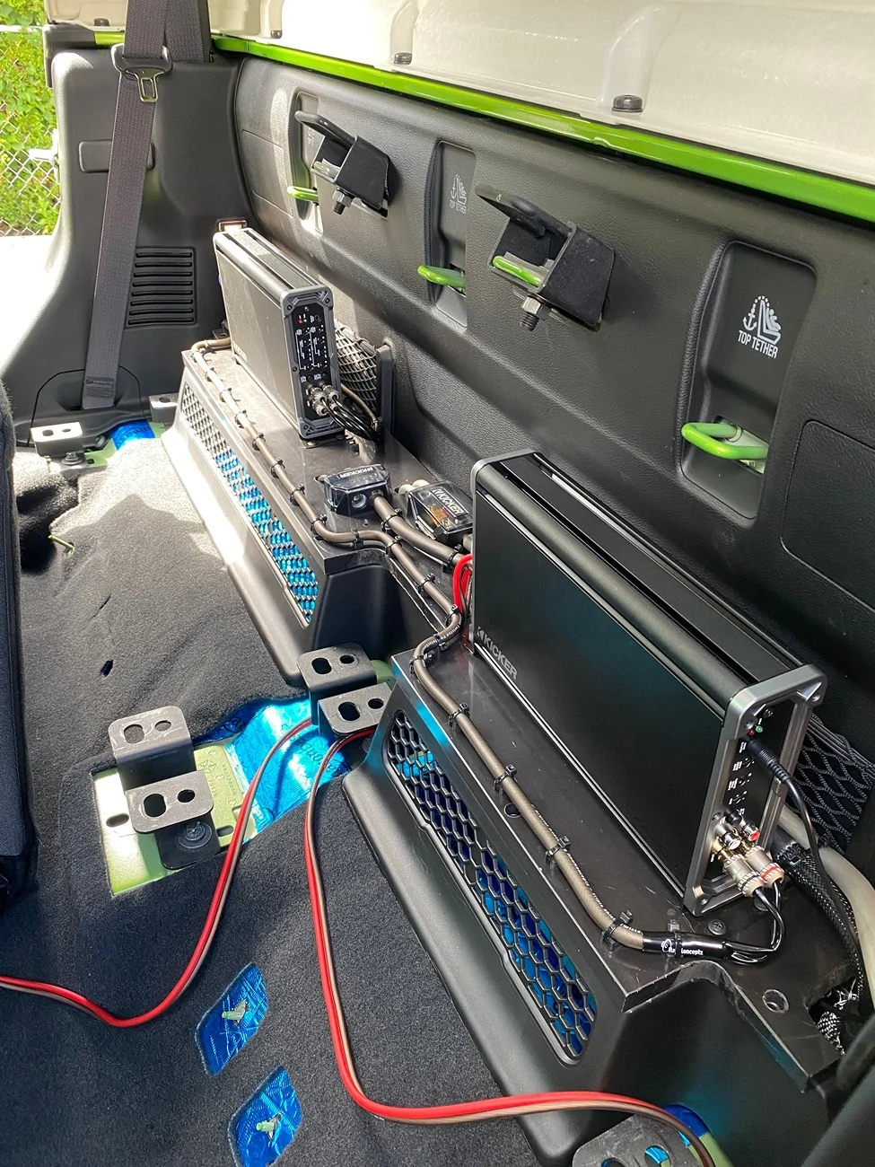

I am running the lower knee speakers and the dash off of channels 1 & 2 parallel @2 ohms. And the rear sound bar which has 6.75 coaxial on channel 3 & 4@ 4 ohms . The cxa360.4 has no problems doesn’t get hot no issues.

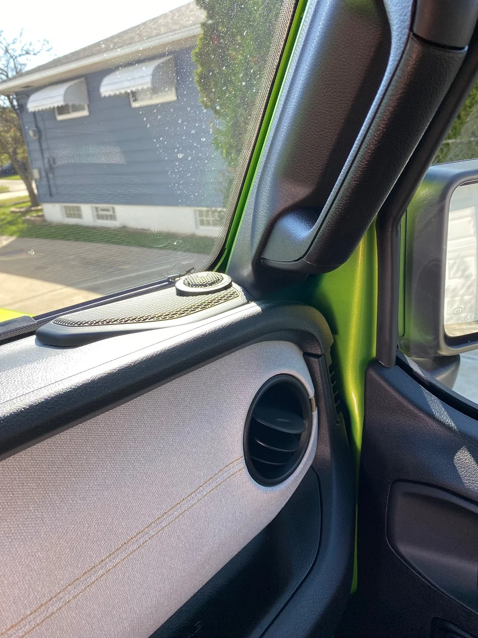

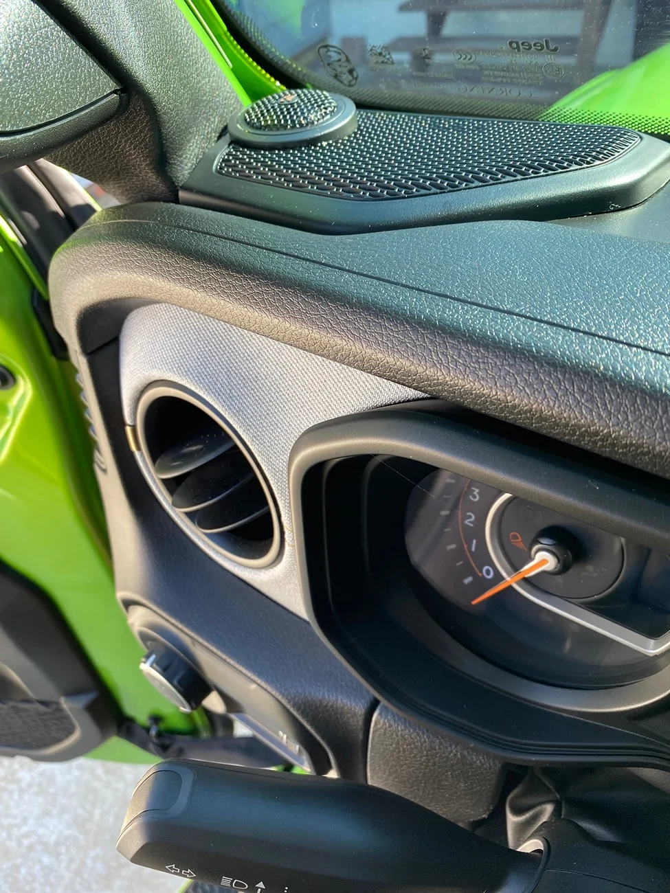

I contemplated 3 way components but decided to try it this way with the 3.5 Ks coaxial running a passive crossover ( bass blockers) to filter out unwanted lows to them while keeping good mids going to the knee 6.5 component mids. Plus running just a tweeter up top with low downward angle of the mids in the knee makes the imaging awkward.
The tweeter placement was played around with, lower dash, a-pillar etc. I finalized my decision after down low was still awkward to my ears, a pillar more direct facing to bright. Was i concerned about weird imaging.. yes, but this seemed to be a good blend and no issues.
I figured if I didn’t like it I would do a 3 way component set.

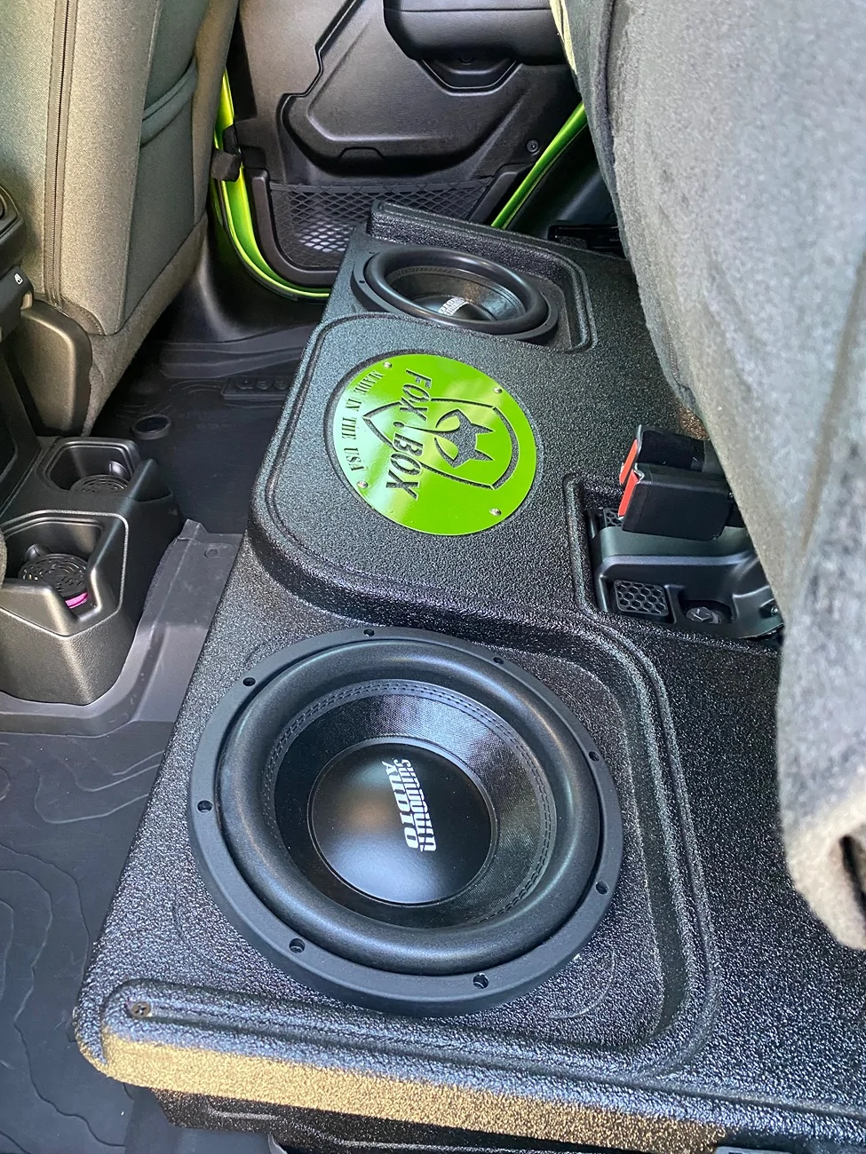

For the subs in my wifes I had the single 10 box with same sundown audio subwoofer rated 750 rms with kicker 800.1 running 2 ohm 600 rms. The single 10 box is also up firing.
In my gladiator I have the two 10” sundown subs up firing rated same 750rms each on kicker 1200.1 . The single was plenty loud and I could have stayed with that setup in mine but wanted to try the dual 10”s . It is more than I needed honestly.
I have had down firing setups in other trucks and like them, but with the seat bottoms down , it sub loads them and makes a remarkable difference in output.
With doors off or open and seat bottoms down it flat out boogie’s.

1) I am running the lower knee speakers and the dash off of channels 1 & 2 parallel @2 ohms. And the rear sound bar which has 6.75 coaxial on channel 3 & 4@ 4 ohms . The cxa360.4 has no problems doesn’t get hot no issues.
2) I contemplated 3 way components but decided to try it this way with the 3.5 Ks coaxial running a passive crossover ( bass blockers) to filter out unwanted lows to them while keeping good mids going to the knee 6.5 component mids. Plus running just a tweeter up top with low downward angle of the mids in the knee makes the imaging awkward.
3) For the subs in my wifes I had the single 10 box with same sundown audio subwoofer rated 750 rms with kicker 800.1 running 2 ohm 600 rms. The single 10 box is also up firing.
4) I have had down firing setups in other trucks and like them, but with the seat bottoms down , it sub loads them and makes a remarkable difference in output.

Most 4ch amps can be run in 3 channel mode, bridging 2 channels to run a sub and running the other 2 in stereo to a pair of speakers. Bridging and running a single channel to a 4 ohm load is the same as running stereo at 2 ohms. Every system running a 3 channel setup is effectively doing exactly what he's doing with 2 channels seeing 4 ohm loads and the other 2 seeing 2 ohms. Not sure how or why it would damage the amp or the speakers unless the 2 ohm output was too high for the speakers.
I actually asked Kicker about this when I called, because I too remember that some amps will allow bridging, but normally that means going from a 4ch to a 2ch as seen here
"Power:
(@14.4V, <1%THD+N) 4Ω Stereo 65W x 4 Power
(@14.4V, <1%THD+N) 2Ω Stereo 90W x 4 Power
(@14.4V, <1%THD+N) 4Ω Bridged 180W x 2 Lowest Rated Impedance (Amp 1 & 2) 2Ω Stereo / 4Ω Bridged"
Notice how you CAN run EITHER 4ch@2ohm OR 4ch@4ohm OR 2ch@2ohm OR 2ch@4ohm, but not 4ch@ 2ohm AND 4ohm simultaneously. Kicker confirmed (with their amps anyways) that only their LX1300.7 is designed for a split speaker setup and why they have a 3rd full range speaker/tweeter amp at a lower rms output while working at a different load, similar to how the sub channel/amp can run at 1ohm while speakers are at 2/4ohm (speaker amps 1/2 at same load).
So CAN you run them at different loads, apparently. Should you, or is the amp designed to...according to Kicker for their amps, generally NO. Maybe I'll call during the week and double check, because I've been misinformed before 🤷‍♂️
