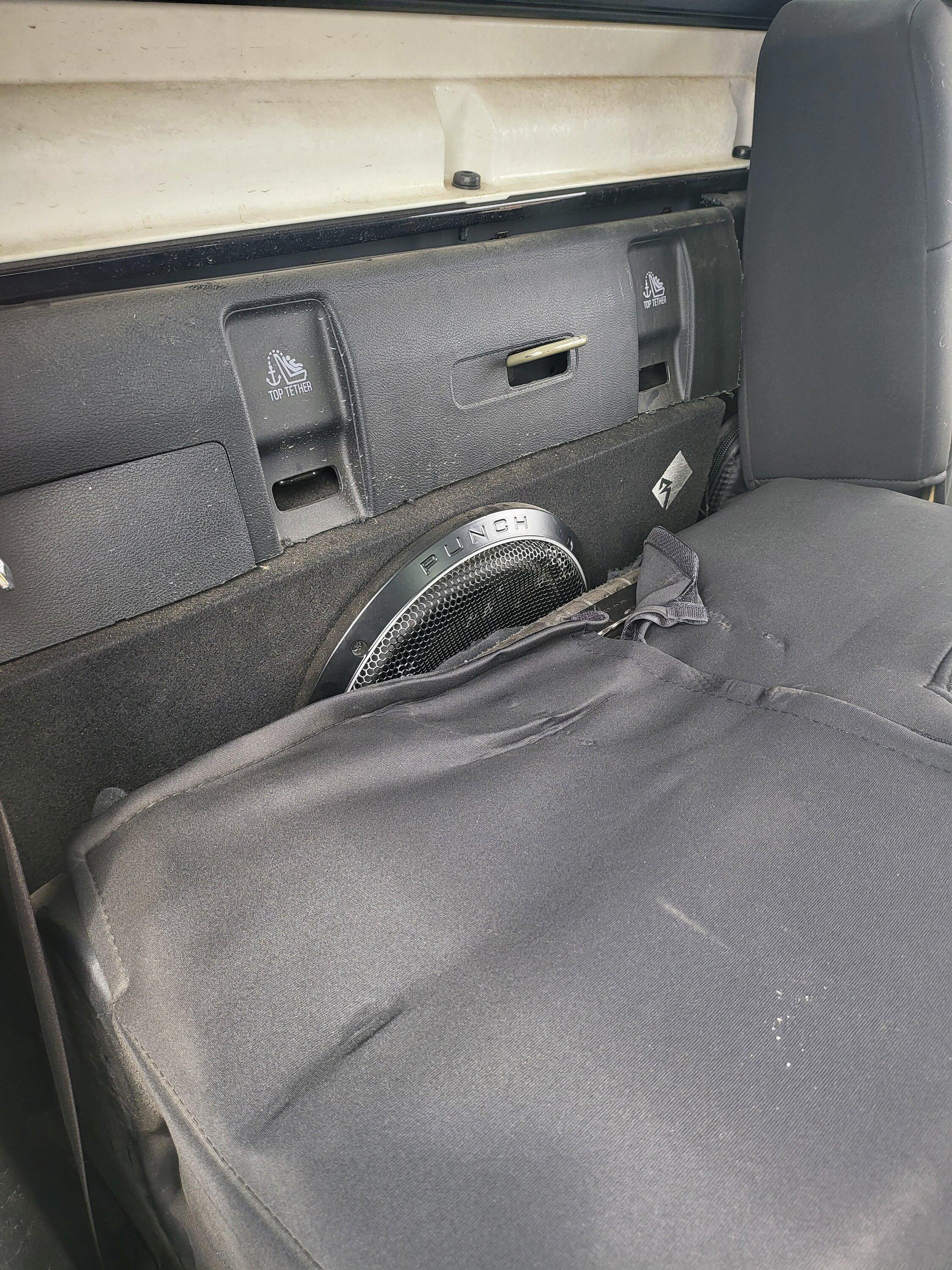

I did the mb Quart 6x9 kit as well. Huge difference. I had blown the oem speakers...lol. my volume only has 1 setting...max. I also scrapped the oem subwoofer and fit a punch prime p3 12 behind the passenger rear seat. It required cutting the plastics and removing the rear center seatbelt.

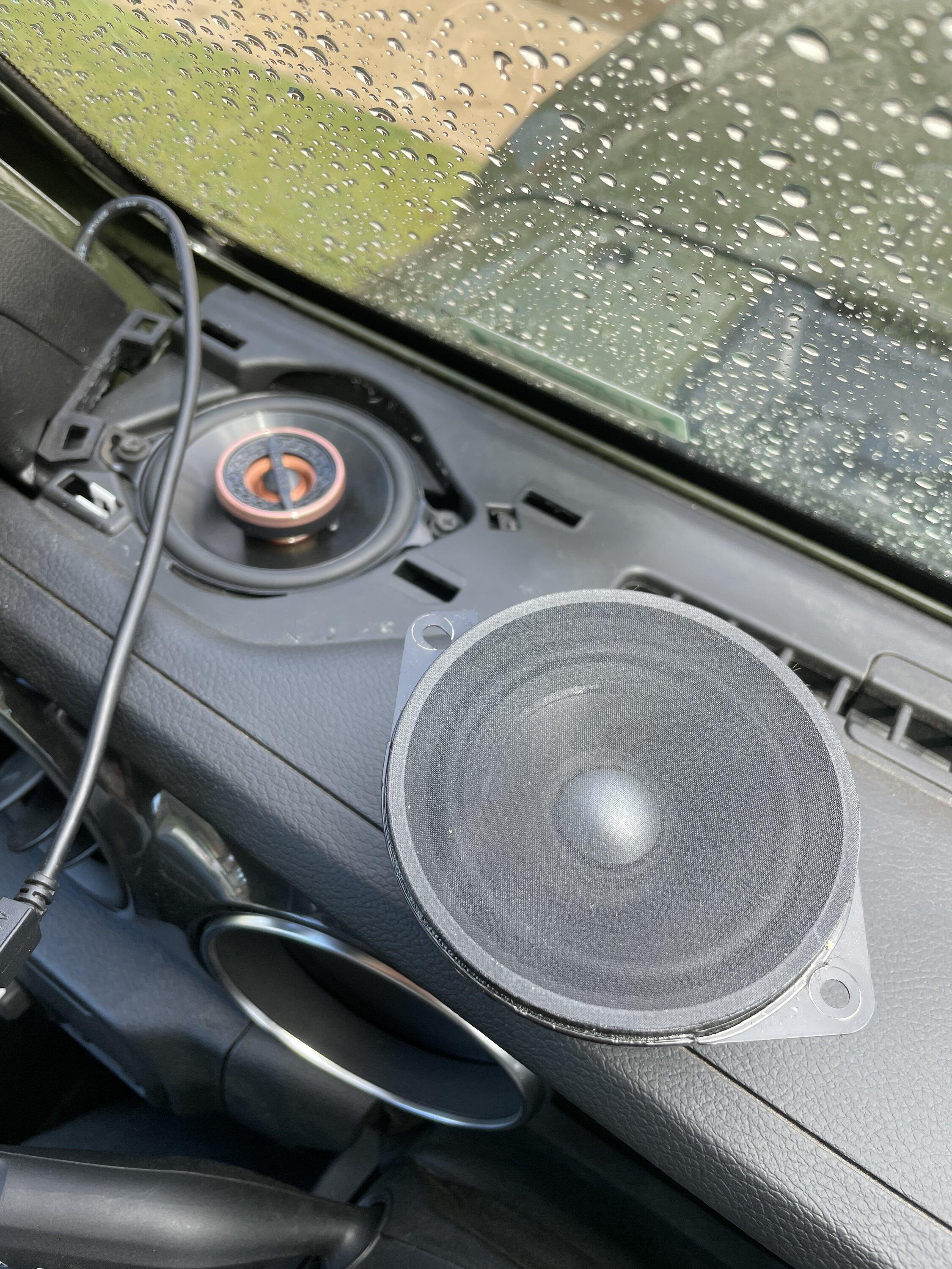

Did you do the front dash speakers already? Inhave the Alpine “upgrade” also. For bit over $50 Can do the infinity upgrade in dash. I did it a bit ago makes a massive improvement in range. Music becomes much more detailed. Takes 20 minutes to swap them out.

Agreed! I just replaced my dash speakers with the Infinity 3032cfx as well and am very happy. They are on sale now at Crutchfield and I highly recommend them.

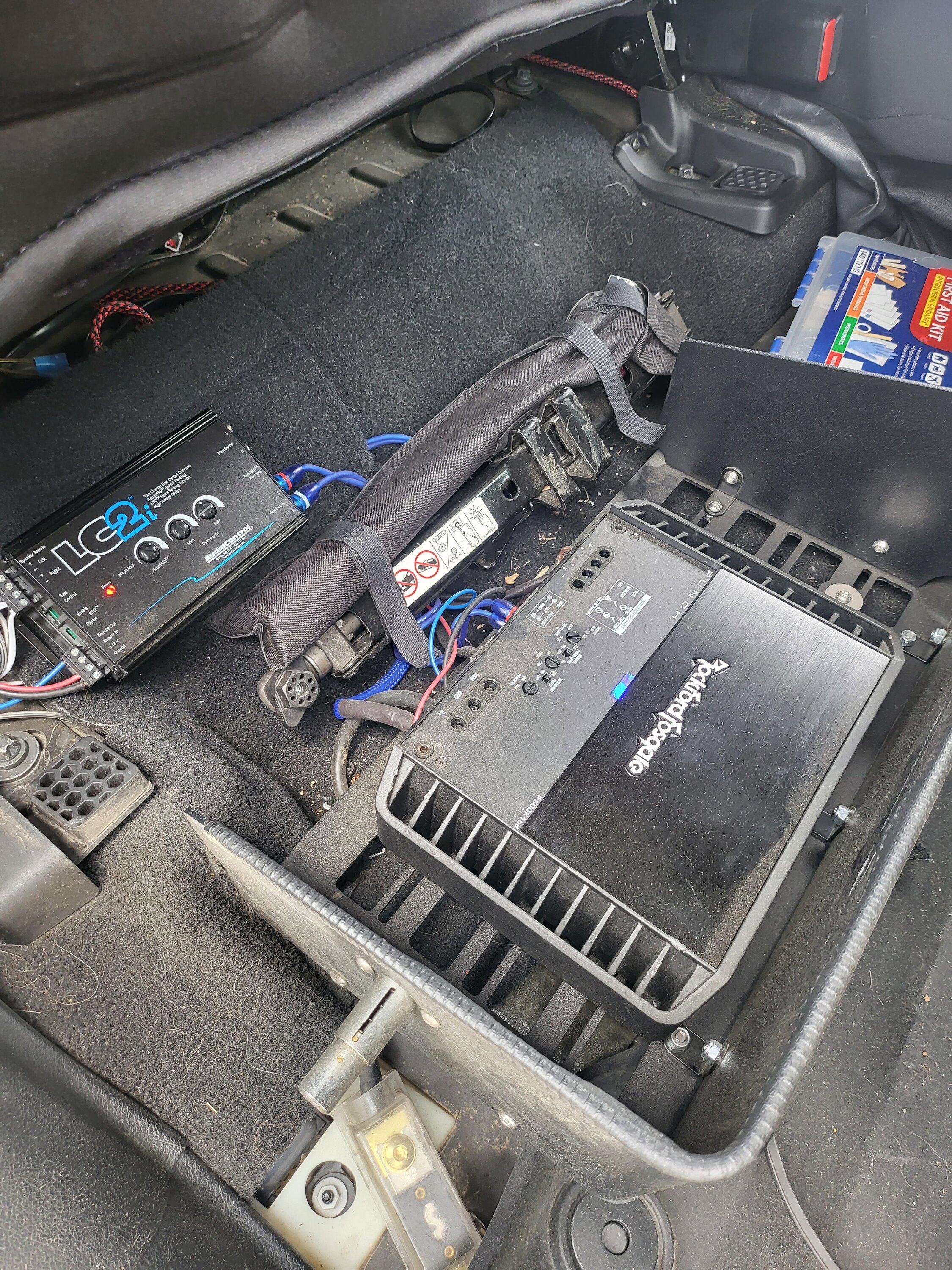

Sounds fantastic, I have been using that sub/amp combo for years. I need to fix that clip in the top right. I never fold that seat down, didn't realize it popped out. Had to cut the center seatbelt out to make it work. For my diesel gobi that is coming, I am going with the JL 10s in the fiberglass box. This install took a while...

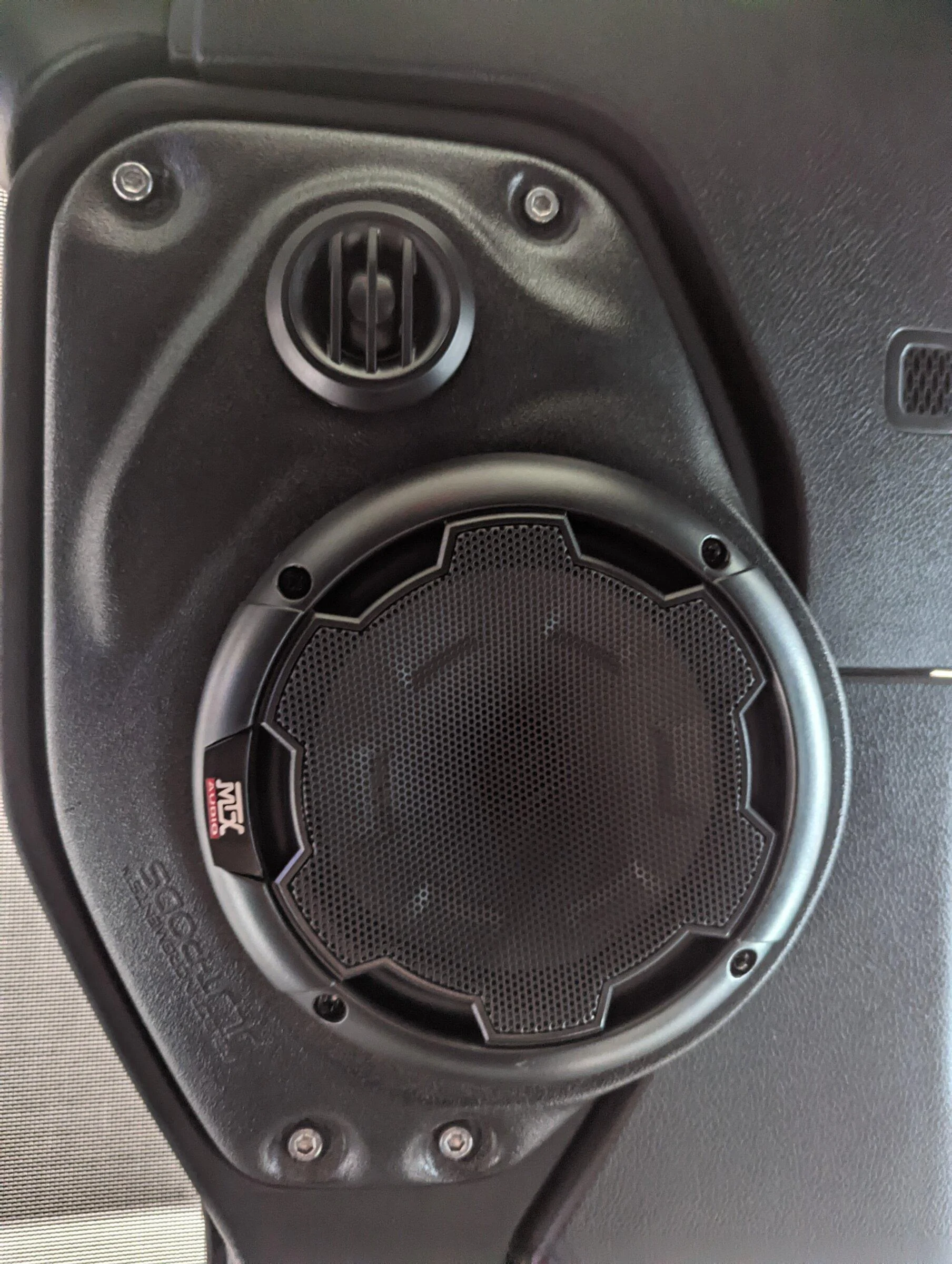

I upgraded to these 6.5" MTX component speakers using the JL-JT pods. Because you have the Alpine upgrade, the factory setup already splits the signal for the tweeter and woofer components and you do NOT have to use the included crossovers. Total cost was about $350 and they sound great. Much more bass. They do hang down much lower than the original grills but they do NOT block the rear passenger's view forward and they look really good. Of course, you could go with less expensive speakers.
Speakers: https://www.crutchfield.com/S-oYvcb...GNbvd6F4ocHE1XafFYh9vv1HG-0SP01xoCx7EQAvD_BwE
Pods: https://www.crutchfield.com/p_6633JLJTAE/Select-Increments-JLJT-Pods.html
Note: adding more oomph to the soundbar will bring the soundstage backward. I had to upgrade the upper dash speakers to "brighter" Infinity units (super easy installation) to correct for that. I also did the knee panel speakers, meaning that I have upgraded every speaker except for the factory subwoofer. The system sounds excellent.

Hi, I really like the look of these MTX's, So you mentioned that you do not have to use the included crossovers, you just used the supplied Metra wire harness for plug n play and would you say that you get a nice thump of bass compared to stock?

Yes, the factory Alpine system already splits the signal into "woofer" and "tweeter" for the stock 4" and 3.5" speakers, respectively. The MTX speakers hook right up with the supplied harnesses (from Crutchfield) such that what was going to the 4" speaker now goes to the 6.5" speaker, and what was going to the 3.5" speaker now goes to the MTX component tweeter. It works great. The bass response is tight and strong and the highs are crisp.
The issue here is that these are so much larger than the ones they replace--and hang so much lower--that the soundstage is effectively moved even more rearward in the vehicle. I bought those Terra Acoustic speakers for the dash corners, but they are less efficient and, mixed with these, it seems like almost all the sound is coming from behind my head. Therefore, I took out the Terra Acoustics and put some very "bright" Infinity 3032's in the dash corners to make up for this to some extent, which helps, but with the way the MTX speakers in the pods hang down, they're literally right behind your head. They sound great but I am trying to figure out how to bring the soundstage forward without having to add an amp.
