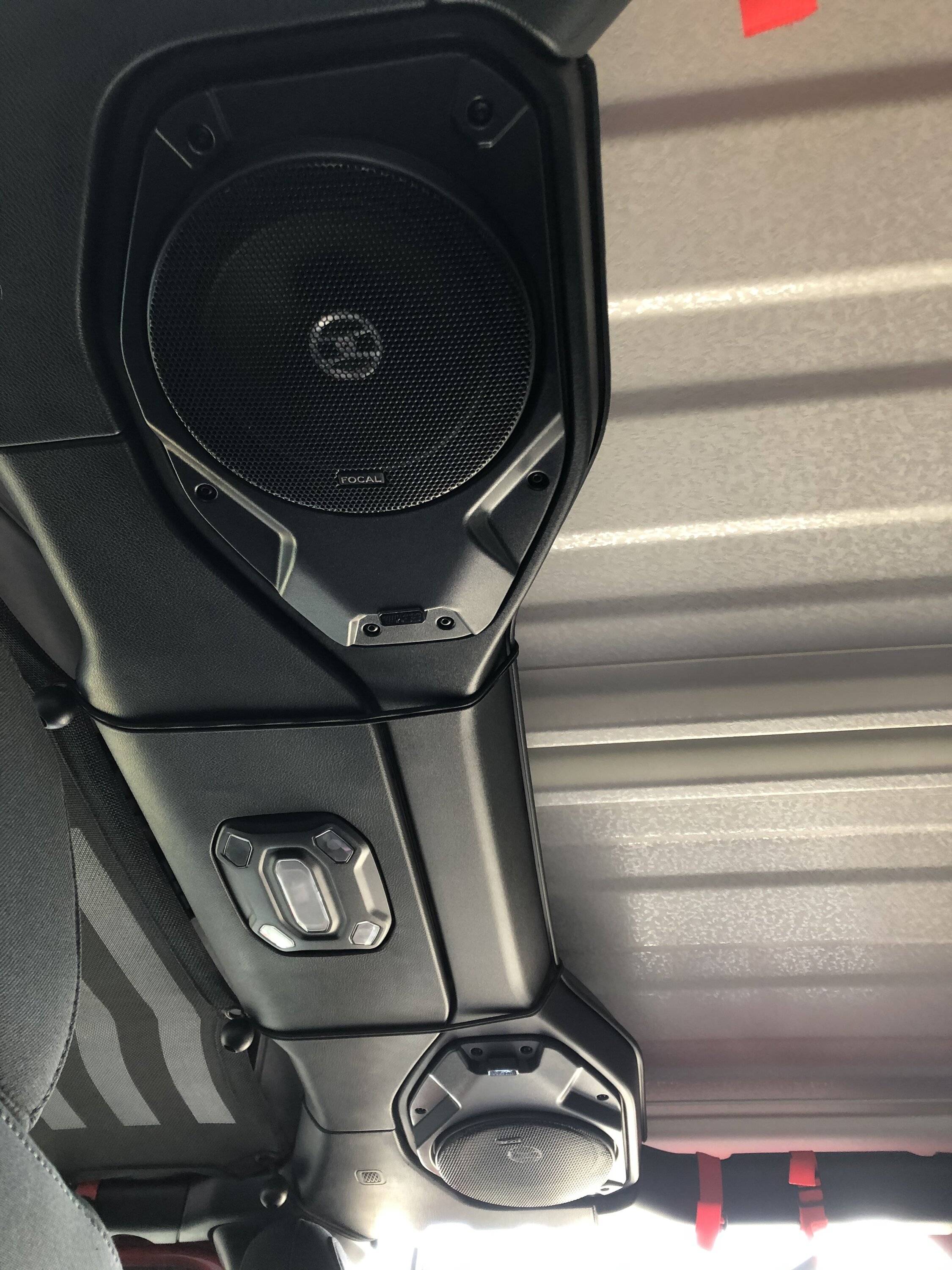

What speakers do you all recommend for replacing the roll bar speakers? Preferably something I don’t have to cut away sheet metal or anything. I’ve got a Stinger Heigh10 radio and also don’t want to add an amp. Thanks!!
I installed some 6" Focal speakers. Bought adapters online. Great sound
