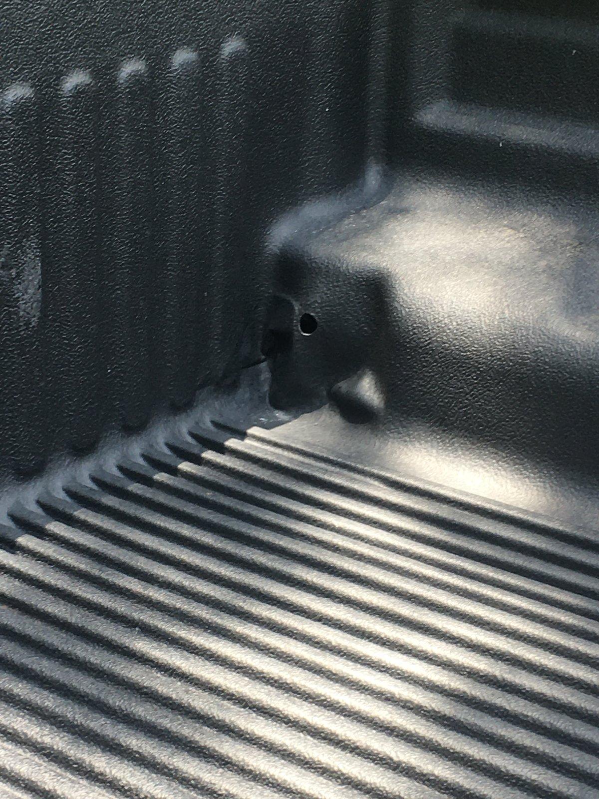

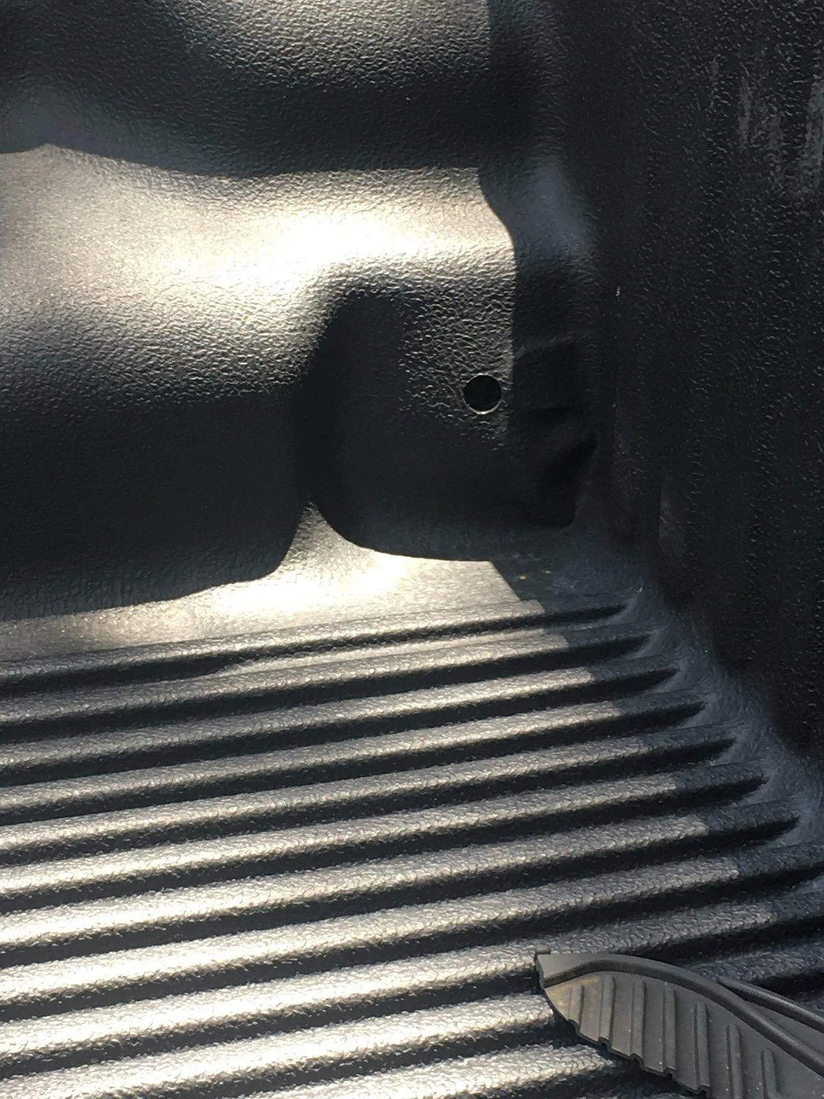

Sport package came with factory bedliner. There are two small hole openings on each side. I can feel a bolt in there but don’t know if there are cargo hooks behind it. I would hate to cut a circle around those holes for nothing?

Where is this your looking and why cutting holes?
How hard is it to lift up or remove the bedliner? Mine came with the factory spray-in bedliner. I have a tie down loop in each corner.

The holes are for your forward tie-down loops to bolt through.
Lift the drop-in liner out to see if the loops are under.

Wow, someone half-assed that install. They should have removed the forward tie-down hooks as @kevman65 mentioned and reinstalled them after the liner was in place. The tie-down bolt mounts through that hole and is assumed to help hold the liner in place.
If you want to fix it yourself, the liner is likely too stiff on that end so you'll need to pop it loose toward the tailgate, pinch it inward, and slide it rearward about a foot to pull them off. I think it's a T-40 bit. Then reinstall your liner and then reinstall the tie-downs.
Otherwise you have every justification to make them redo it correctly if you don't want to or aren't comfortable doing it yourself.

Thanks for all the feedback guys. Much appreciated.
I will take it back to the dealership and have them do it.
