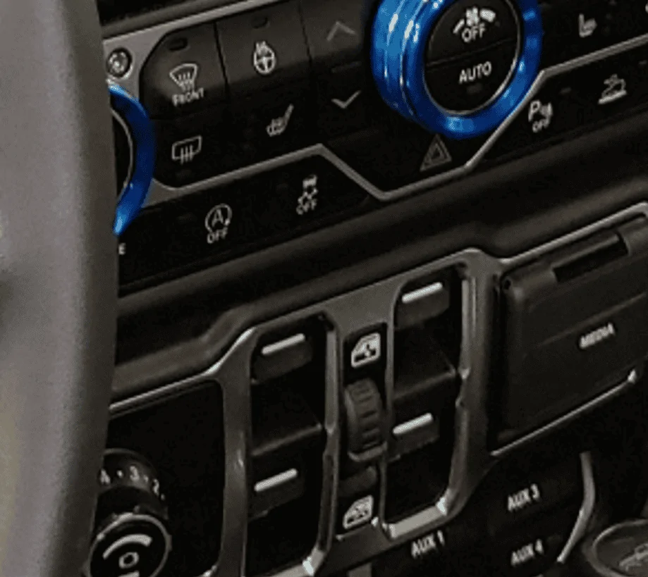

Yes, I've been in contact with the seller, and it seems like everyone sources their modules from the same factory in China. The only difference is that they install the Jeep "plug n play" connector to the regular wiring.
They recently released a "hybrid" version, but most sellers are just resellers. The seller I've been talking to reached out to the factory, and they simply replied, "hybrid version for that "car" which isn't very clear. They asked for a photo of the center console. It seems that the gas Jeep has "AUTO" on the two upper buttons, the JK has it too but with different buttons, and the 4XE has the same JL buttons but without any "AUTO" mark.

Not sure what you mean by they install the plug and play connector to the regular wiring.
Which regular wiring, and they should all have a connector to plug into the switch array.
They should all simply be - unplug factory harness from switches, connect new module connector to switches, and connect other connector to the factory harness - done (unless you want the fancy fob operation.
There's no difference in the 4xe wiring vs. the gas JT/JL wiring other than switch appearance, maybe.
This is the 4xe - (OUR 4xe). The switches are exactly like a standard JLU or Gladiator ->

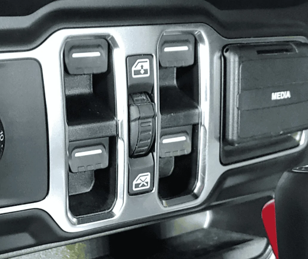

And (drum roll, please!)............................ this is my 2020 GLADIATOR -
Jeep Gladiator FINALLY Automatic UP/DOWN ALL windows! 1718891446725-bf

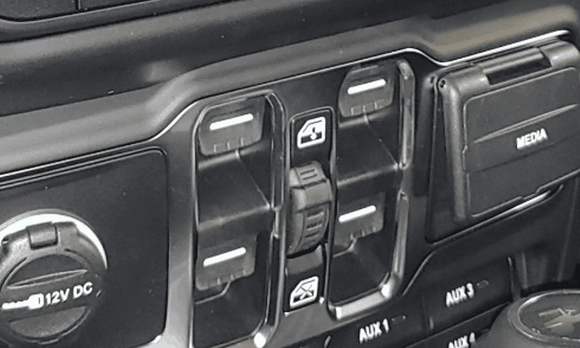

More drum roll, please................... this is my 2022 Gladiator. Hmm, still the same as the 2023 JLU 4xe ->
Jeep Gladiator FINALLY Automatic UP/DOWN ALL windows! 1718891534514-t8
So, where's the difference?
As we can see, the switches are identical between a 2023 JLU Rubicon 4xe, a 2020 Gladiator 3.6 and a 2022 Gladiator 3.6
They make no sense at all when they try to differentiate.

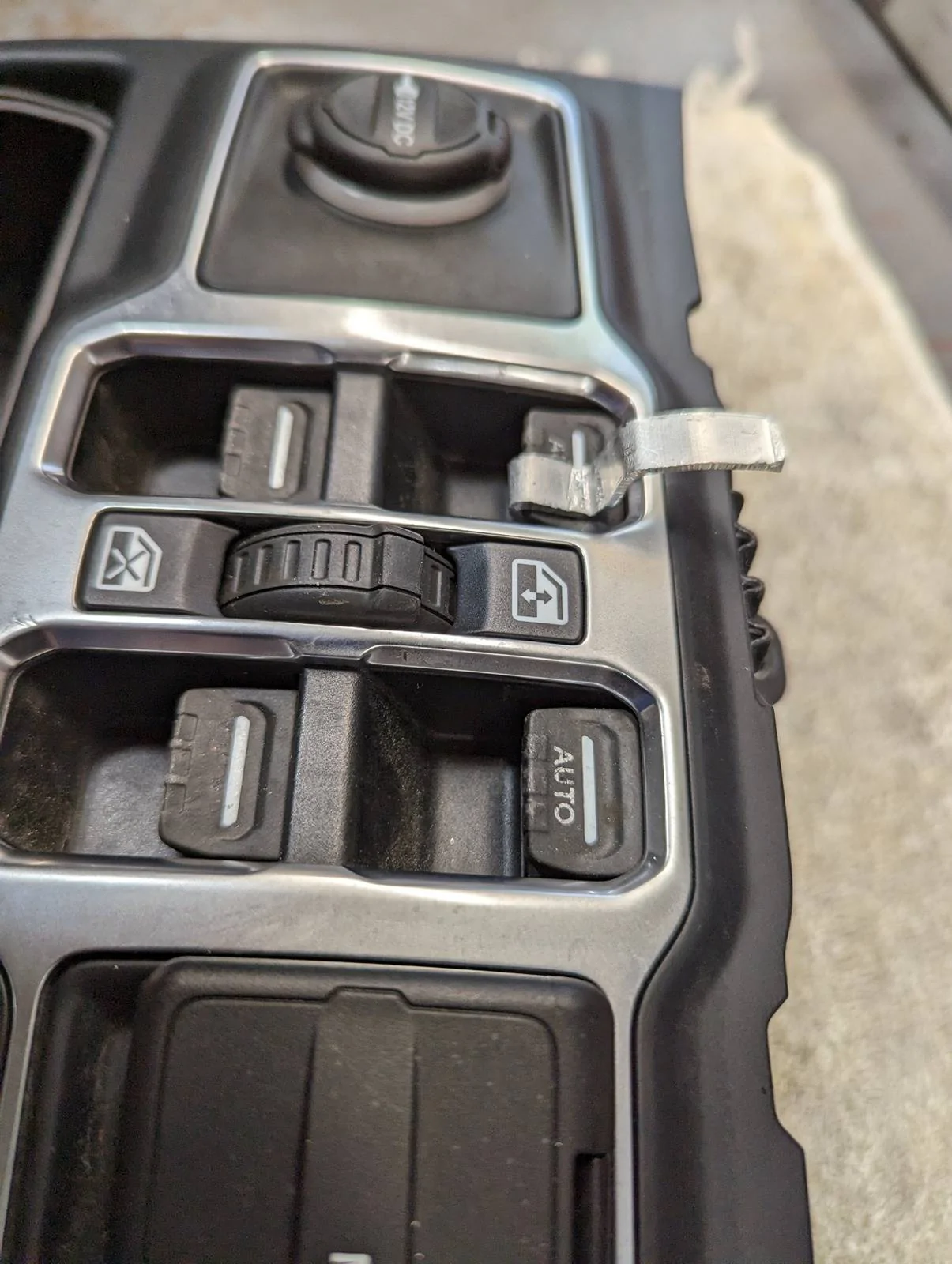

I even bought a spare set of switches on eBay out of a gas Wrangler (JLU) to experiment with changing the switch levers for my wife - identical to the 4xe and the JTs with one exception - the older JLU switches are marked automatic. Otherwise, they are identical.
The seller said he pulled the switches from a trashed JLU. Can't recall the year, but here they are - so I would maybe speculate that the difference is in the years - that they stopped putting automatic on the top switches??
