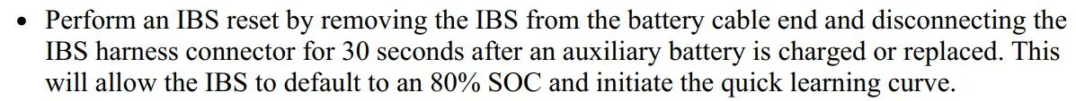

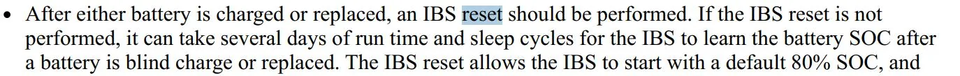

The 14.7 can be normal in colder weather. Mine is running that now, even with fully charged batteries and ESS working.
But the REAL voltage to be concerned about is when it's NOT running, and use a volt meter, not the cluster.
Of course there are other reasons for ESS to fail..........but depending on use, he's getting out there on battery age.
Unplugging the IBS from the 2 wire LIN connector by itself won't reset it...........
