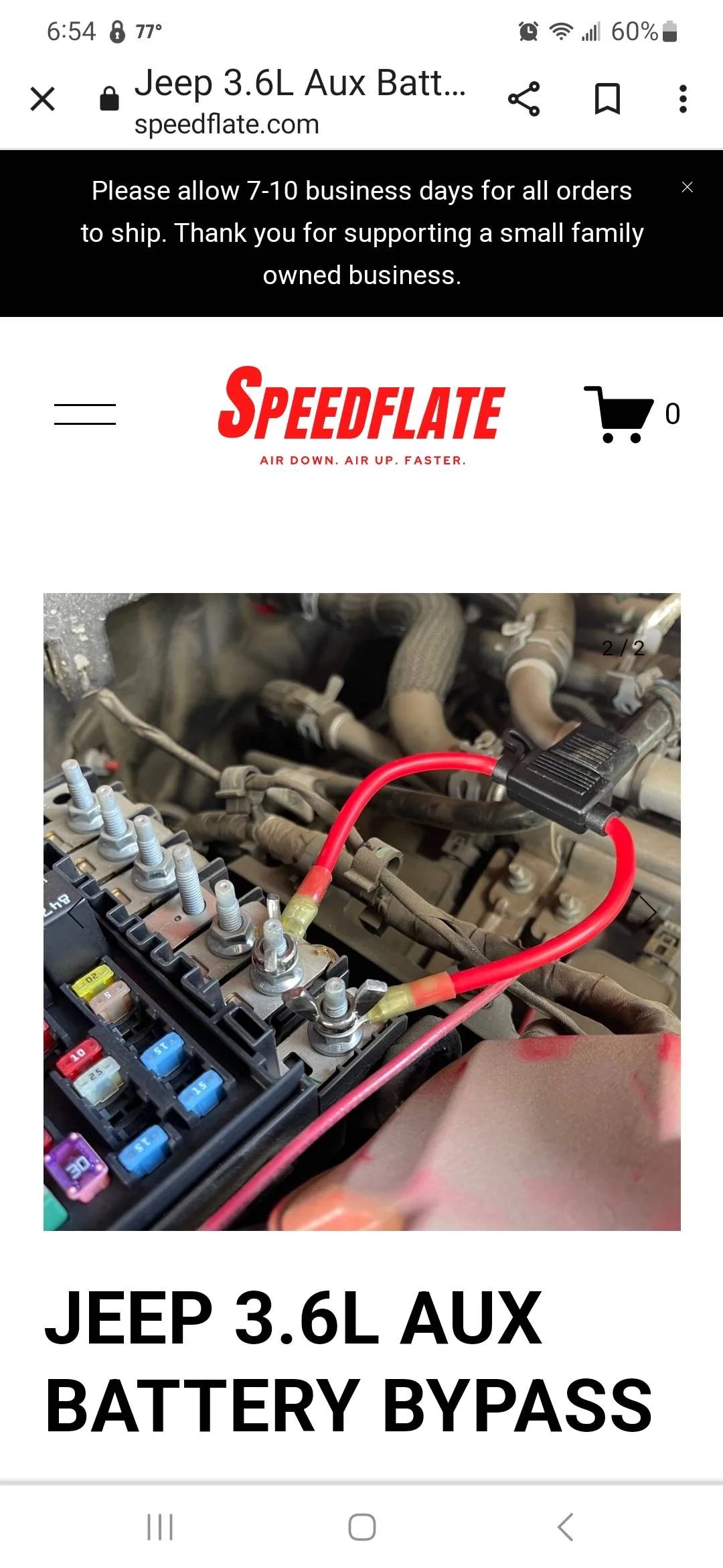

Pulling fuse 42 is a better way to achieve the same results, preventing the electrical separation of the batteries. https://www.jeepgladiatorforum.com/forum/threads/jumperless-aux-battery-pcr-bypass.59836/post-984922
This is exactly what I did - pulled the fuse and then also removed the negative cable from the main battery that goes to the Aux battery.
Did this because the Aux battery was killing my brand new main battery. Also have disabled auto stop/start of course. IMHO, this is not a well designed system and totally unnecessary for how and where I drive.

Its been proven that you can just install one high quality battery, run the leads from aux up to the main, and call it good. ESS will function if you want it to no errors and your voltage is stabilized.
The ESS dual battery junk would be fine if small batteries were manufactured like they were 20 years ago. THEY ARE NOT. I have had 2 of these and both killed the aux batteries which caused the main to fail. To add to this the aux battery is the same battery my 2022 harley pan america uses and guess what? It too failed.
The issue is not the engineering or theory of the system its the lack of quality small battery manufacturers. The engineers assume the spec sheet on the battery will be what it can do for its life. Well they degrade faster than expected and cause TONS of electrical issues.
Also the shutting the alternator off all the time so the battery is playing discharge recharge was a pretty silly idea as we have managed 100 years of automotive use without doing that :).
