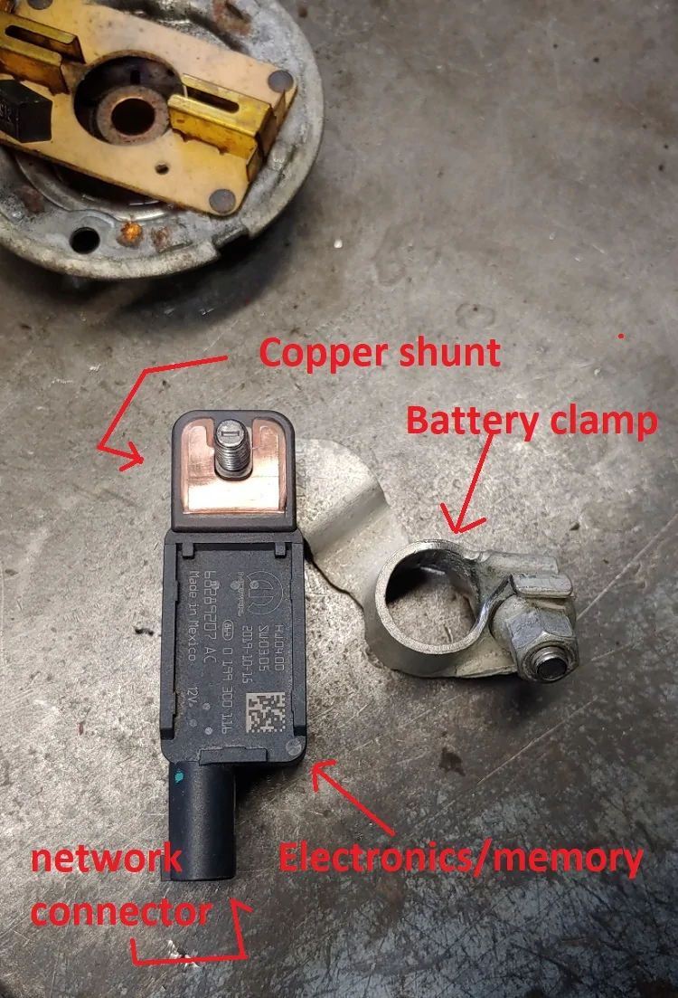

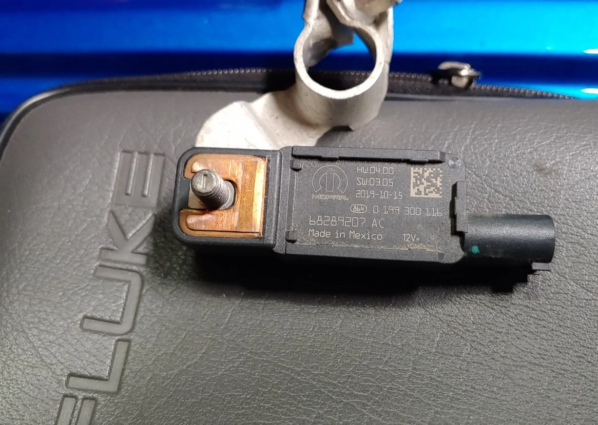

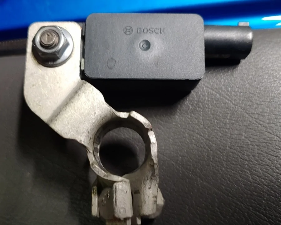

Very much appreciated and many thanks. Final question, the IBS has a wire connected on the firewall end, is this disconnected also from the IBS & if so, how is this accomplished? Twist & pull or is there a clip?
40,493
54,047
The IBS network connection is two wires - there's a clip you press and it simply unplugs - pulls apart.
