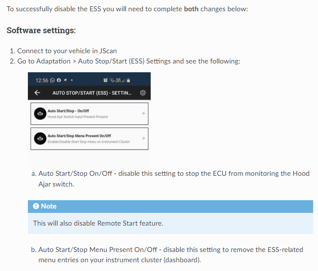

This is what I read:
  1. Connect to your vehicle in JScan.
  2. Go to Adaptation > Auto Stop/Start (ESS) Settings and see the following: Auto Start/Stop On/Off - disable this setting to stop the ECU from monitoring the Hood Ajar switch. Note. This will also disable Remote Start feature. ...
  3. Disconnect JScan.
  4. Turn the vehicle OFF.
https://jscan-docs.readthedocs.io › j...
Jeep — jscan-doc
Thanks man. Just found it. The only thing I don't like is by diabling both settings the Remote Start will not work. Or am I reading it wrong?
