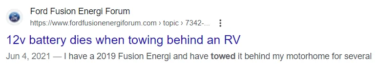

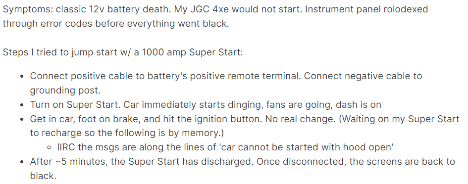

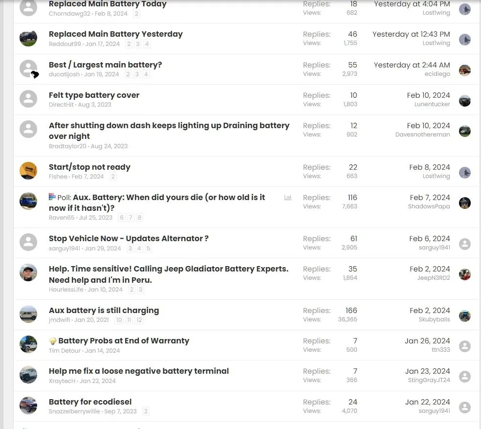

Really? You don't know? Look around at forums for other cars. See if you can find one with a "Battery" section like we have.
Jeep Gladiator Peace of mind at last!  Replaced main battery with a premium H7/Group 94 battery battery problems
Then there's this: https://www.jeepgladiatorforum.com/...teries-and-charging-system.75512/post-1231320
Throw in the the RV forums always have someone asking why their Jeep will not start after towing it all day.
Then add in that my 2020 JLU had the battteries replaced under warrenty. It only took 4 visits over 6 months wiht the kicker being a complaint to the owner of the dealership.
Now my Gladiator has 1 battery, no auto stop/start, and the readings on the vehicle voltmeter actually provide clues to battery condition.
Throw in the the RV forums always have someone asking why there Jeep will not start after towing it all day.
Thanks for asking. :)
Unrelated to ESS - it's related to how things are being towed, not understanding, like most electrical system "issues" are - total lack of understanding.
Don't get me wrong - I'm all for putting in the largest capability battery one can fit in there, and do realize the Jeep supplied batteries, well, putting it nicely - leave a lot to be desired (would I go to Jeep to buy a replacement? Uh, no........ I'd hit Walmart or NAPA or one of the top battery brands)
But the towing bit? Different animal.

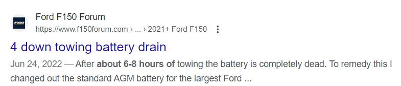

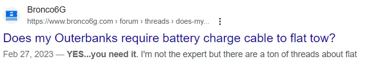

But you did have a clue in there - lack of understanding modern vehicles in general, not just Jeeps.
Why are forums, RV forums especially, filled with "My Jeep battery went dead"?
It's because Jeep is the most commonly towed vehicle, not because it's the one having problems. It's sheer numbers. Of all of the flat tows I see on I80 and I35, over 3/4 are Jeeps so of course you find Jeep as the topic of discussion.
And then.... Owners don't dig deep and learn or seek information before just hooking stuff up, jumping in and going and in the end, if they have a dead battery because they didn't educate themselves on such things, it's worse when they don't understand how to jump and what's involved with a dead battery.
If you are going to do technical things - and towing, especially flat towing, is technical, then learn. It's not like 1970.
The Chevy and Ford forums have plenty of "dead battery after towing" posts.
