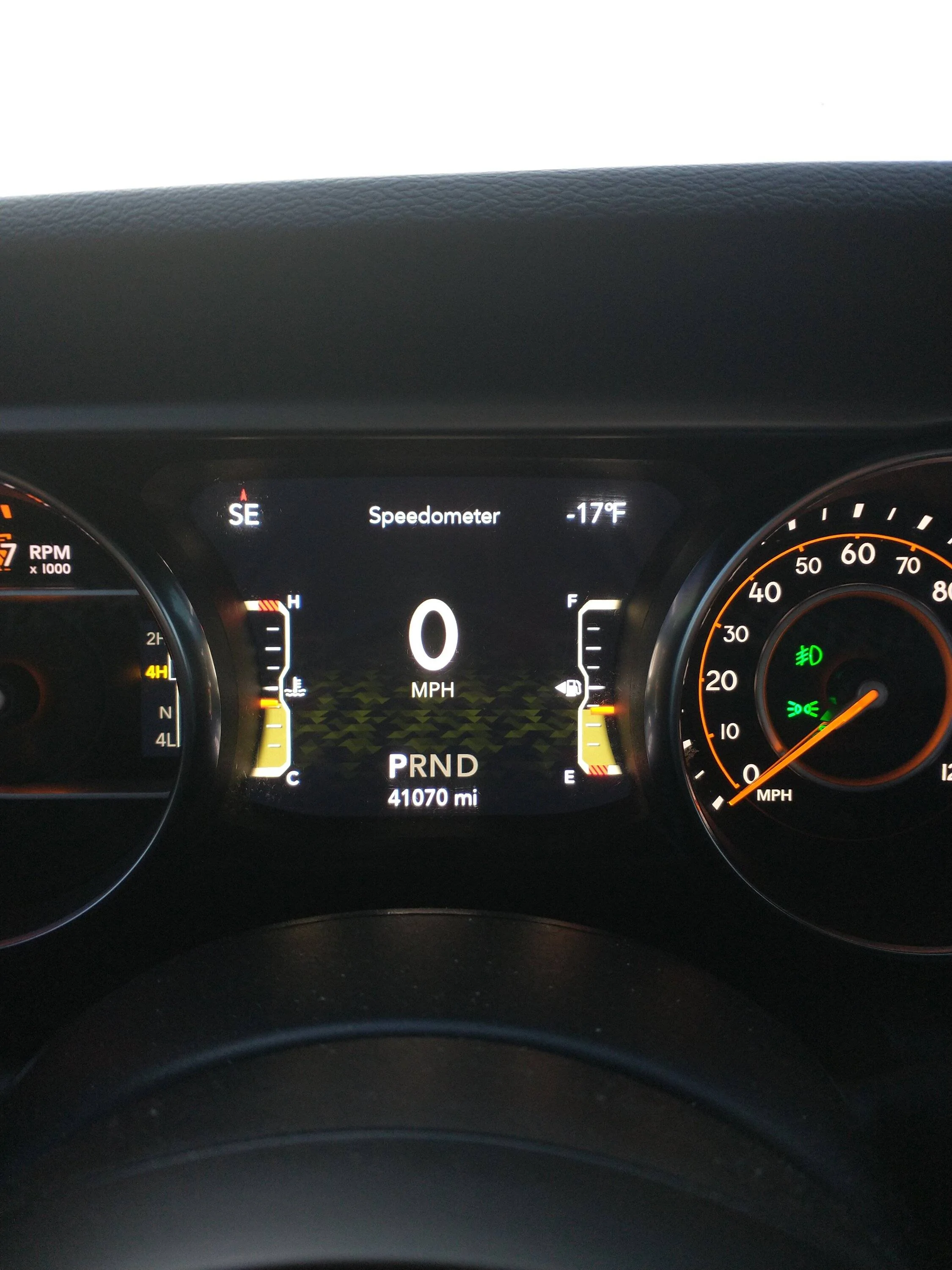

First thing I've been doing is flipping on the heated seats and steering wheel whenever I jump in. I'm sure it was the original battery. I was at 41k miles.
If my temp read -17 I'd he heading SouthEast too! ? Sorry couldn't resist, we were in a deep freeze for > week too in St. Louis.
Fortunately, it's warming back up this week. Going to be in the mid-high 30s!
