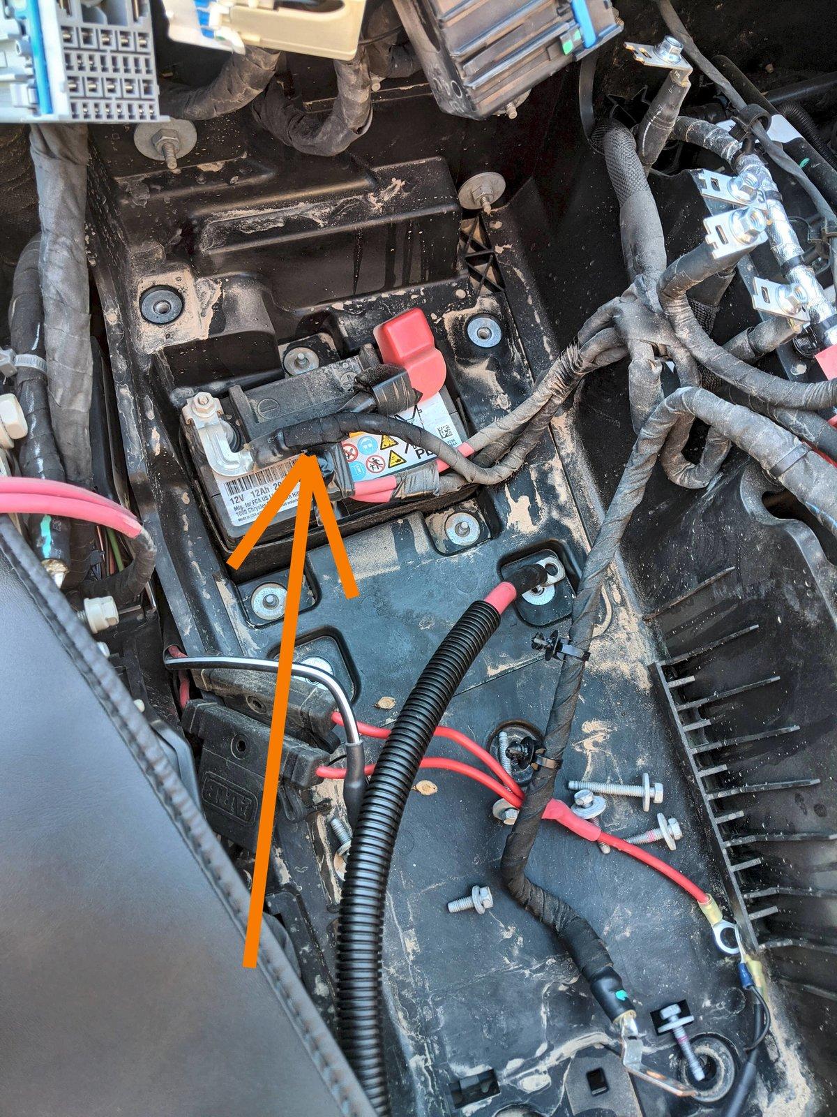

FYI, the aux battery is a small motorcycle battery mounted underneath the main battery. It provides power in certain situations when its desirable to avoid draining the main battery--for example, while stopped at a light and the engine automatic stop-start engages. This is the aux battery, exposed when I removed the start (main) battery and mounting tray to replace the aux battery with a full-size battery ...
Jeep Gladiator Auxilary Battery - Gladiator Gladiator, May 20, CP_090407, Motorcycle Battery
This may suggest (I drive a manual and hold the clutch in at lights, so never see stop-start engage) that if you have an automatic transmission and had you pressed the button to turn off the automatic stop-start, that once you got it started you'd have been able to drive it to the dealer without further interruption. Just something to keep in mind.
Jeep Gladiator Auxilary Battery - Gladiator Image1
You do have to press that button every time you start the Gladiator, however, for it to turn off the automatic stop-start. If you drive a manual, just hold the clutch in and leave the Jeep in gear, ready to go when the light changes.
