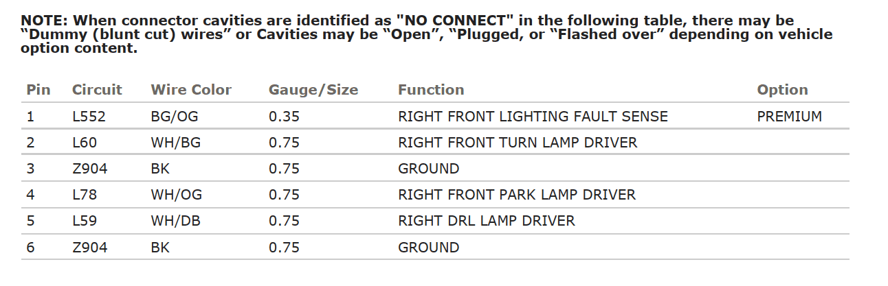

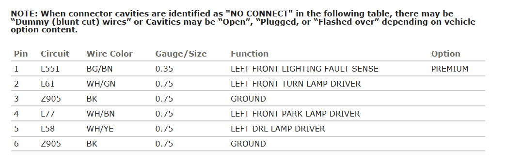

Left front:
Turn- white/green
Park- white/brown
DRL- white/yellow
Front right:
Turn- white/tan
Park- white/orange
DRL- white/dark blue

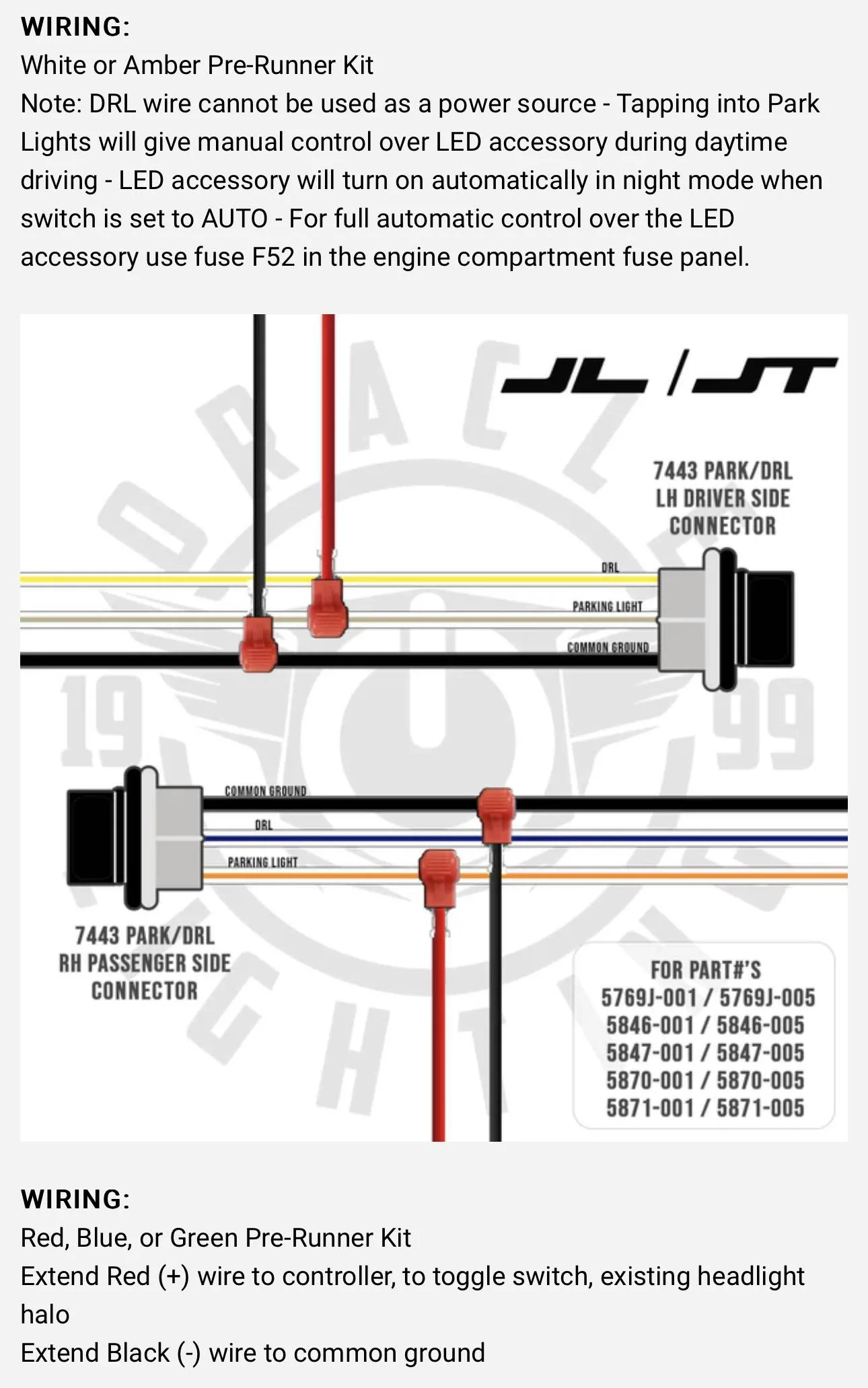

This is how I connected my DD backlight
Jeep Gladiator Finding positive wire IMG_1541
Parking light harness is shown in this video:
I already used fuse F52 for my rough country led headlight drls. Any idea if I could still tap into that wire for the fog light backlight? Or if you know of another source.

what do you want the backlights to do? Be on all the time except when the foglights are on?
If that is the case yes you can use Fuse 52 for both, the backlight draw is minimal.
However that being said tapping the parking lights is the way to go. That way the backlights work as night time driving lights and when you really need extra lights for when its foggy or you are off road then you turn on the bright as F*** DD fog lights.

Hey there! We are glad to hear you're loving your fog lights!
Unfortunately, it appears as if our installation videos are from prior to our introduction of the backlight functionality. Sorry about that!
Generally, either the sidemarker or parking light is your best bet.
