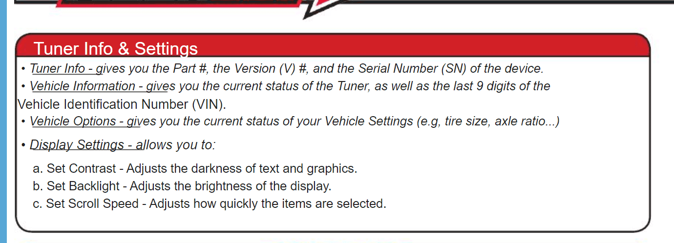

"Vehicle Options" - does this report back a ton of things or just basic stuff like Tire Size?
Can’t remember. I think it’s basic info. I’m at work. I will take a look when I get home.
