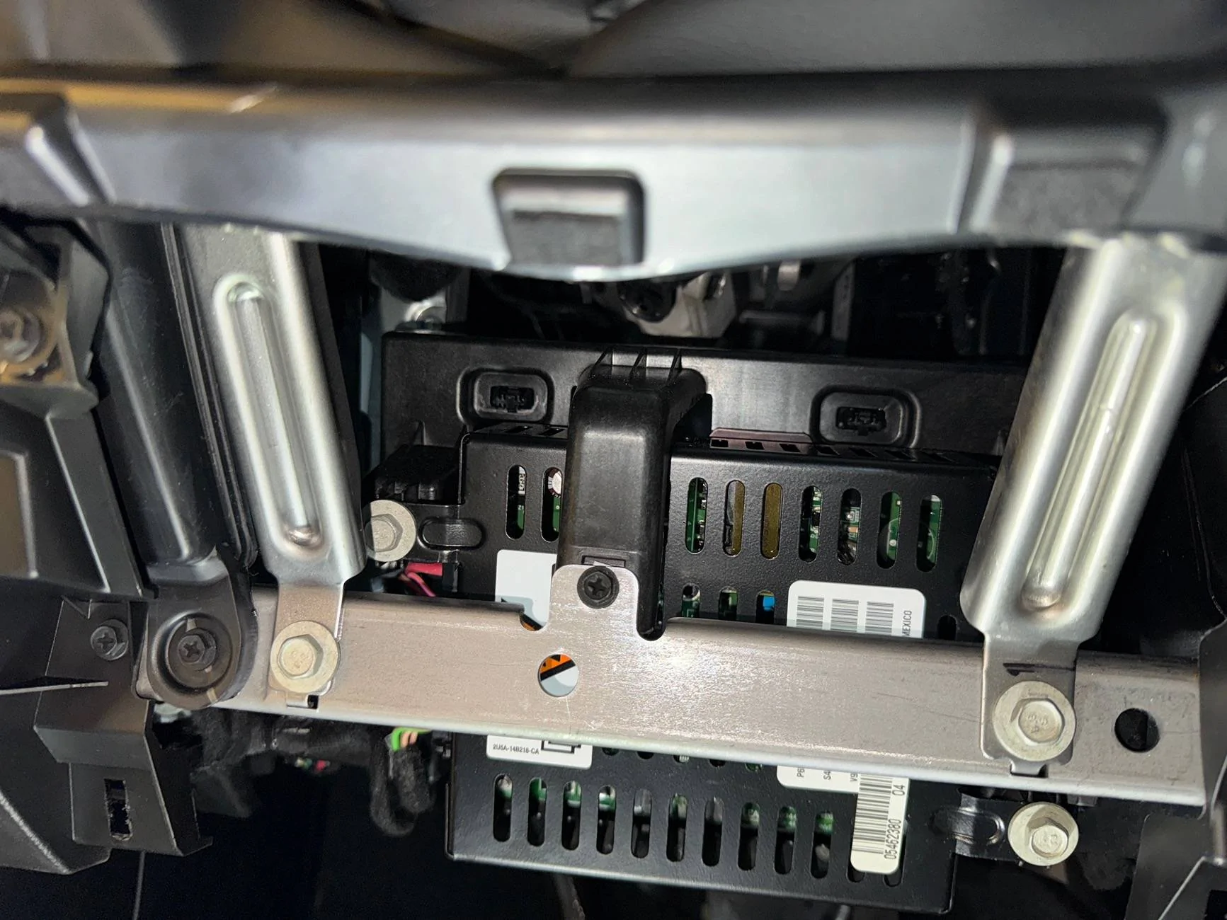

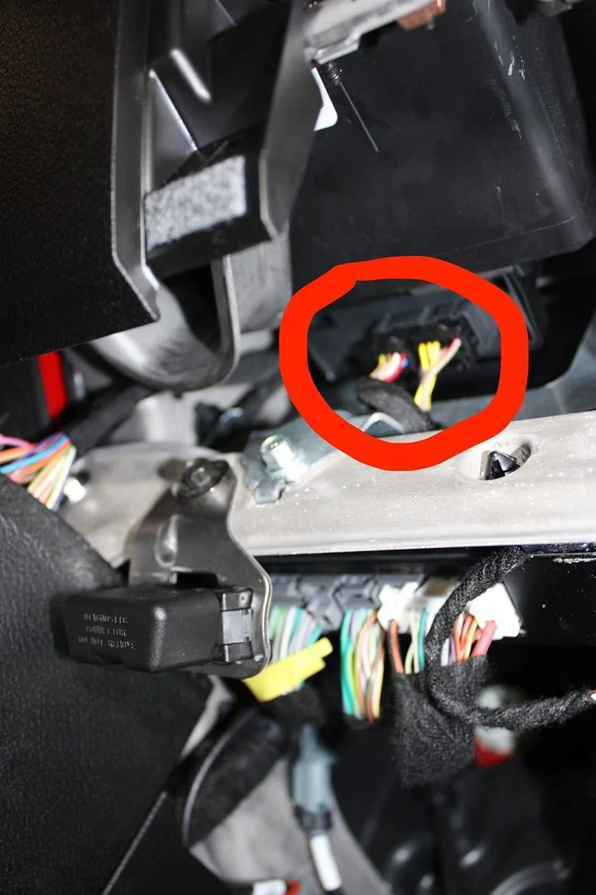

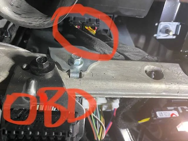

Finding the SGW module . . .
250
40,617
54,337
What others have already said,

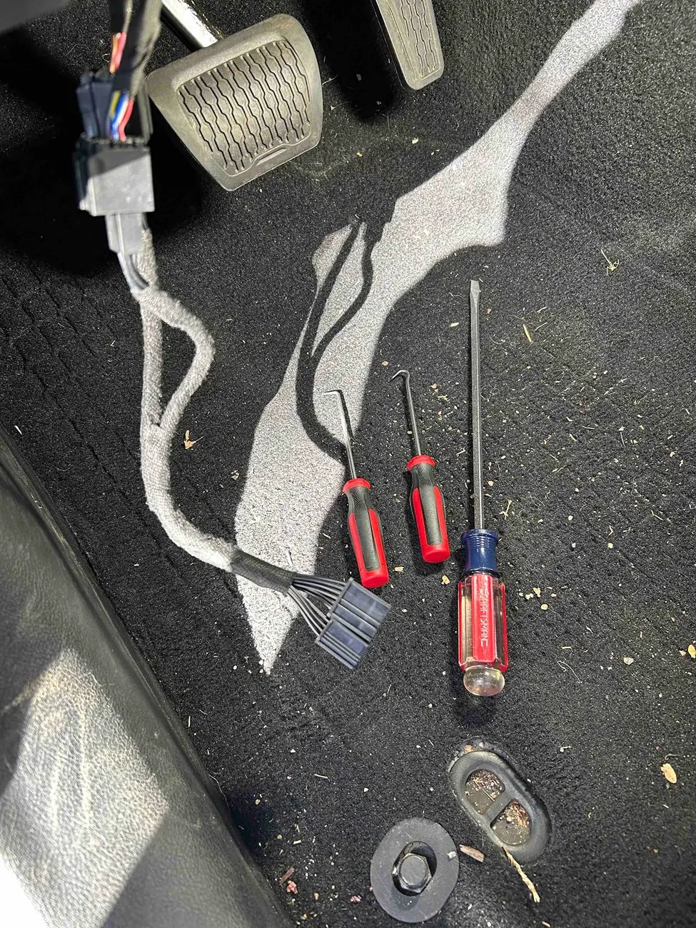

Got the SGW connections removed to hook up the SGW extension cable by using a long screwdriver to press in the latch at the rear of each plug and I pulled down the front lip of each using the hook pick. Real easy. Getting the extension plugged in afterwards wasn't so easy, but the long screwdriver helped with getting them pushed into their receptacles.
Yeah, fairly easy on my 22 - not even close to easy on my 25..............
