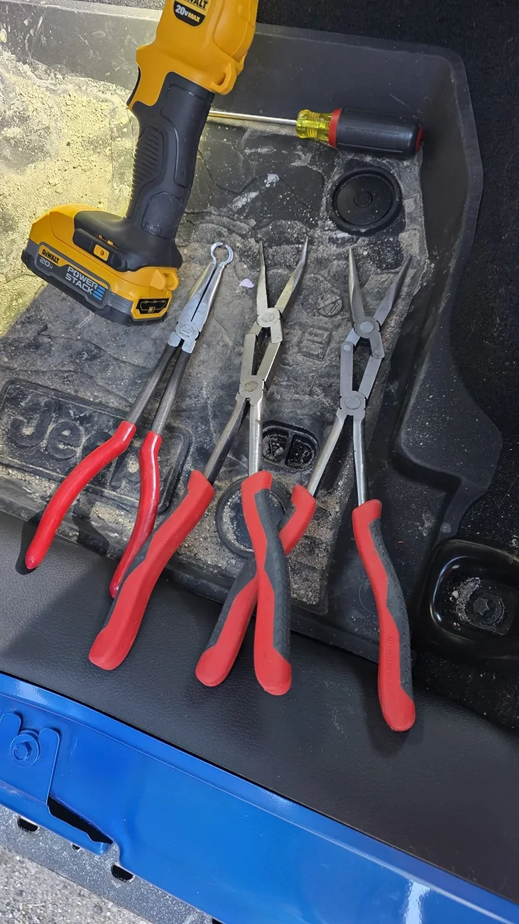

Problem one: The cables were made with the 2 plugs on the wrong side of each other. After a lot of time wasted trying to snake one around the other to get the proper plug in the proper socket, I ended up untaping a few inches and retaping it. It least I have the oem style harness tape so it still looks factory.
Problem 2: Could NOT get light up there to see both connections without also shining in my eyes. If there is ever a next time, I will have to try and remember whatever happened to my flex-shaft inspection light, or maybe try the lighted borescope since I know where that is.
Problem 3: Both plugs on the extension cable almost need to go into the SGW at the same time. Again, if there is ever a next time, I will re-wrap the cable again, only this time separate those two plugs/wires the last few inches so it's easier to work one plug at a time in.
Problem 4: I should have gone right for the extra long reach double jointed pliers right from the start.
