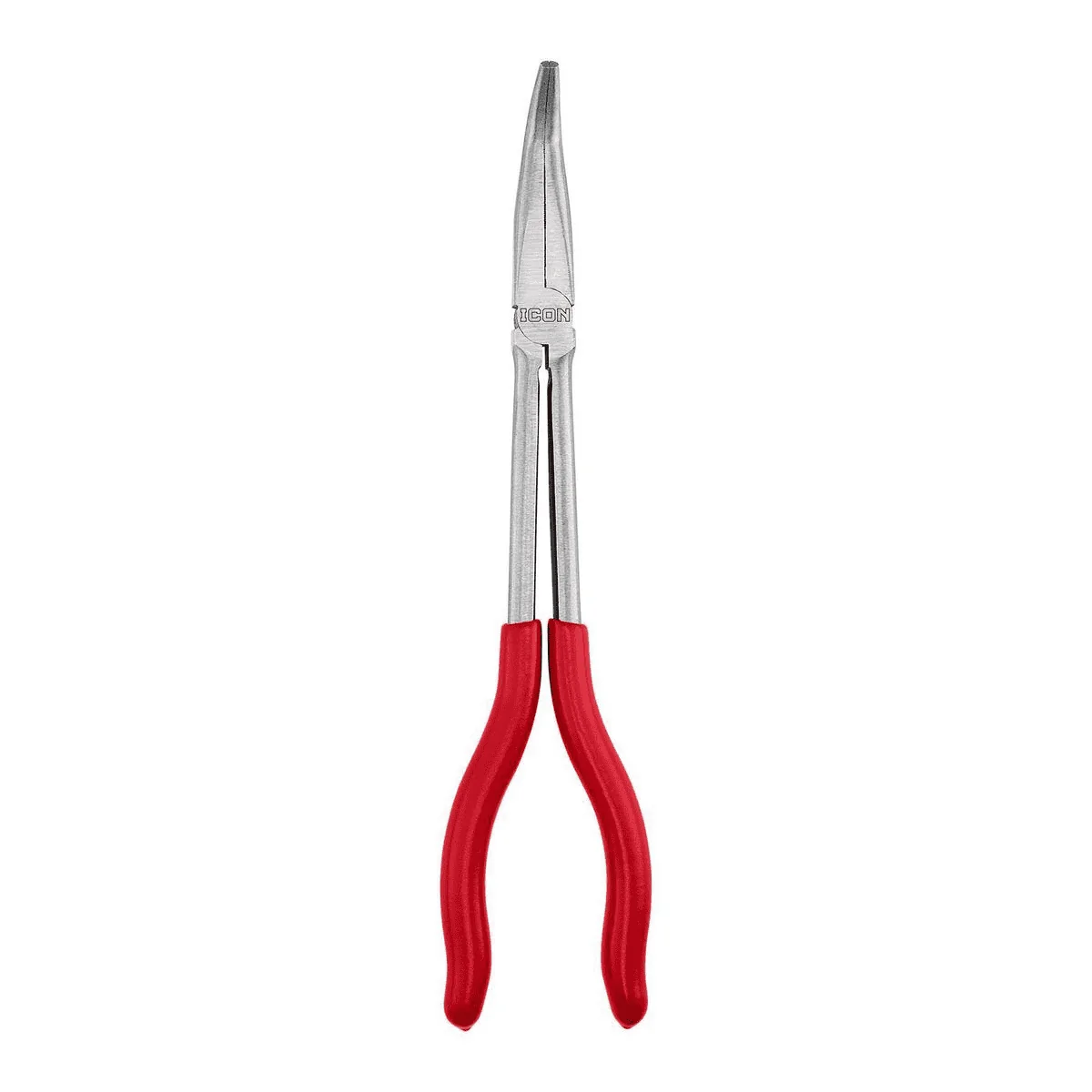

I have 2 separate threads on here about this because during a rage I couldn't find the first to continue bellyaching. I still haven't done it but I haven't tried again either. As suggested to me, I think a long thin set of needle nose pliers might help. Jewelry pliers. https://www.amazon.com/Jewelry-Pliers/s?k=Jewelry+Pliers
I have a pair of these ICON pliers that I tried. Great tool, very useful, just not for this job? Also have a much smaller one, similar to the jewelry ones that you linked to. I might give them a tug as well.
Jeep Gladiator Need ideas on how to disconnect the two SGW connectors 1708639762823
11 in., 45° Long-Reach Pliers (harborfreight.com)
