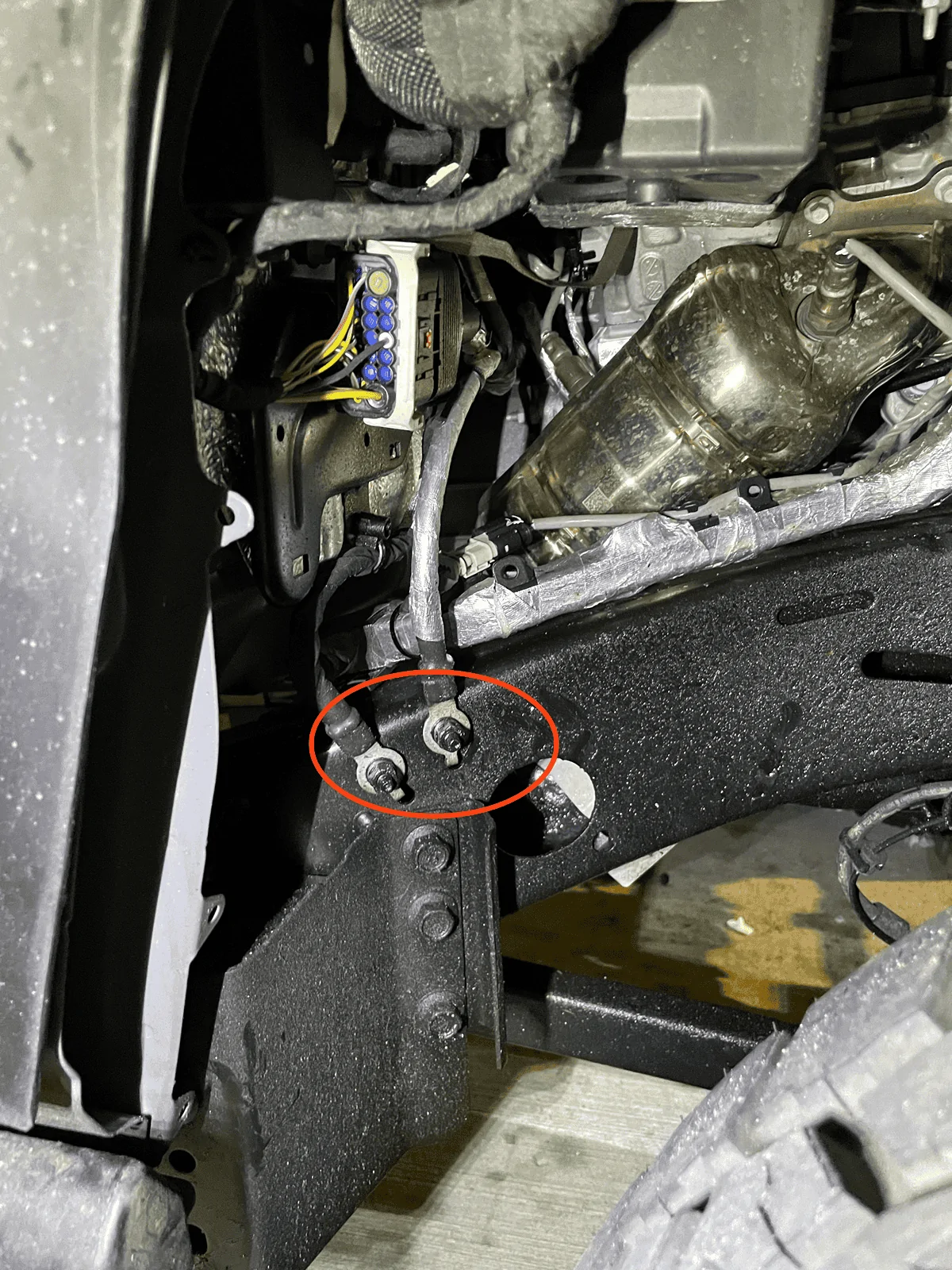

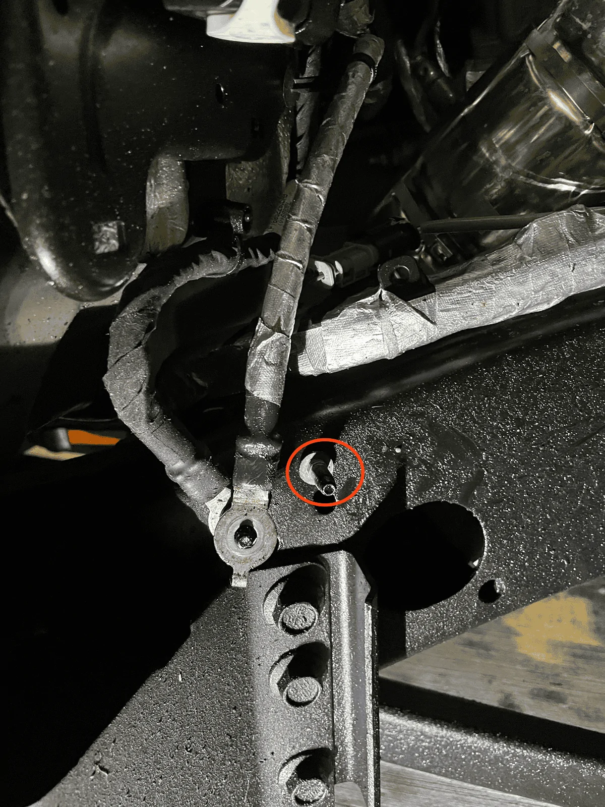

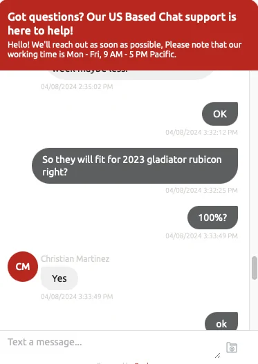

Just got new Inner fenders from Paramount Automotive. Was told that it will 100% fit my 23 JTR. But NO IT WILL NOT.
Trying to install my aftermarket inner fender (Passenger side), but there are two bolts the frame that interfere with the liner. The liner needs to be cut to fit or the bolt on the right need to be removed.

Just throwing out ideas here. There is a divot in the end, and maybe this is a torx but it’s tough to tell from the photos. The other option is if you are removing, vice grips are possible but will destroy the threads. Lastly, cut them off with a dremel.
it looks like they are electrical grounds, so not a huge loss if destroyed but you need to find new grounding points for whatever the wires run to. If you can get them to twist out, a hex-Head or pan head bolt in the same hole would be an easy way and wouldn’t protrude as much

Make a hole in the liner. I wouldn’t chance moving the factory grounds for anything. Problems if you move it and don’t get good ground, especially if it is under warranty

I second that! Make it fit without modifying or return the liners.

I double checked many times with them and they said it will fit. Today I saw a comment a guy is complaining the same issue and a guy said it was also confirmed by Paramount. So they knew it. But the guy mentioned 22+ Model do not fit. I wonder does that mean start from 22, there's some difference?
