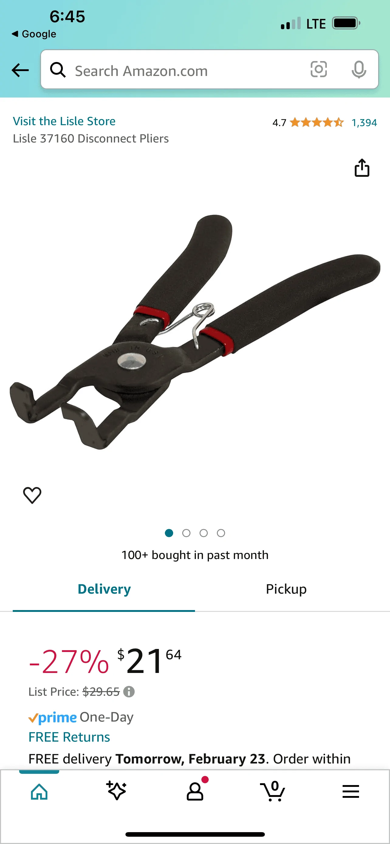

I used my fingers, nice and slow and steady with my son, holding the flashlight with me yelling at him to hold the flashlight in the right position. Some of my friends use these.
If you had really nice friends, you'd be using them, too............
