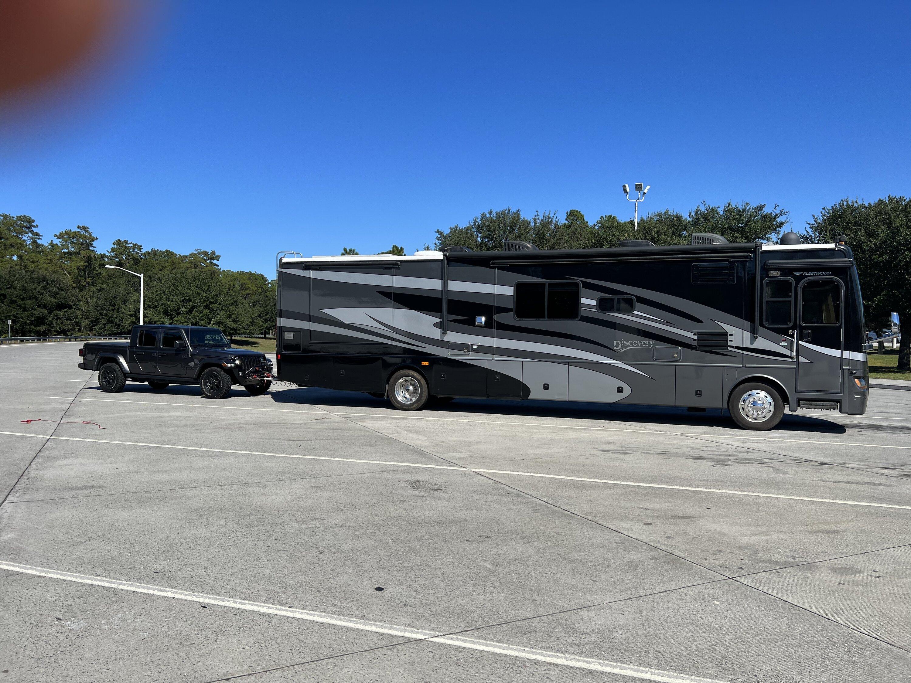

We flat towed from East Tennessee to Blythe Island GA today which was the first time flat towing the Gladiator. When we got here, it said “TPMS not available”. Unhooked set up coach and drove to store and it’s working. Is this common? I seem to remember seeing something about “waking up” while flat towing. Does this happen when brake lights or taillights work? I’m using the Blue Ox EZ light wiring kit which is supposed to be plug and play with resistors built in.

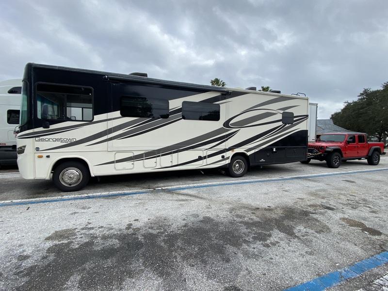

I installed a RoadMaster light kit in our Gladiator. We just returned today from a trip across the state. Our Gladiator went thru the same TPMS issue at both ends of the trip. Driving about 20 MPH or higher reset all the sensors.
I also got a weird issue when we got home, and I disconnected the aux braking system from the Jeep (RoadMaster Evenbrake). When I went to start the Jeep, it gave me a Diesel heating warning, and wouldn't start for a minute. Afterwards, it was fine.
