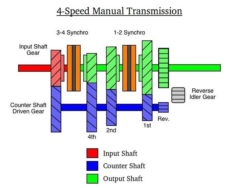

It's because when the engine is stationary, neither the input shaft (red) nor the countershaft (blue) are moving. Only the output shaft (green) would be moving. The reason this is a problem is because the transmission is either splash lubricated via a submerged countershaft or lubricated by a lubricant pump that is usually driven off of the countershaft. If you go too long with the vehicle coasting out of gear with the engine off (as are all towing situations regarding wheels on the ground) the output shaft will be spinning and spinning without receiving any lubrication from a spinning countershaft.
That's also the reason why the manual tells you to put it in gear. When you keep the trans in neutral the output shaft will start to rotate freely just from the friction within the transfer case. Then you'll be wondering why you can't drive your Jeep with four flat-spotted tires.

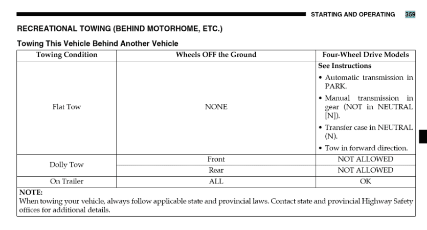

The manual transmission does not have an oil pump and rather is "splash" lubricated, so neutral or high gear is fine for flat towing.
The transfer case on this particular vehicle receives its lubrication from a rear mounted oil pump, so its lubricated every time the wheels are turning, hence why its ok to flat tow with the transfer case in neutral, but not ok for the automatic transmission in any gear but park.
See my post above. It is NOT OK to flat tow with the manual transmission in neutral. Keep it in gear, it does not matter what gear it is.
