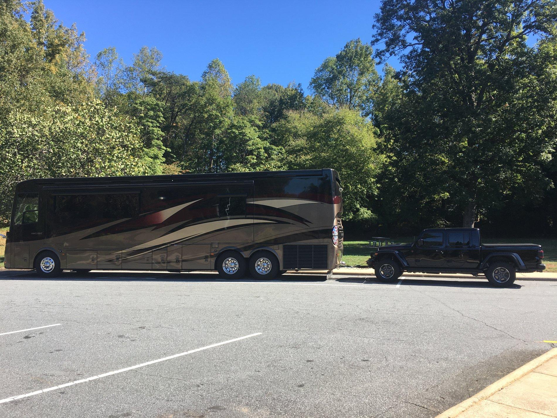

I just got mine set up to flat tow behind my diesel pusher. I have the same set up on my F-250 as the JT. It’s a Blue Ox. Both on my vehicles are very easy to put them in neutral and hook up to the RV. I wouldn’t mess with a trailer.
Were you in Georgia this past weekend? I was up there and started heading back to Florida this past Monday. Definitely saw a lifted black or Granite JT being flat towed behind an RV. Trying to remember which day I saw it, but I want to say I was on 400 South and saw it heading north. 'Bout broke my neck looking over from my Sting Gray JTR.

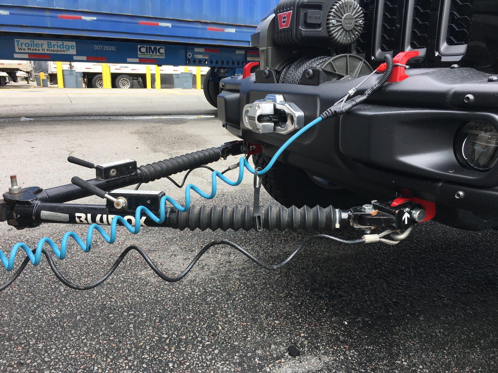

I'm using Maximus-3 tow hooks, a Blue Ox tow bar, and for lights, I used a double pole 4 way switch to do the brake lights. Fairly simple.
Any close up photos?

that is an awesome setup, but I still dont understand the double pole 4 way switch....I am some what mechanically challenged

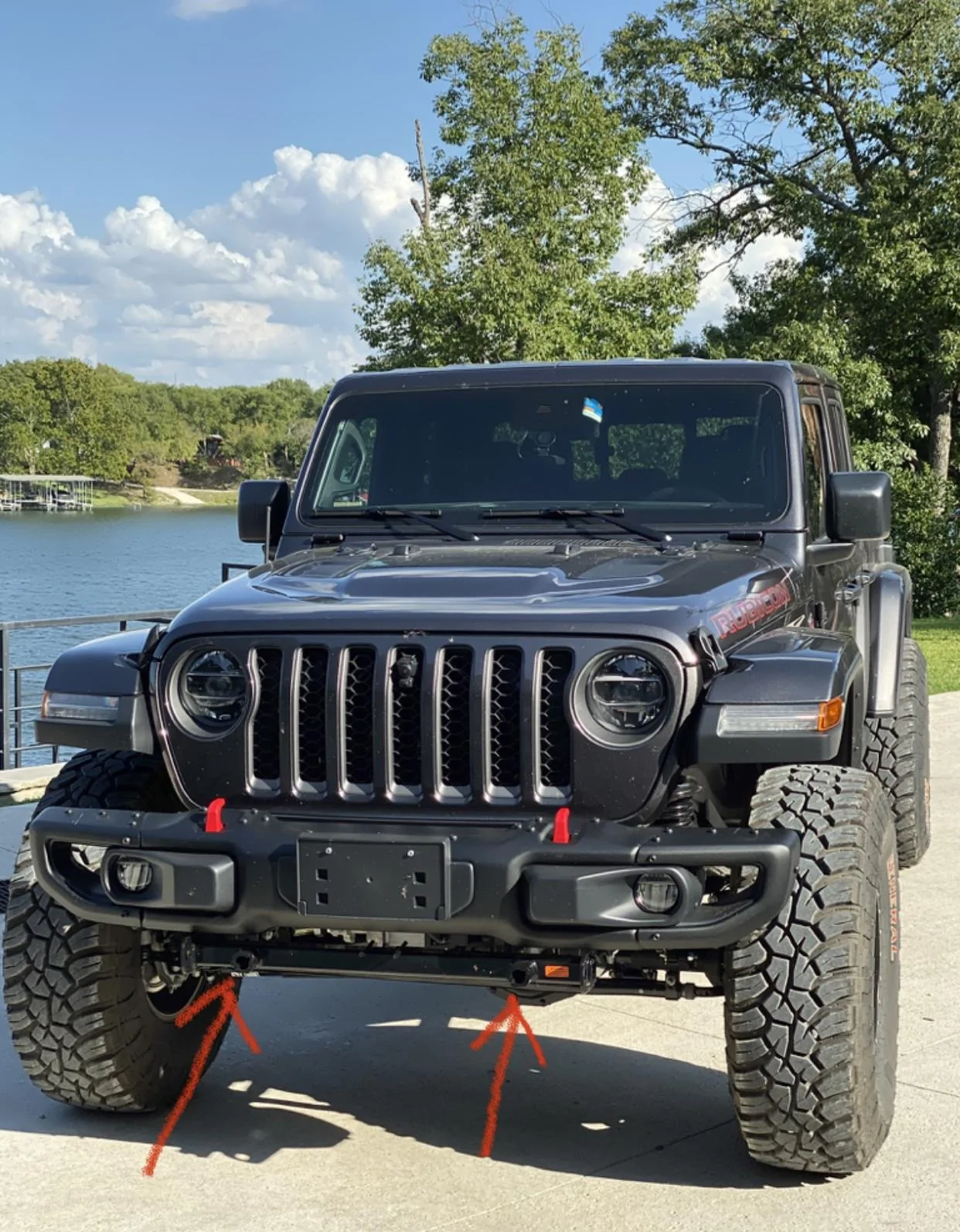

Neither, I used the Maximus-3 tow hooks. Much cleaner look, no loss of clearance and very strong.
EDIT: Link.. https://maximus-3.com/jl-bumper-accessories-/jl-tow-loops#/
I bought the same type of setup but from LoD offroad to use the D-rings instead of a baseplate. I've had thier bumpers for years. They have adapters for both Blue Ox and Roadmaster
https://lodoffroad.com/products/jee...k/front-bumpers/jl-frame-tie-in-brackets.html
I also use the Ready Brute Elite for the tow bar and braking (mechanical)
