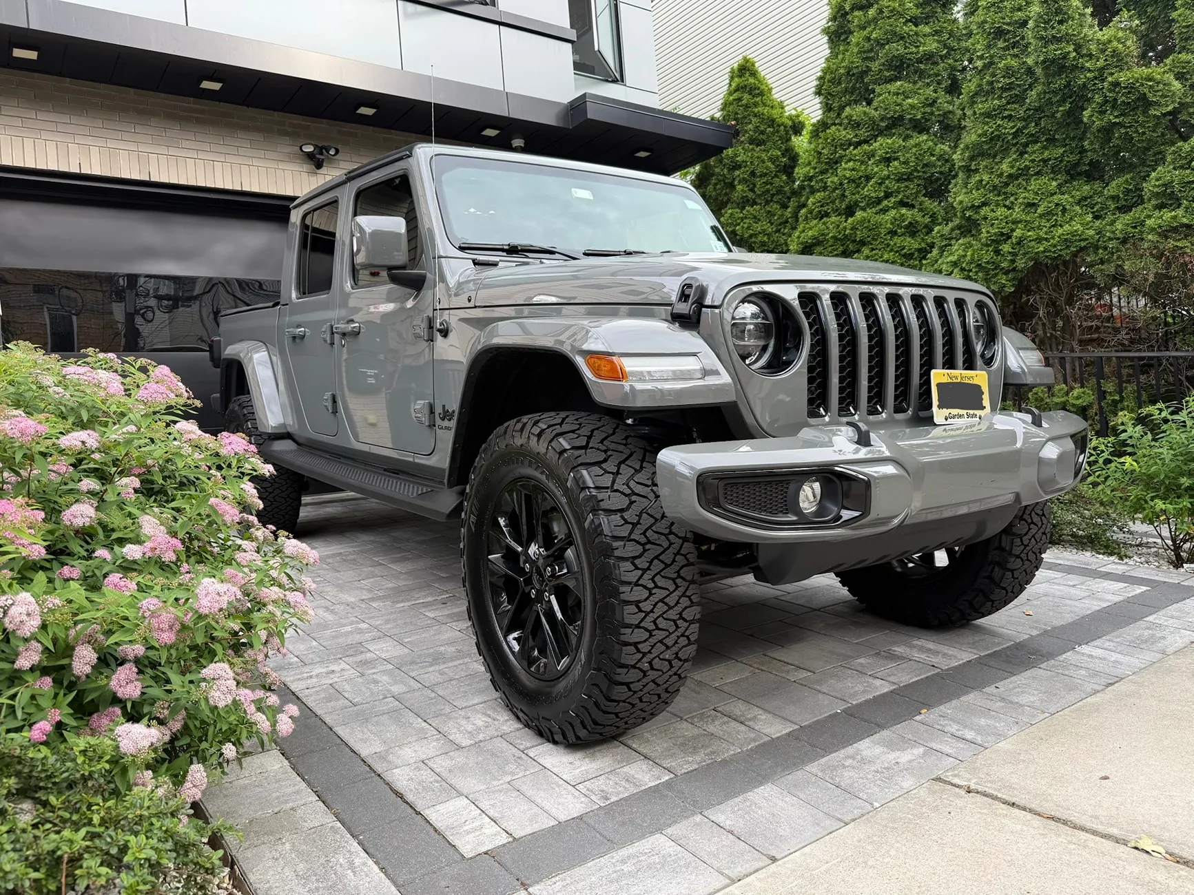

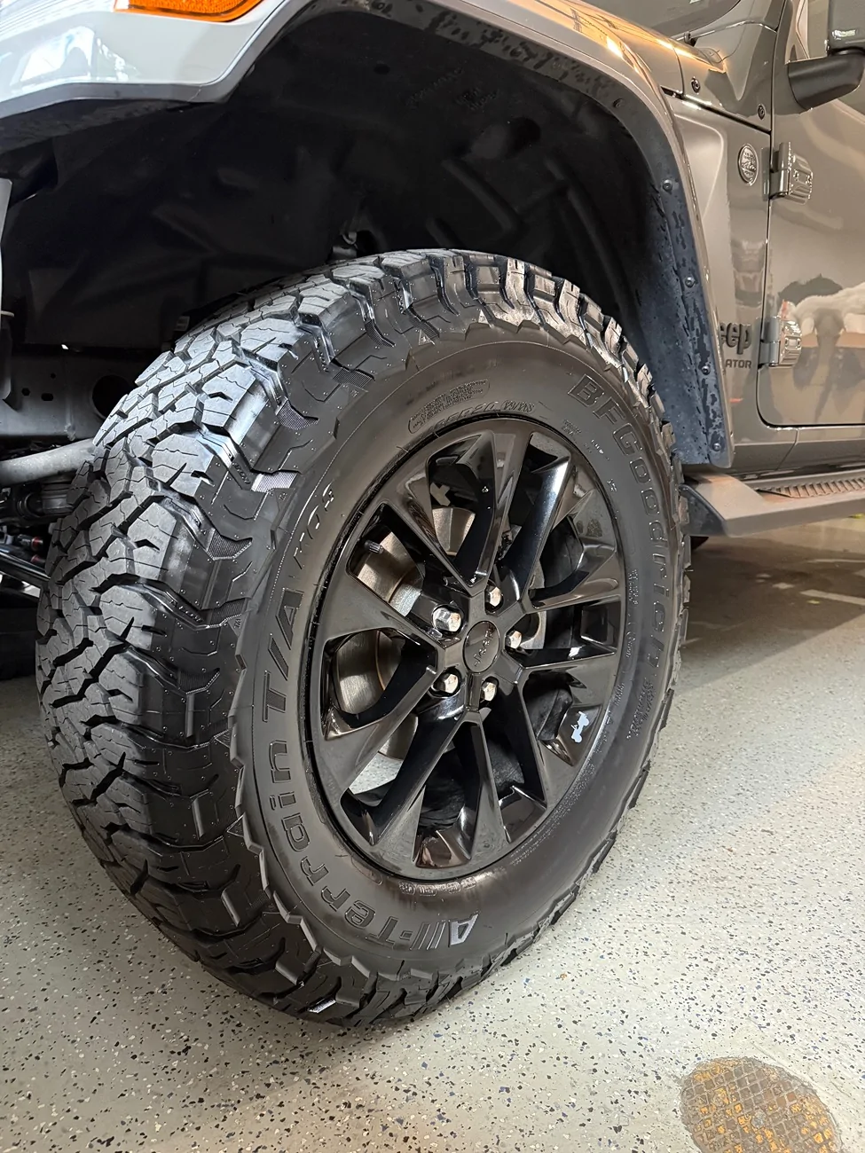

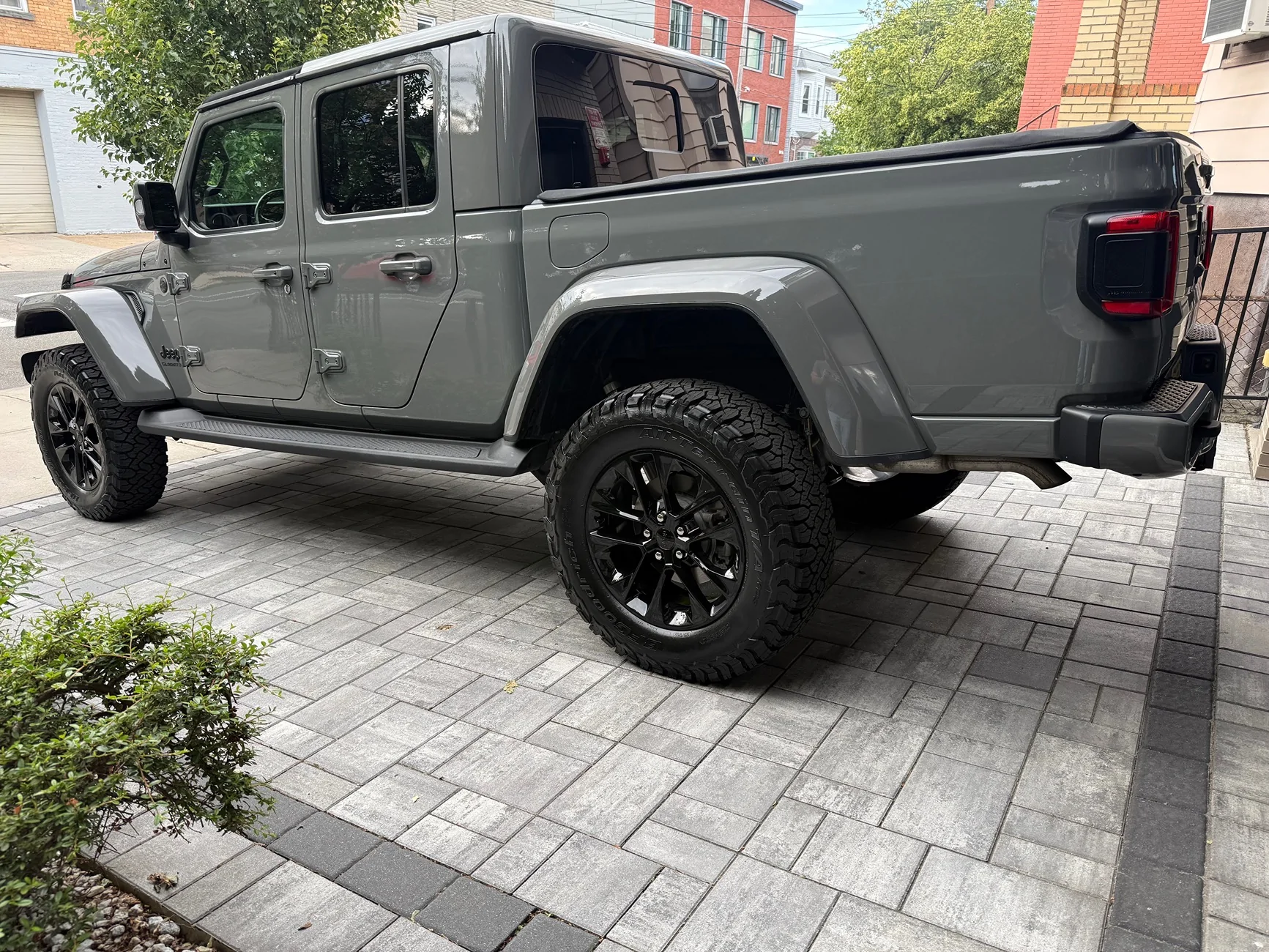

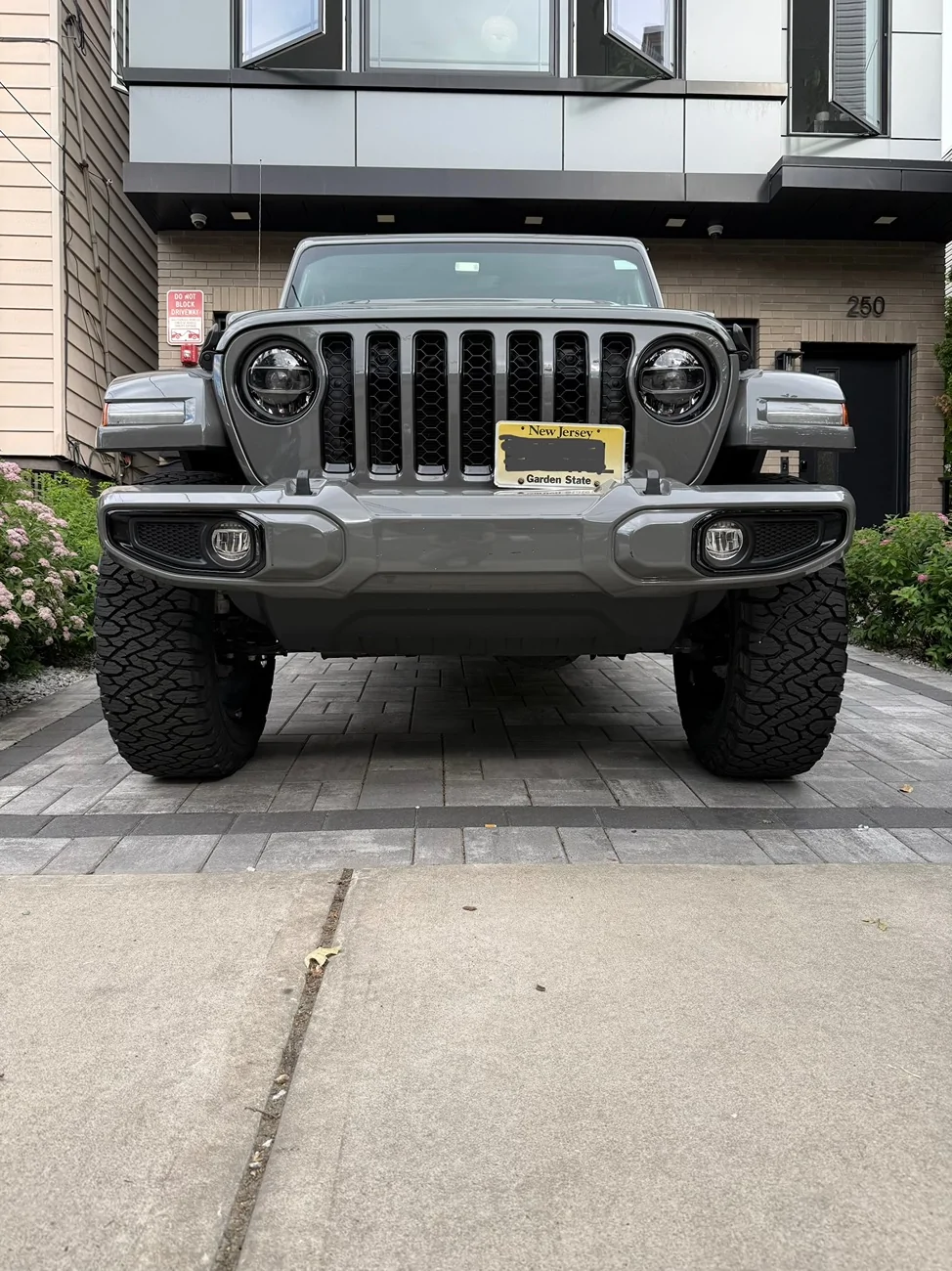

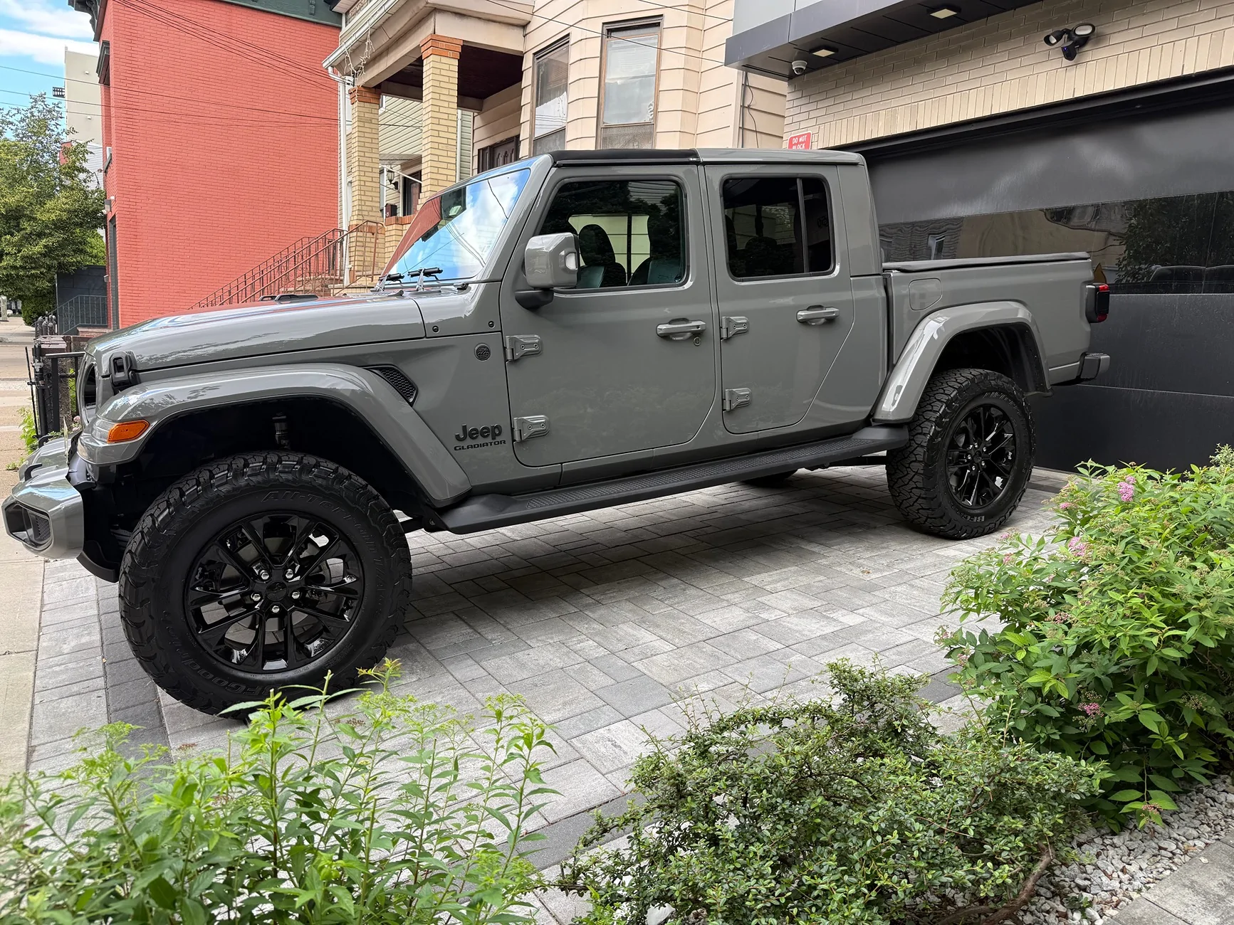

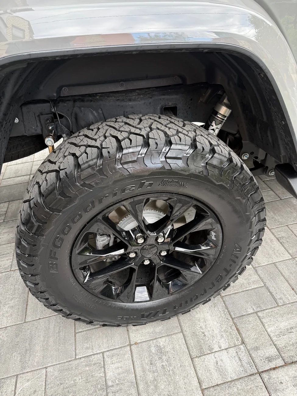

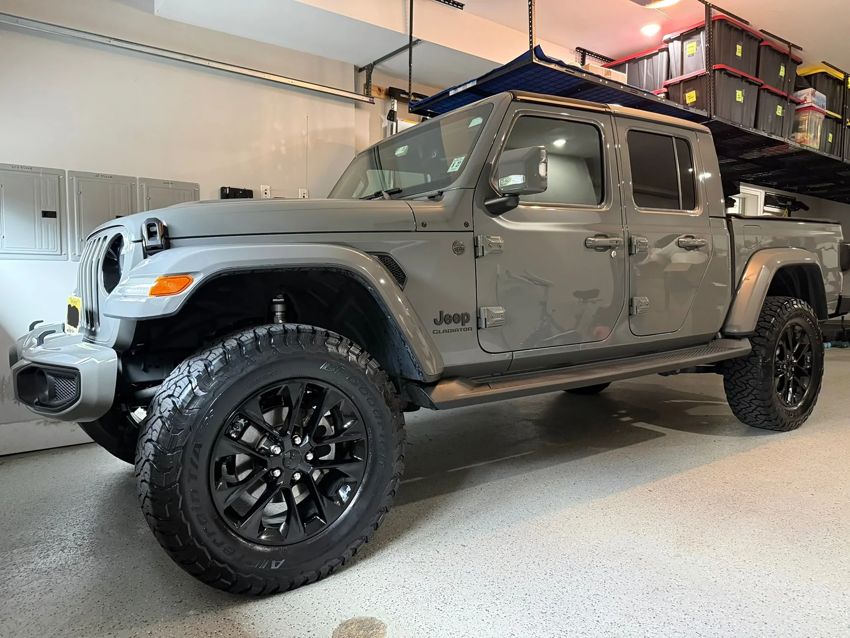

Posting a follow up now that I’ve got my truck back.
Picked it up Friday afternoon, and all I can say is that it met every single one of my expectations. I’ve posted a few pictures for anyone who is interested. The shop I worked with did an incredible job and the lift / tires combo looks exactly as I hoped it would – really what I think it should have looked like from the factory.
The Clayton 1.5 Ride Right to me is exactly what I was hoping for. With all said and done, I netted approximately 2 ½ inches in every corner. That plus the tires is about 4 inches above stock.
I drove it home from the place that did the work about 70 miles Friday, good mix of country roads, highways, and city rush hour traffic. Another 70 or so miles since then.
I guess the most important statement I can make is that it drives nearly as good as it did stock. The obvious shortcomings are that it’s a little worse in acceleration and braking. Nothing significant, but noticeable to me who was paying super close attention leading up to this and now after it’s been modified.
The 35’s with the 3.73s are completely manageable. You absolutely notice the riding lower gears at highway speeds, but my VERY rough observations on gas mileage is about -2mpg Highway and -3mpg City. You definitely need more throttle everywhere, but I’m still able to accelerate how I need to and drive defensively in the NYC area.
If anyone is interested in any additional feedback on any of the specifics, just let me know!
Overall, I’m super happy with the parts I used, the work the shop did, and how it all came together. Even more cool is that somehow, my 3 year old son is more excited than I am by his new ‘monster truck wheels’.

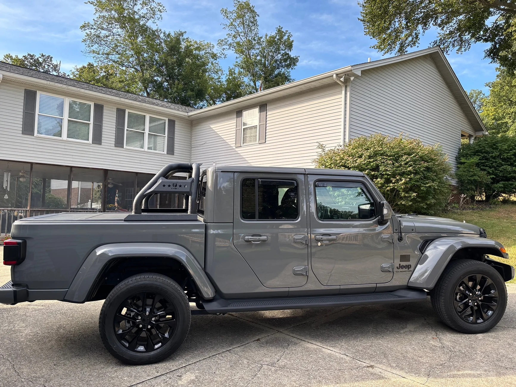

Great color! And that roll bar / tonneau cover combo is cool…was thinking about something like that too, but will probably keep it as is for now. Looks awesome on yours!
