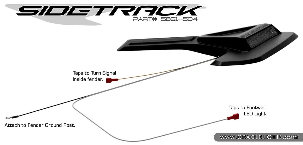

Do they wire directly to the existing fender lights?
Im interested.
You would tap the fender light for turn signal. You do not need to run a cable to the front turn signal, the cable is right behind the fender vent. For the white light it is easiest to tap the foot-well light (Yes, it keeps the "theater dimming effect") or you could connect to an Aux switch if you prefer to use this as a rock light.

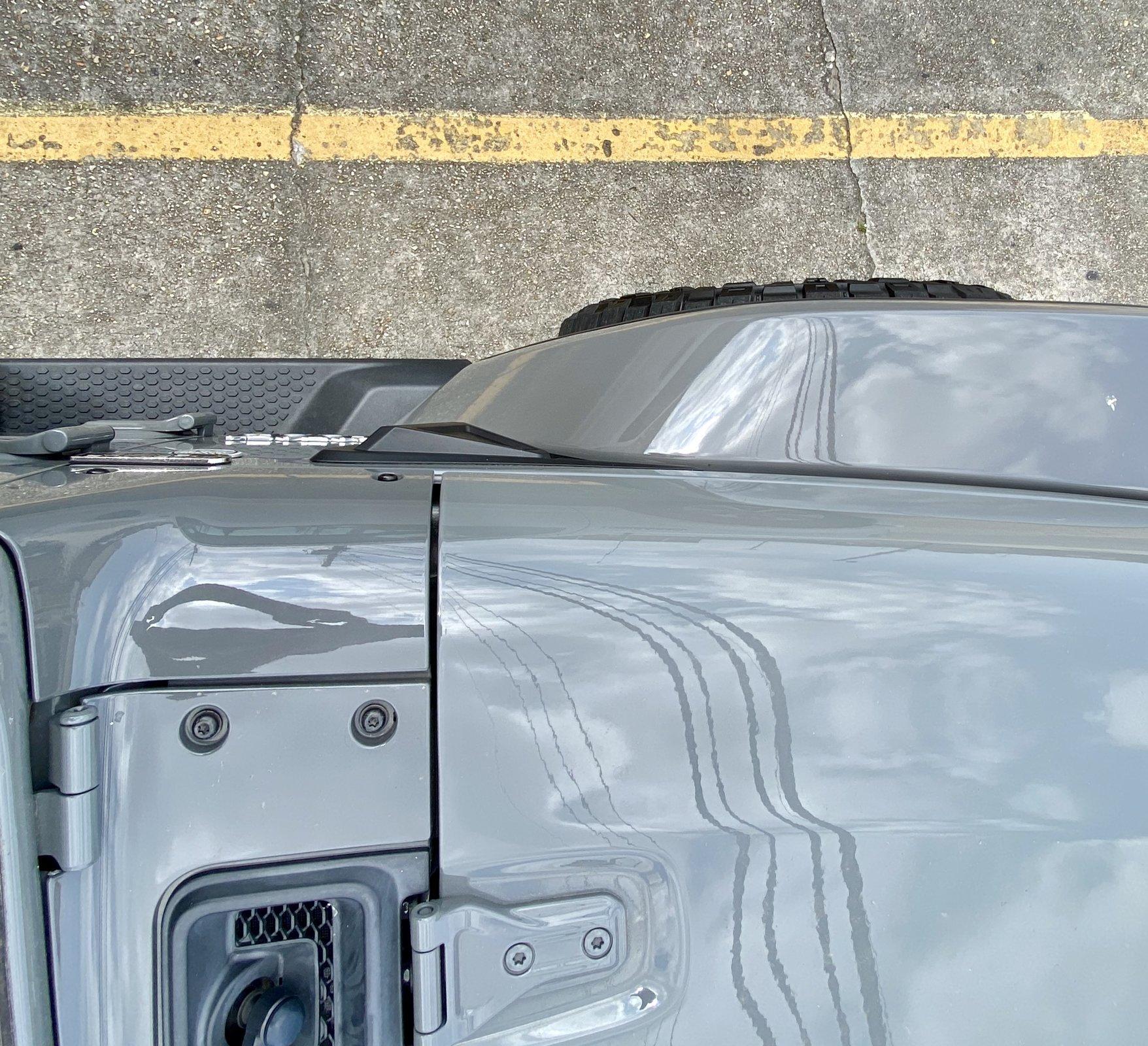

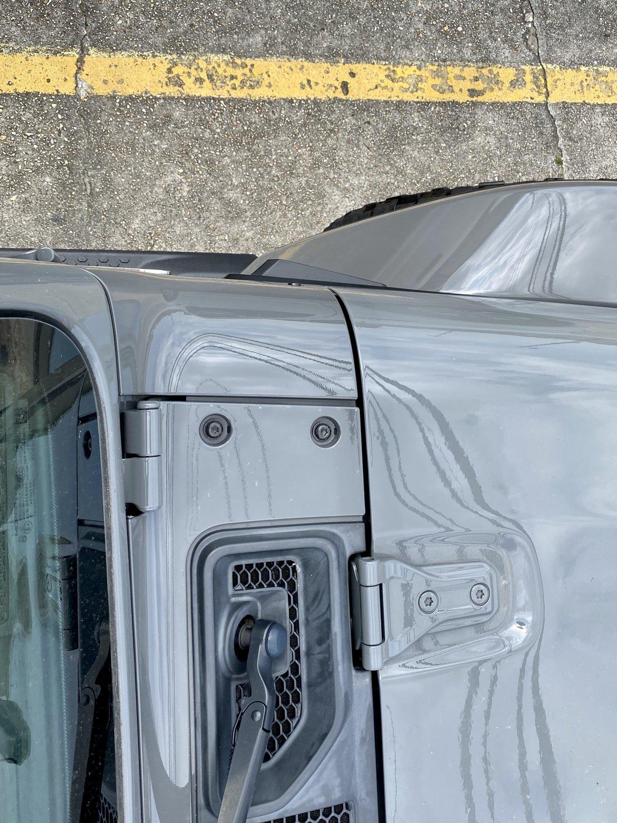

@ORACLElights .... Can you post pics looking straight down the side to show how far out they protrude compared to the sheet metal
Here is a view looking down. They stick out a tad further than the factory door hinge from the sheetmetal. The fender is indented in this area so we designed this to use that cavity to drop the emitters down and keep everything nice and tight ;)

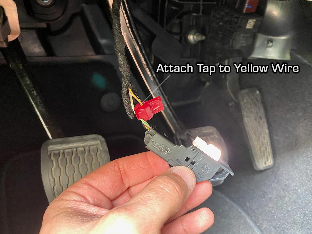

I thought they were the same light just dimmed down. Guess I have not paid that much attention to that.
Here is a photo of the courtesy light tap for reference.
Jeep Gladiator First Look: Sidetrack LED System for JL and Gladiator! IMG_0456
So are the courtesy lights and the footwell ambiance lights the same light? Im getting mixed signals. Are they on while driving down the road with the headlights on unless you dim the footwell lights all the way down? Not a problem for me either way. I will still prolly buy a set. Just curious.
No, these do not stay on with the headlights (unless you wire them to do so).
There are 3 wires that go to the light (Courtesy, Ambient, and Common Ground), tap the Yellow one for it to turn on when you unlock your doors and turn on your dome light.
