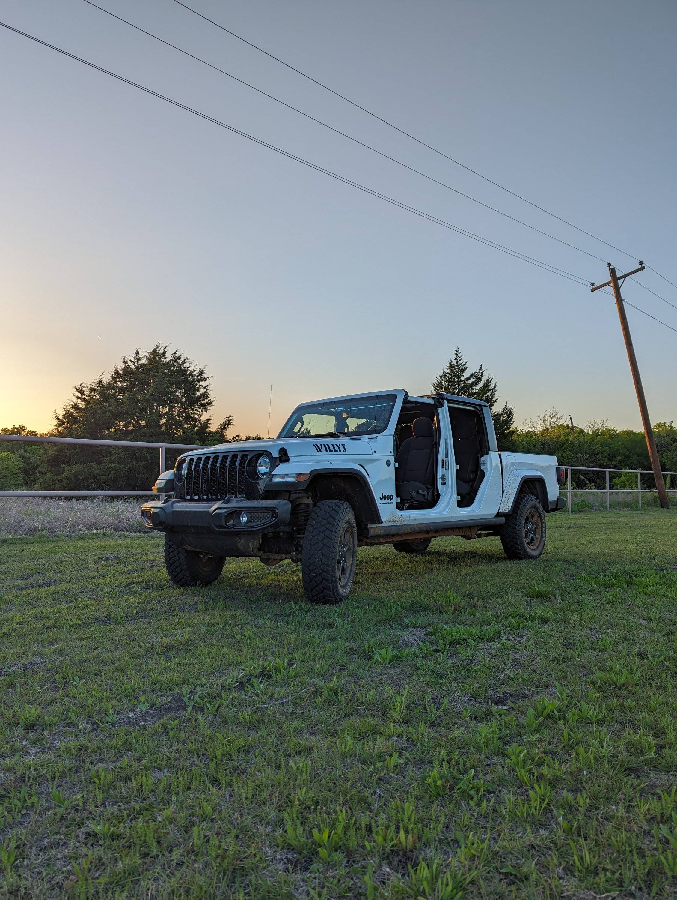

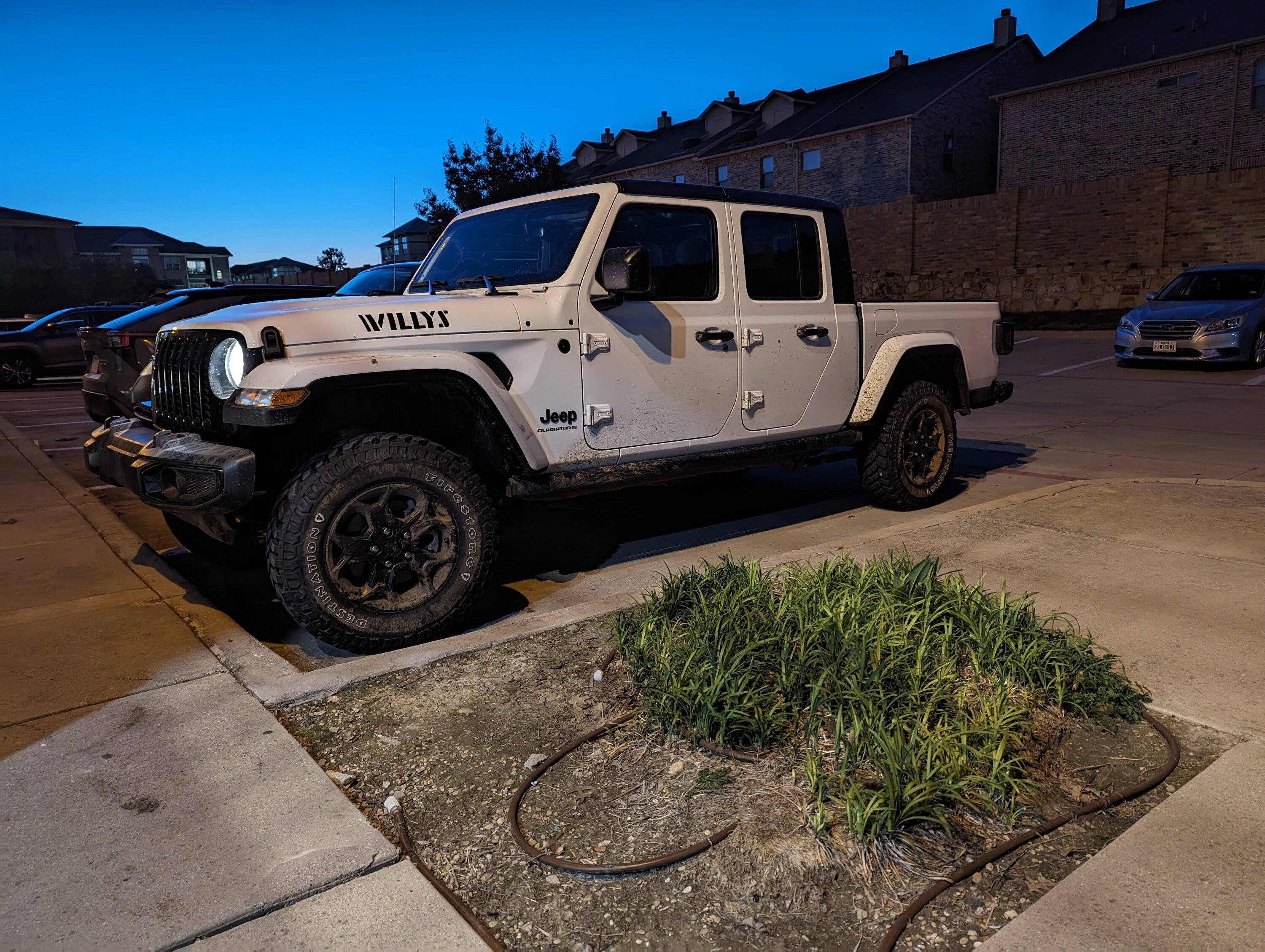

I picked up this new, leftover '23 Willys on 4/5 and got a 2 1/2" leveling kit on it Sunday. Next are 3/4" spacers for the rear, a bumper so I can mount the winch off the JKU I traded in, and a front track bar to get the axle centered again. Then saving for some 5.13s and 37s!

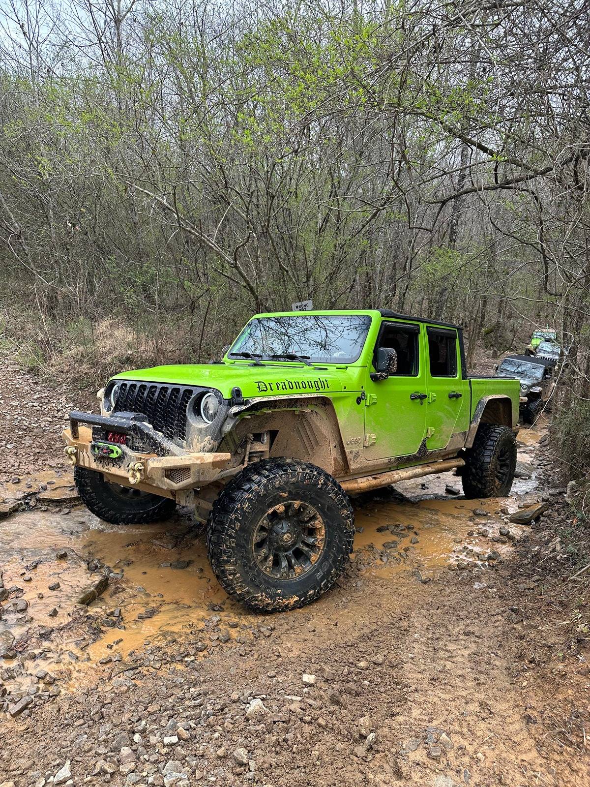

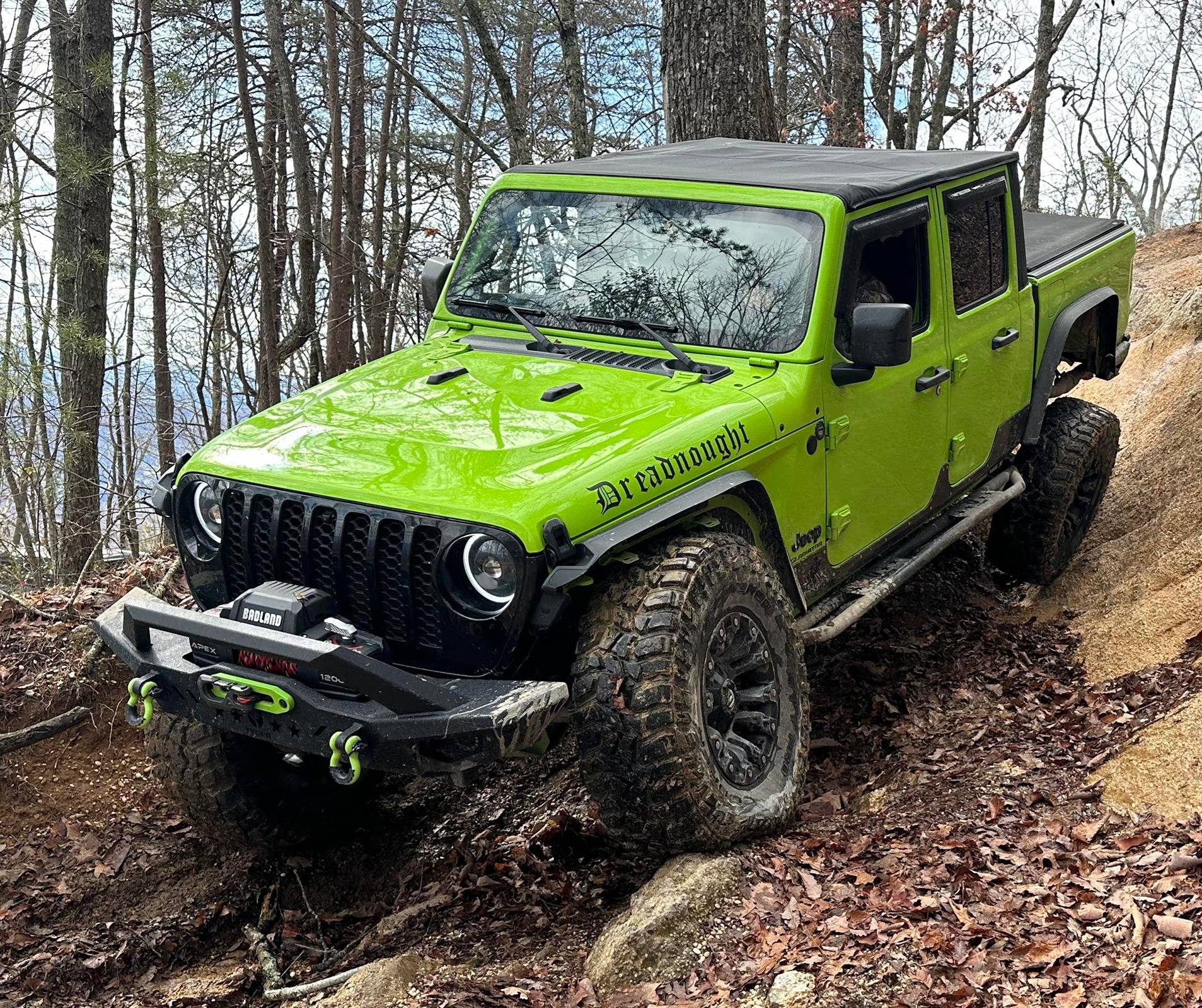

Very nice!! Welcome and get your bank account ready, lol. This is my "ex" Willys. It started life as a 21 Willys but there's not much Willy left. I have Rubicon Axles with 5.13's and 37's. You'll LOVE that combo.
