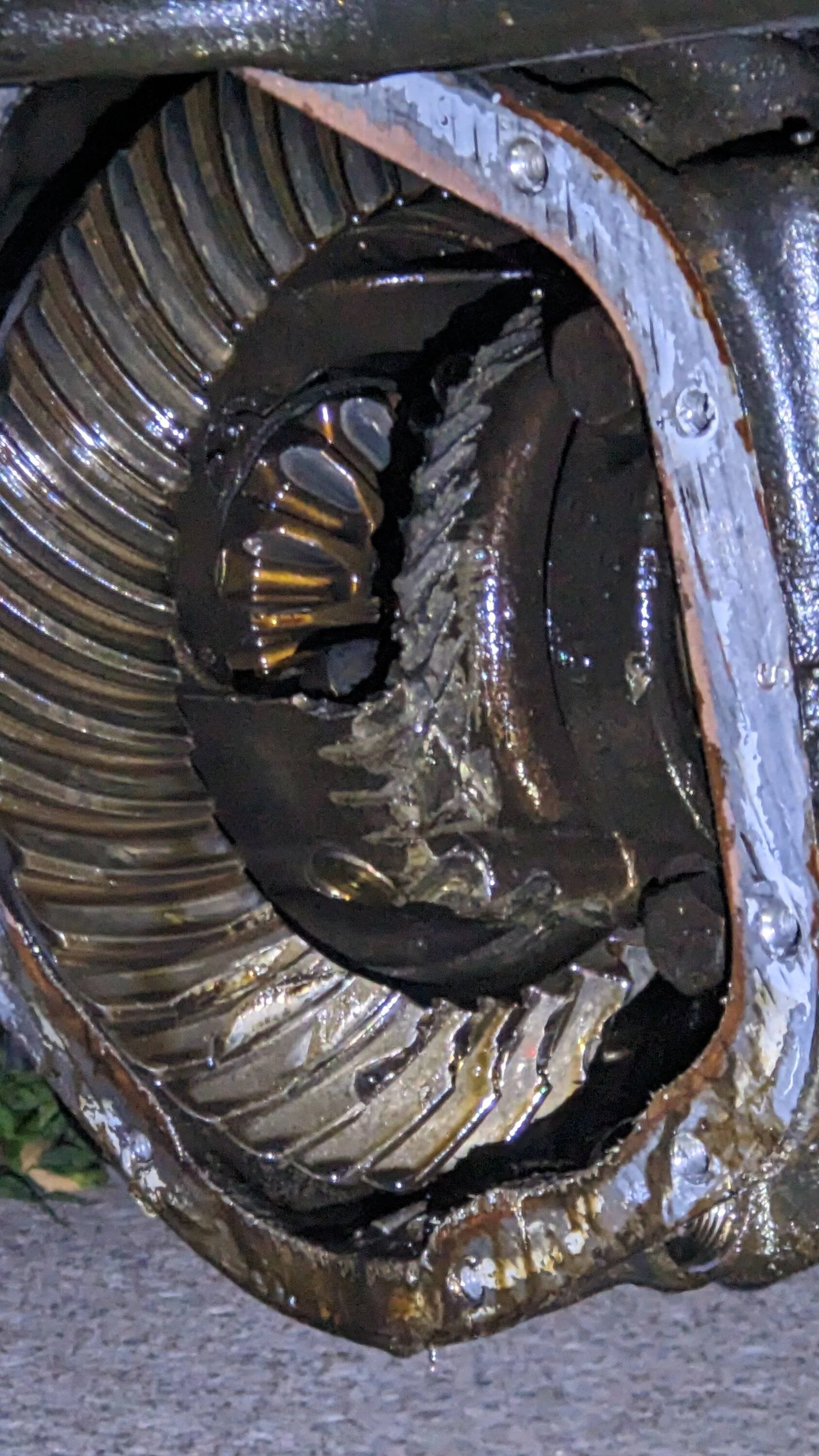

Not to make your nerves any worse...but that's why I would use a shop to do that work for me.
One of my Jeep club buddies from down the street was driving home last night rear diff locked up after her pinion - I'm guessing - lost it's preload and the bearings chewed into the carrier.
The carnage is real, if you look closely in the picture, there's bearings in the gear oil in the bottom of the housing, broken ring gear teeth, and that carrier looks to be toast too.
2012 JKU, she's not sure about OEM vs aftermarket having been in there, as she bought the Jeep used...
