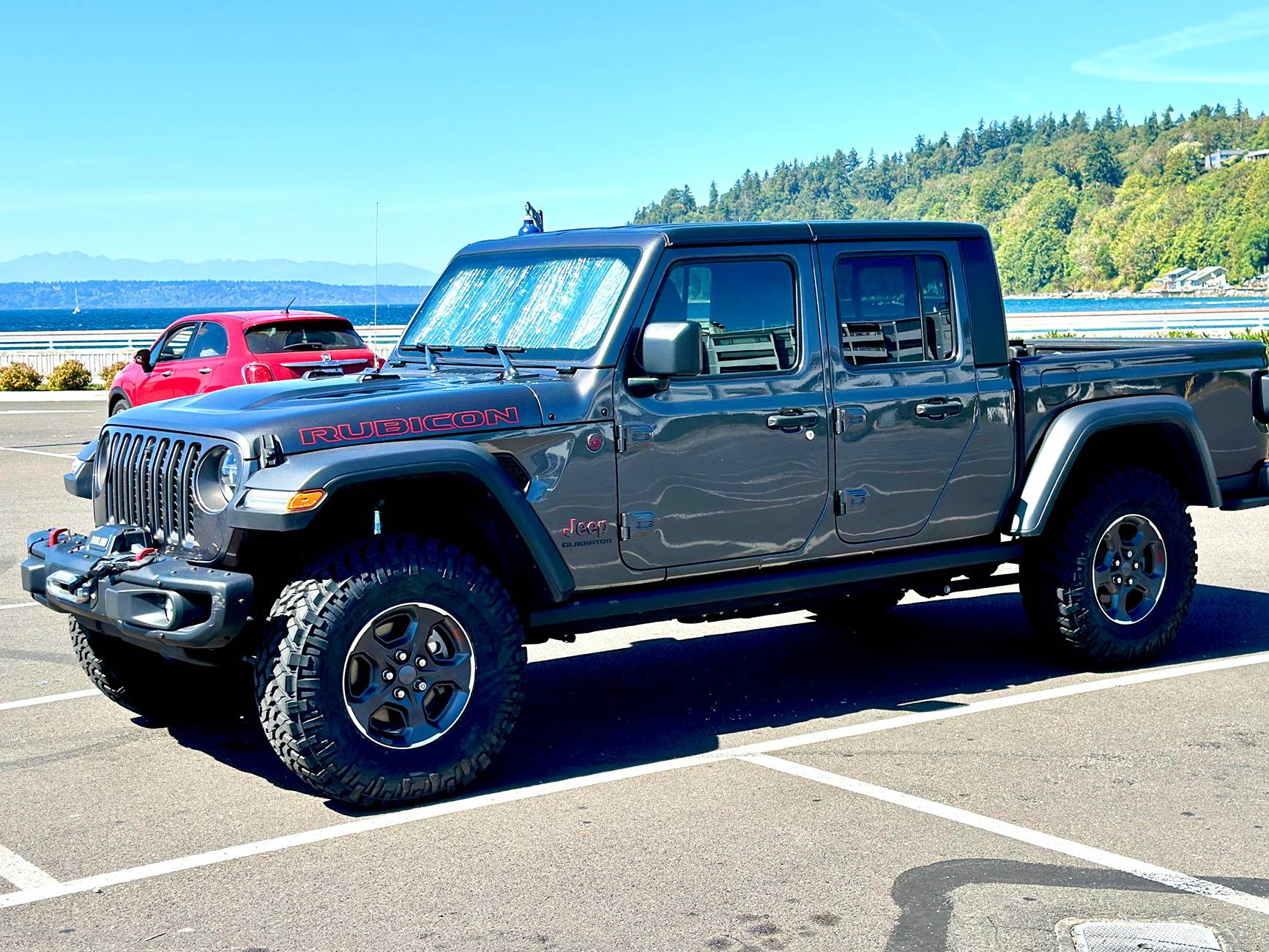

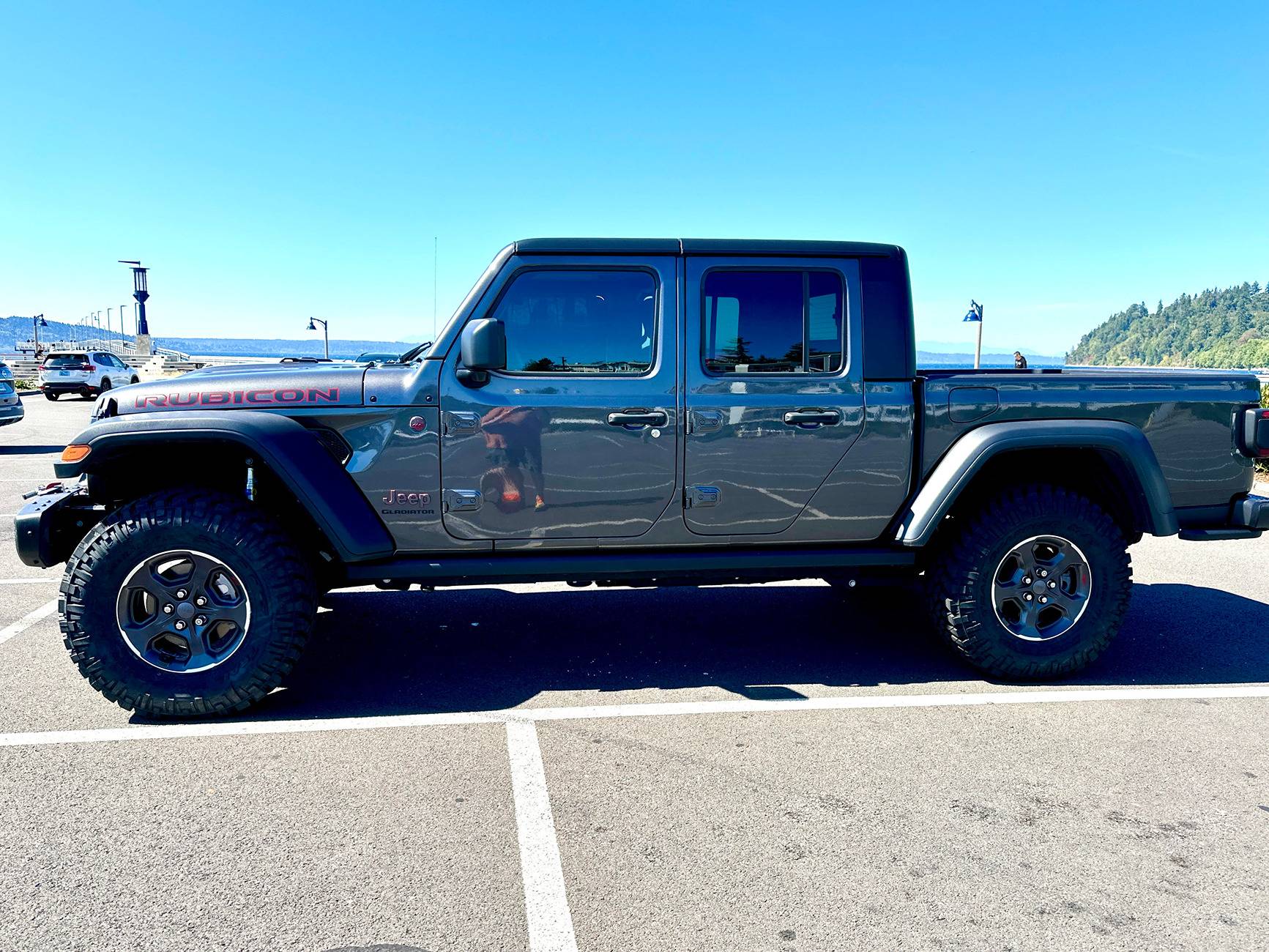

Pics of the truck (post-lift) on Nitto Trail Grappler MT 35x11.50 tires.

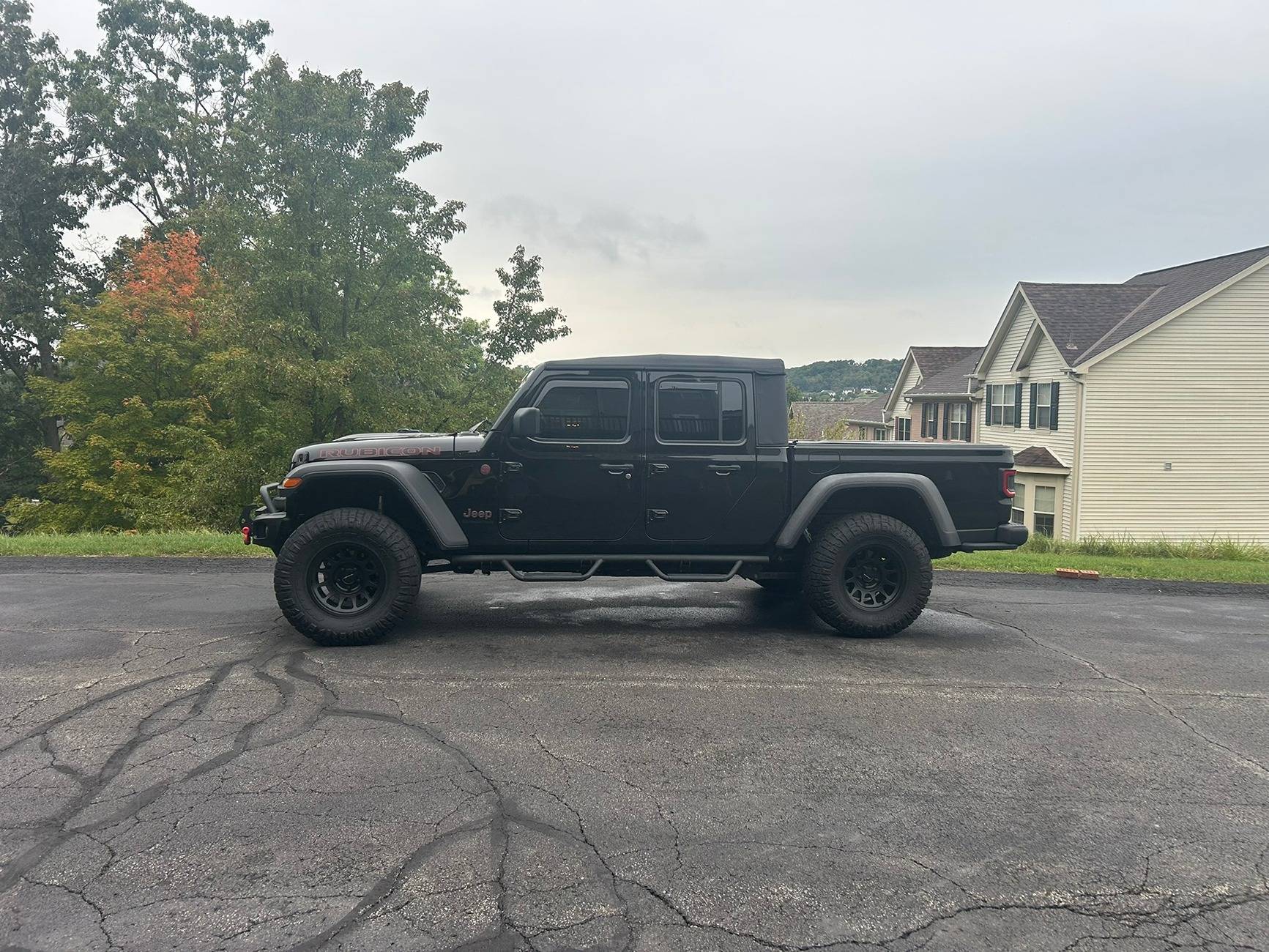

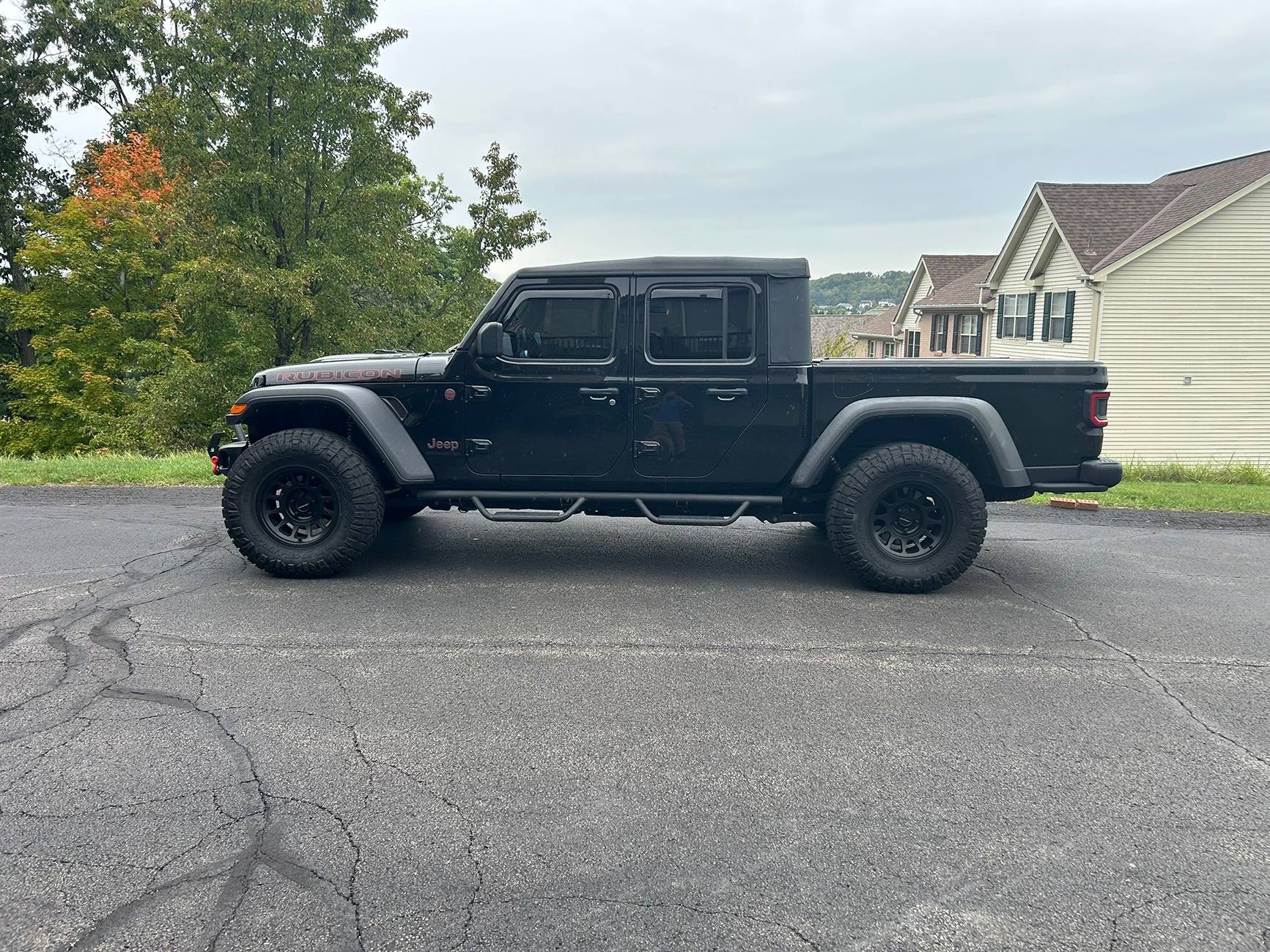

Chiming back in to this thread to say thanks for the excellent research and parts list you provided. I put on these exact components this weekend and it's made a great difference in both ride and looks of the Jeep.
For sure this also provides enough room if someone wants to put 37s on someday as well.
Total cost for me was around $750 and well worth it!
Here are the before and after of mine.
That's awesome, your truck looks much better and I'm glad you're enjoying the handling change.
On a side note, after driving mine more I'm seeing some slight porpoising which feels like the rear of the vehicle is just a bit under-valved. I think some slightly stiffer shocks in the back will help so I ordered matching Bilsteins for the rear.
I will update the first post once they are installed and I get some time on them.
