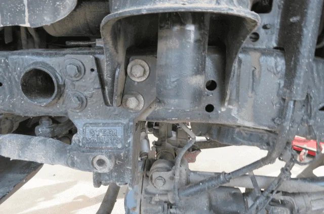

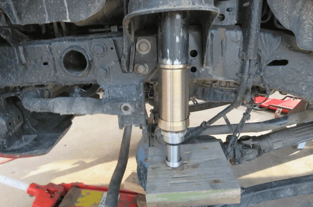

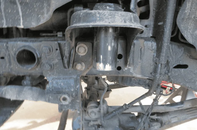

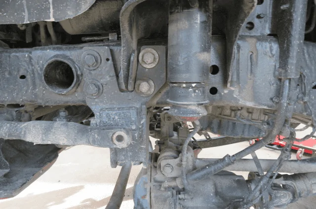

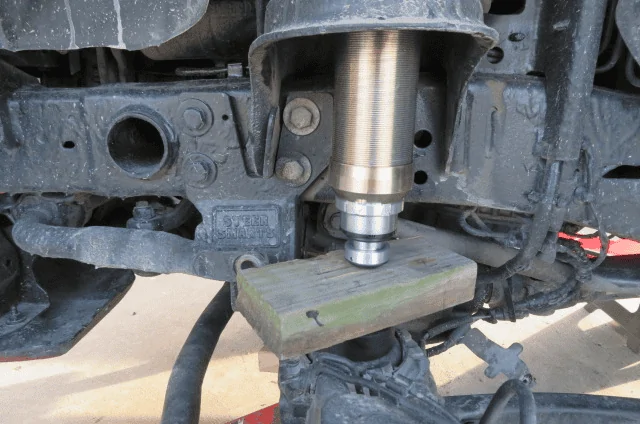

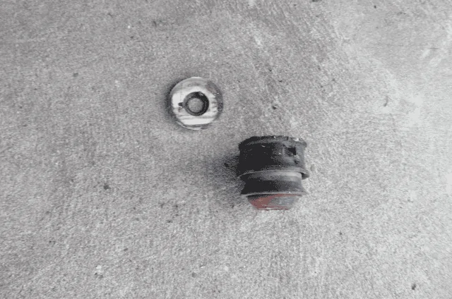

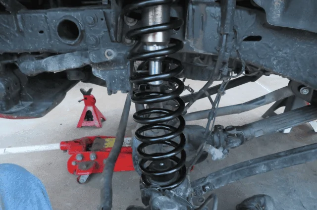

Okay cool. These raise the front end and have bump stop impact reduction?? Seems like a great solution.
You have to cut off the oem bump stops to install the kit. Page 8 of my build thread has the install.
Jeep Gladiator Diesel suspension upgrade 1712422329270-fh
Jeep Gladiator Diesel suspension upgrade 1712422349976-t8
Jeep Gladiator Diesel suspension upgrade 1712422375261-z2
Jeep Gladiator Diesel suspension upgrade 1712422400527-zz
Jeep Gladiator Diesel suspension upgrade 1712422439275-xc
Jeep Gladiator Diesel suspension upgrade 1712422466958-jn
Jeep Gladiator Diesel suspension upgrade 1712422526520-z7

Which bump stop replacements would you recommend for a 1 in spacer lift? I see teraflex has some rubber ones but they look long.
Something to keep in mind, these are bump stop compression jousts. When you cycle suspension for clearance, you want to ensure these are removed- then cycle suspension to ensure nothing touches…. Then install these. These will compress completely when hitting something hard enough.
